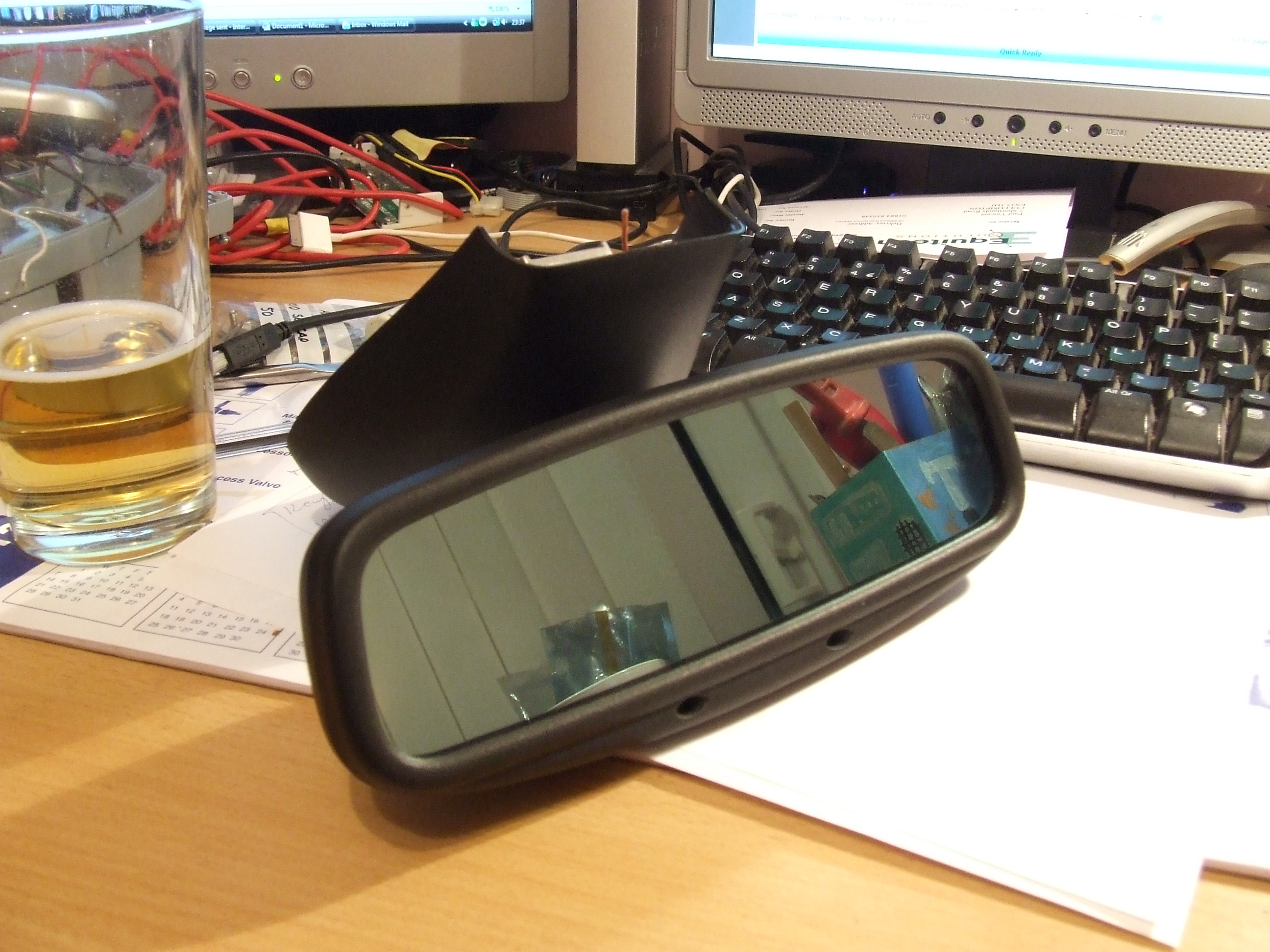

yes! This was mentioned before.... but its quite a large parcel... :/
#45
Chris Wrote:Audo dimming mirror?
well done chris we have a winner
Rep for you ........ well there would be if there was some
was a large parcel as the seller went mad with the bubble wrap

what colours are the wires coming out the mirror? iv just fitted one
#53
Mines wiered up to the map light, going to do the reverse wire too at some pint.
[Image: sig.jpg]
#54
Black is 0V, white is Switched 12V, and the grey is to the reverse lights
