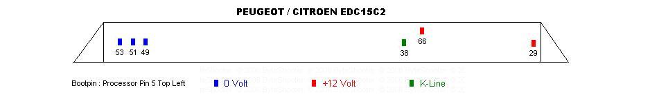

(06-03-2013, 10:21 PM)paulo953 Wrote: Yes, it's pin 63 for ECU Bosch EDC15C2 but with one plug (K-line)
ONLY ! I don't think it's available for the latest ECU provided with the 306 (2001 last models) with has 3 plugs (Can).
are you sure pin 63 as i believe K-line is 38 ?????

also is this any help for the 3 plug???

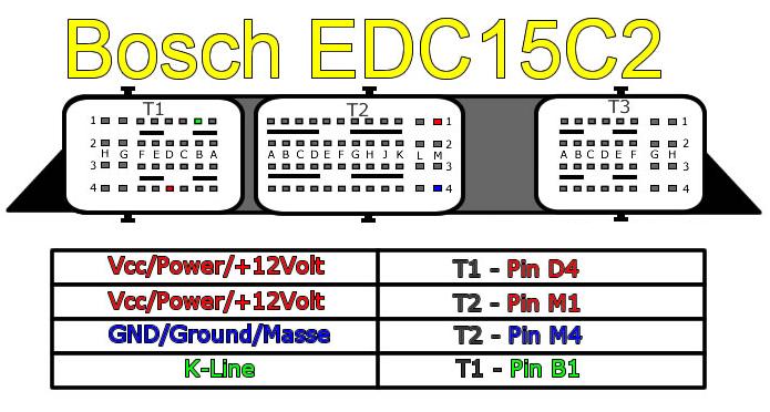

#54
Cully, do you have a list like that for the three plug ECU.
#55
(08-03-2013, 10:02 PM)DeeTurbo Wrote: Cully, do you have a list like that for the three plug ECU.
no im still hunting that one down Wink

@Cully : I'm sure yes. We have the same diagram and check line 63 it is written (trip computer). Pin 38 is for diagnostic plug to link the ECU to a computer. and to allow "discussion" between them.
Pin T1 is the same as pin 38, but for the last Bosch ECU models with 3 plugs. I call it "Can" because according to many technical documentation I found on the internet the ECU is named like that. And assuming that later cars like the 307, 406 d9 etc... where provided with multiplexed CAN and VAN networks and where using the same ECUs, I think that this ECU is ready for multiplexing.
But honestly, i don't know if the "language" between ECU and the computer with PPS is changing and I don't know how to check it....

#58
this may help Wink
http://306oc.co.uk/forum/thread-11748.html
#59
this may help Wink
Cheers, Thanks for that. Looks like I'll have to wire a TC in a different way in my girlfriends car.
