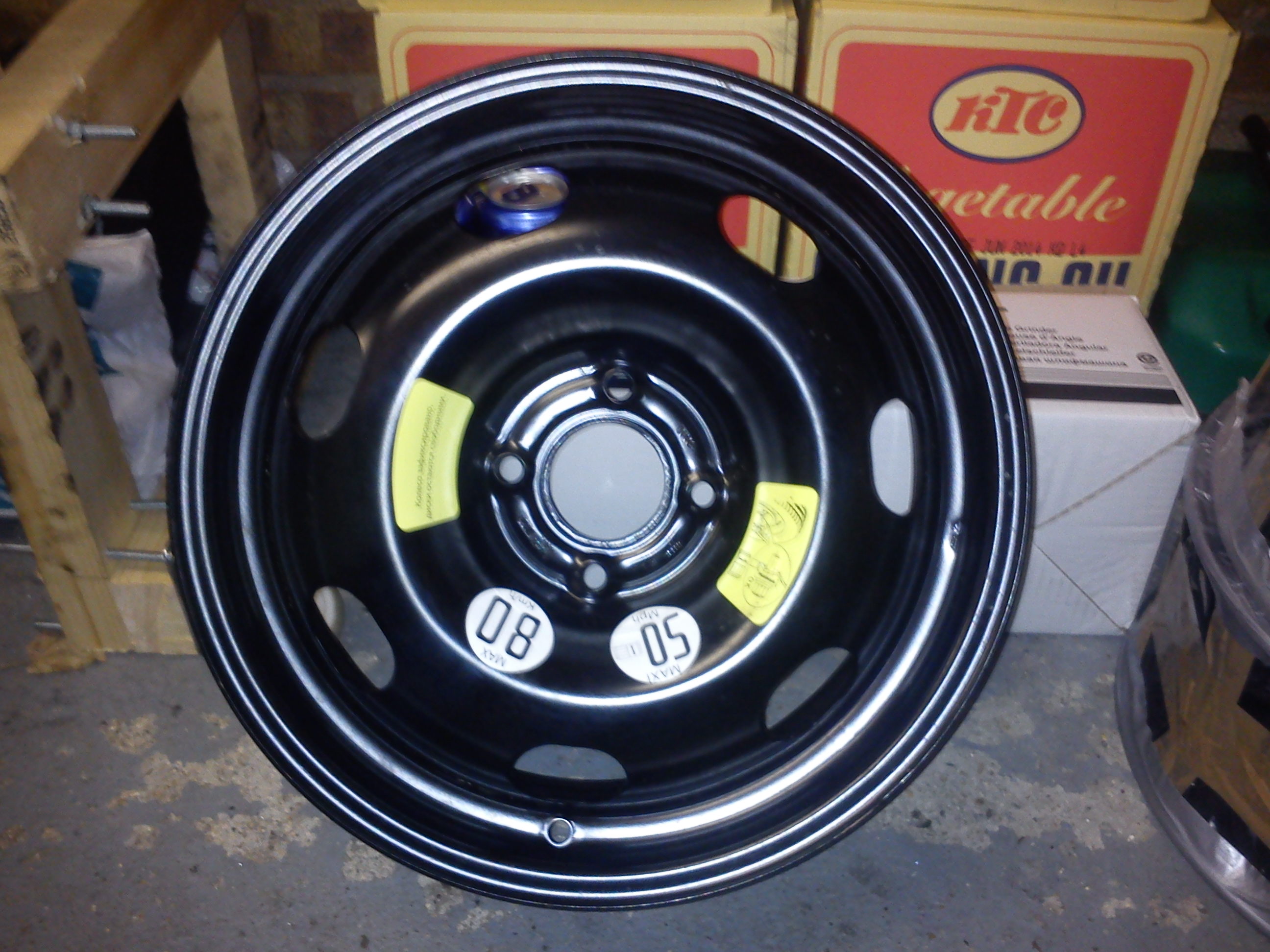

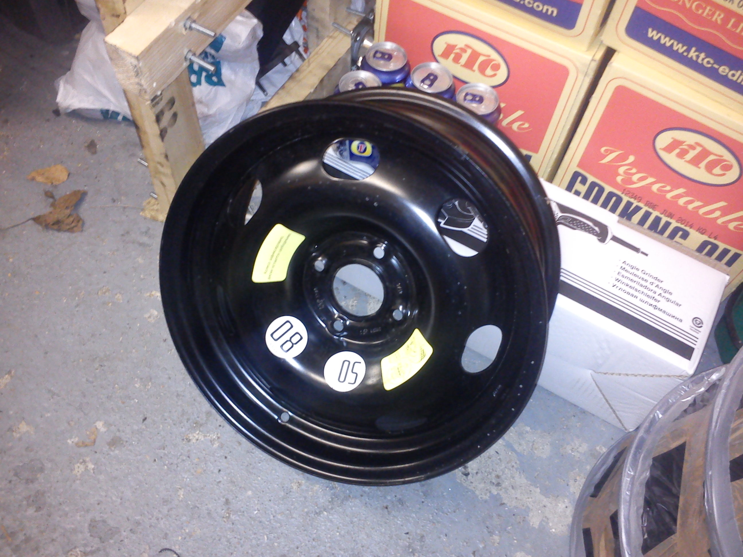

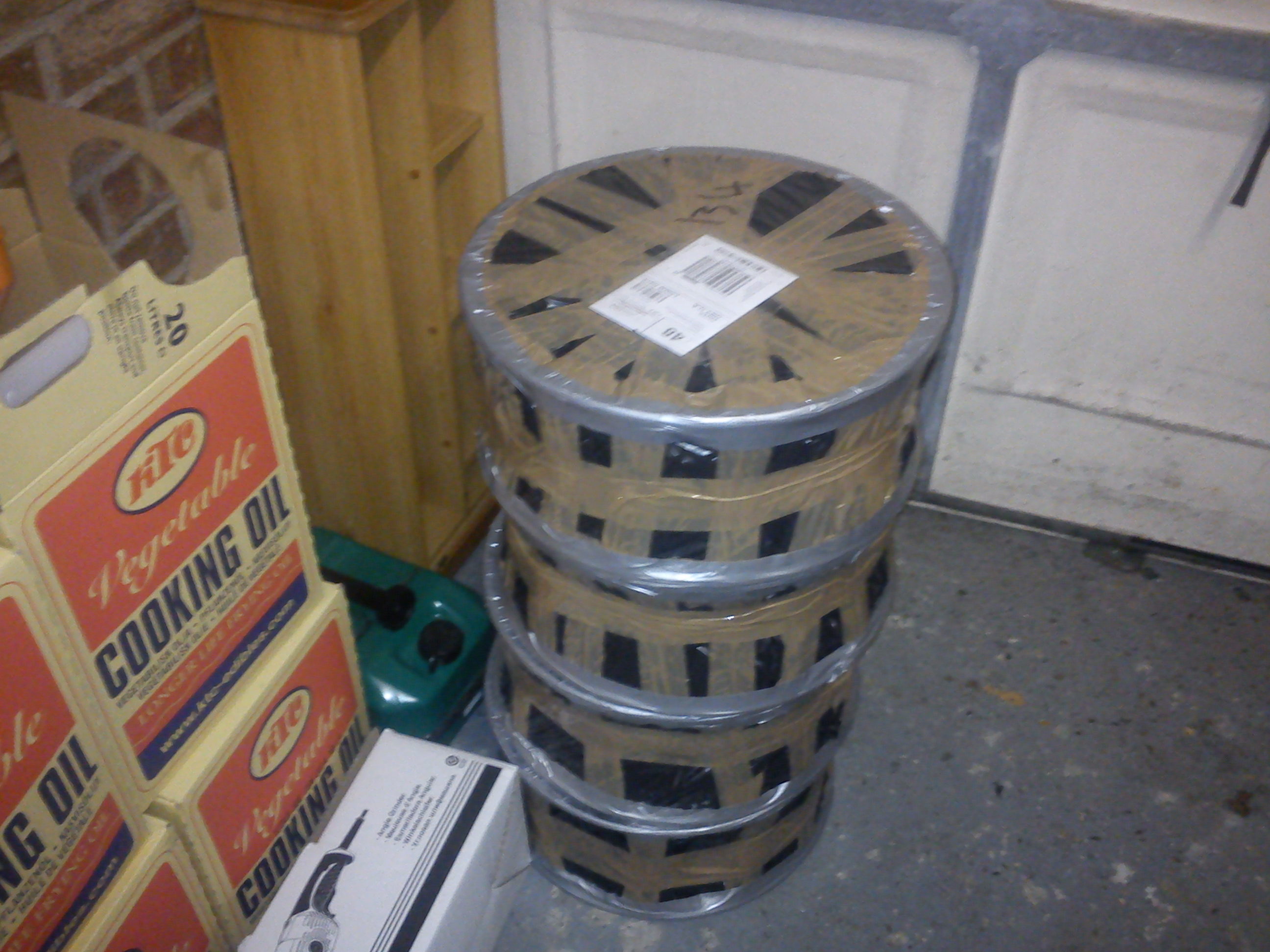

So who can guess what this is?

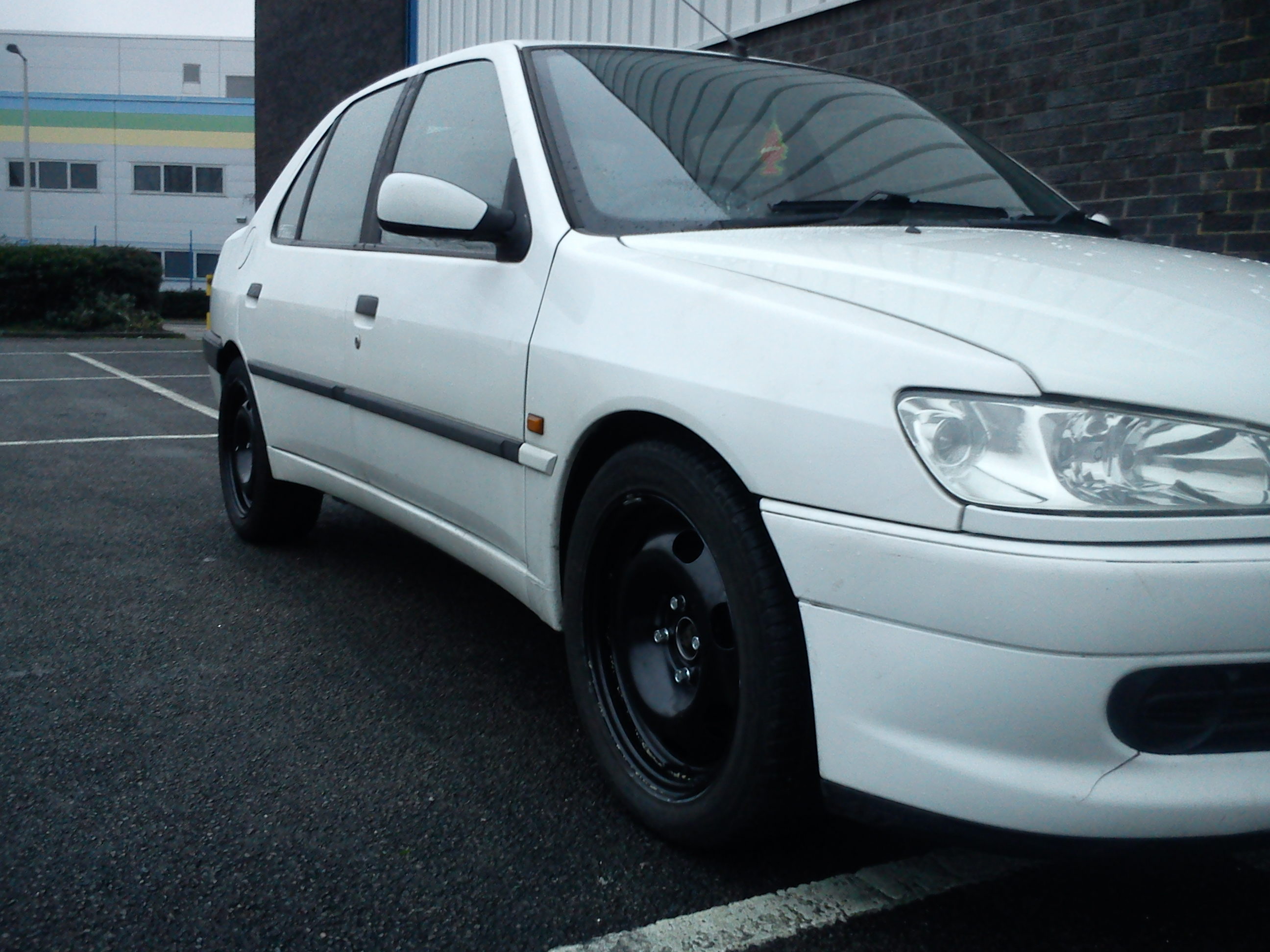

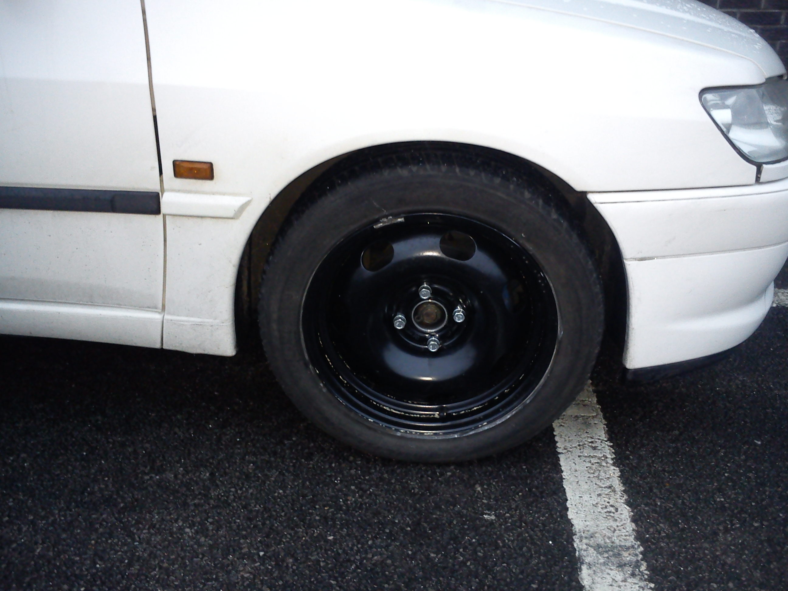

Yep a stack of 16" berlingo steels. Paid just £60 for them and theyer brand spanking new.

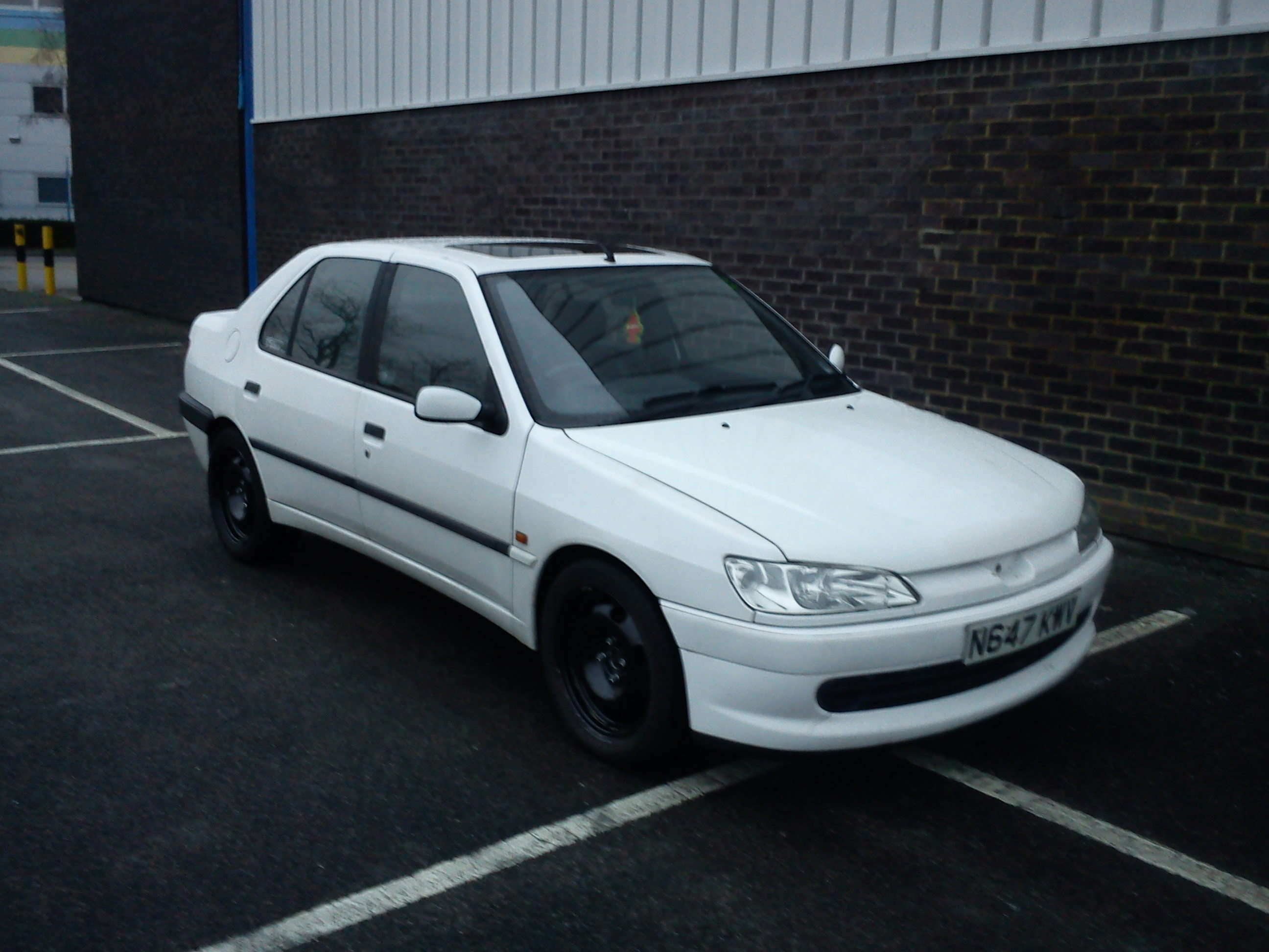

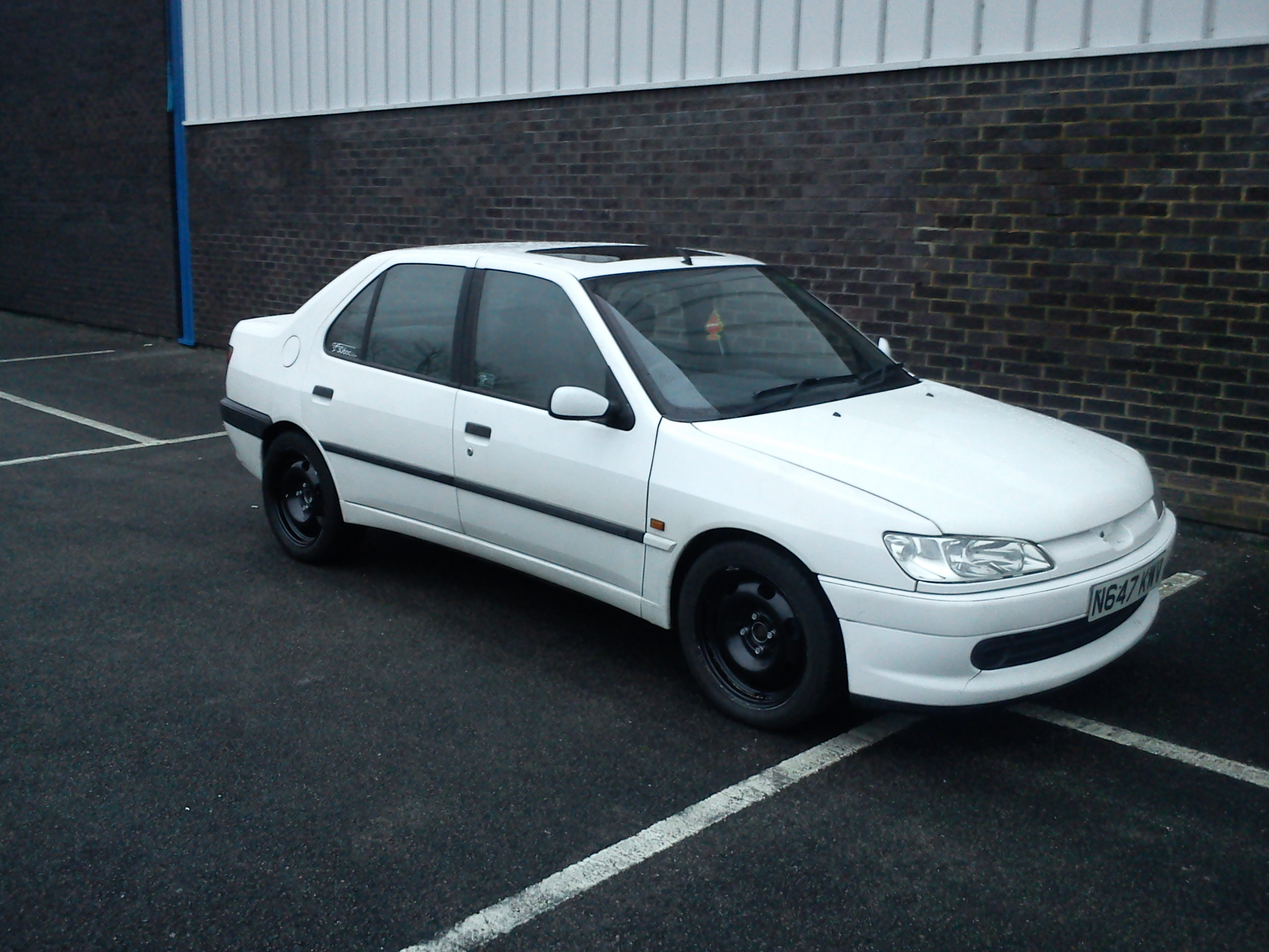

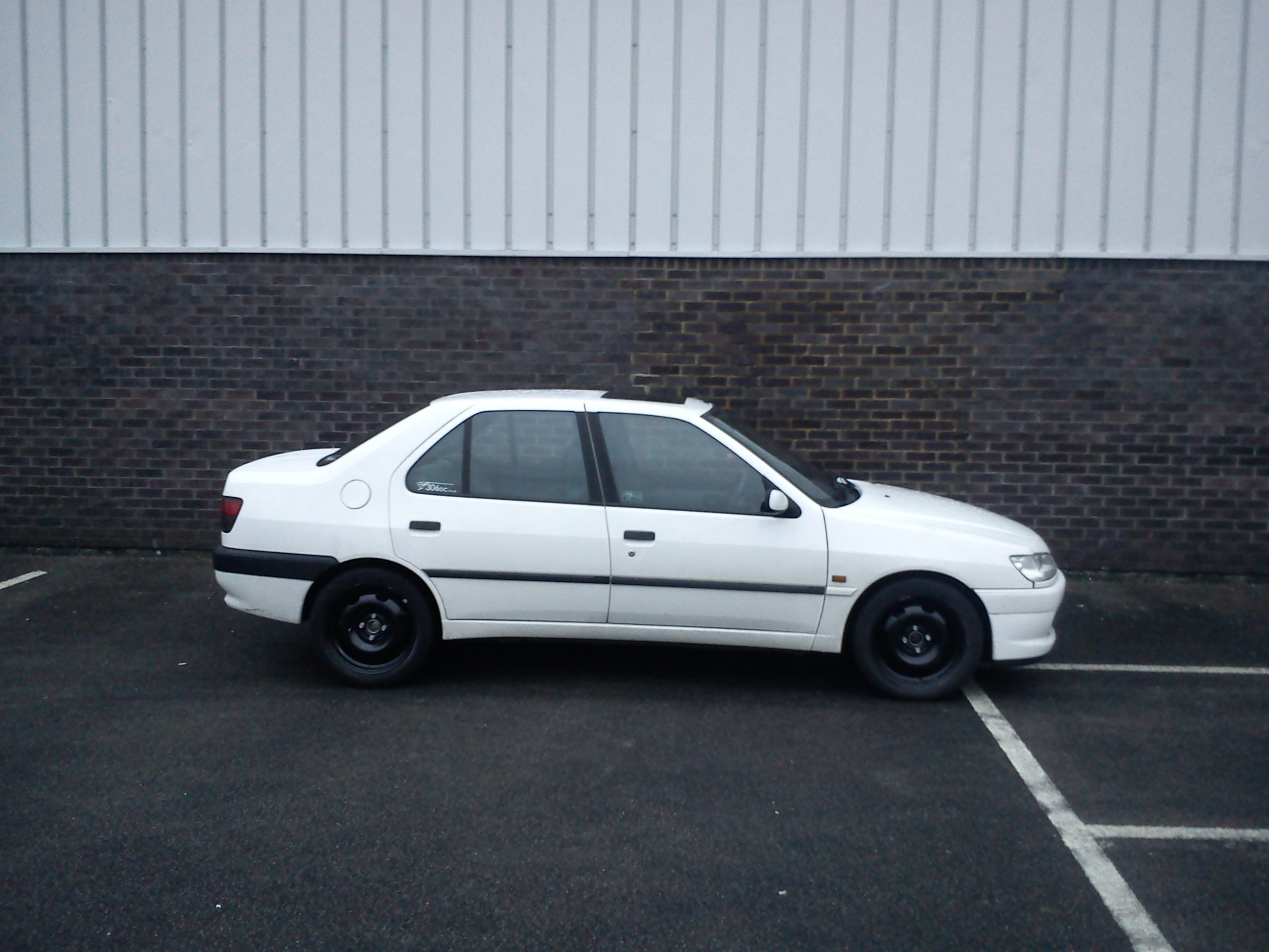

They look like this with tyres fitted and the stickers removed.
Annoyingly spacers and bolts cost me more than the wheels. Running 10mm spacers at the front and 15mm at the rear.
They would look porno in white mate!
Danny theyer staying black cos they look epic. Need some tyre shine though.
just needs low now
Are they those stupidly light alloy/steely thing?
see you took pics of its 'good side' lol
Would look really good with the front bumpers strip black and also the small bits of side strip. Also, liking the wheels. Im guessing they are either 6j or 6.5j? Any idea of the weight?
[Image: 20120704_212316.jpg]
(02-01-2013, 05:08 PM)ozonehostile Wrote: just needs low now
Yeah, need to sort the exhaust before I do that really as it hangs low in some places.
Cant wait to do it cos im really excited now Ive got the wheels on.
(02-01-2013, 05:09 PM)Midnightclub Wrote: Are they those stupidly light alloy/steely thing?
Nah, theyer heavier than the alloys that were on there.

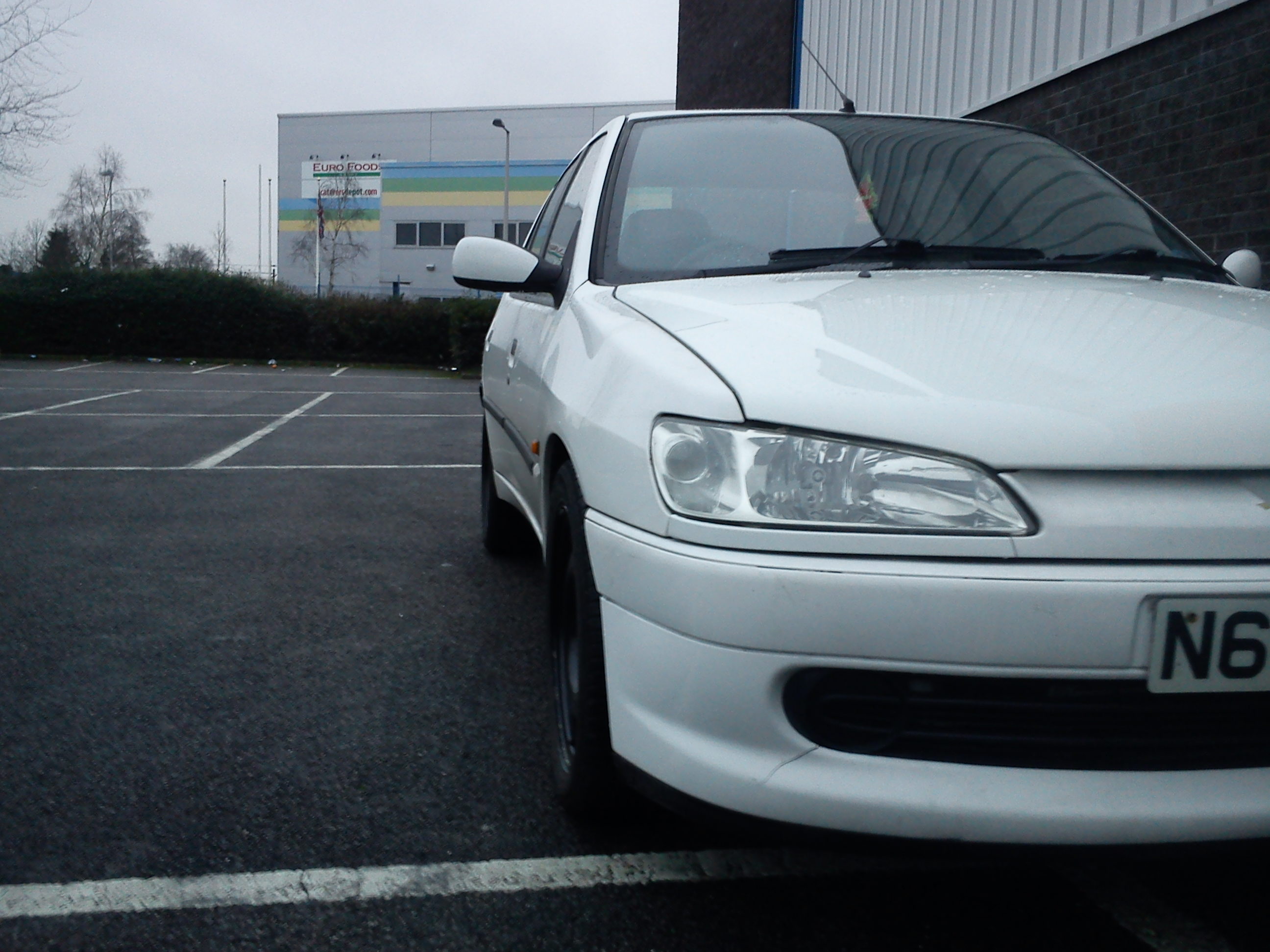

(02-01-2013, 05:12 PM)Just Sean Wrote: see you took pics of its 'good side' lol
Of course. I still haven't replaced the wing even though I have a new one sitting in the garage.
You got that at ace! Get your ass in gear!
(02-01-2013, 05:18 PM)Ben Wrote: Would look really good with the front bumpers strip black and also the small bits of side strip. Also, liking the wheels. Im guessing they are either 6j or 6.5j? Any idea of the weight?
Yeah im trying to decide weather to do the front bits black or the rest of the bits white. I really cant decide ATM.
The wheels are indeed 6.5" wide and ET26
As for weight theyer probably about 10kg each. Should of weighed them really.
(02-01-2013, 05:20 PM)Just Sean Wrote: You got that at ace! Get your ass in gear!
Mate id love to but Ive f*cked my back and theres other things that are more pressing like refitting my exhaust as currently it dosent have one.
paint the black bits white!
