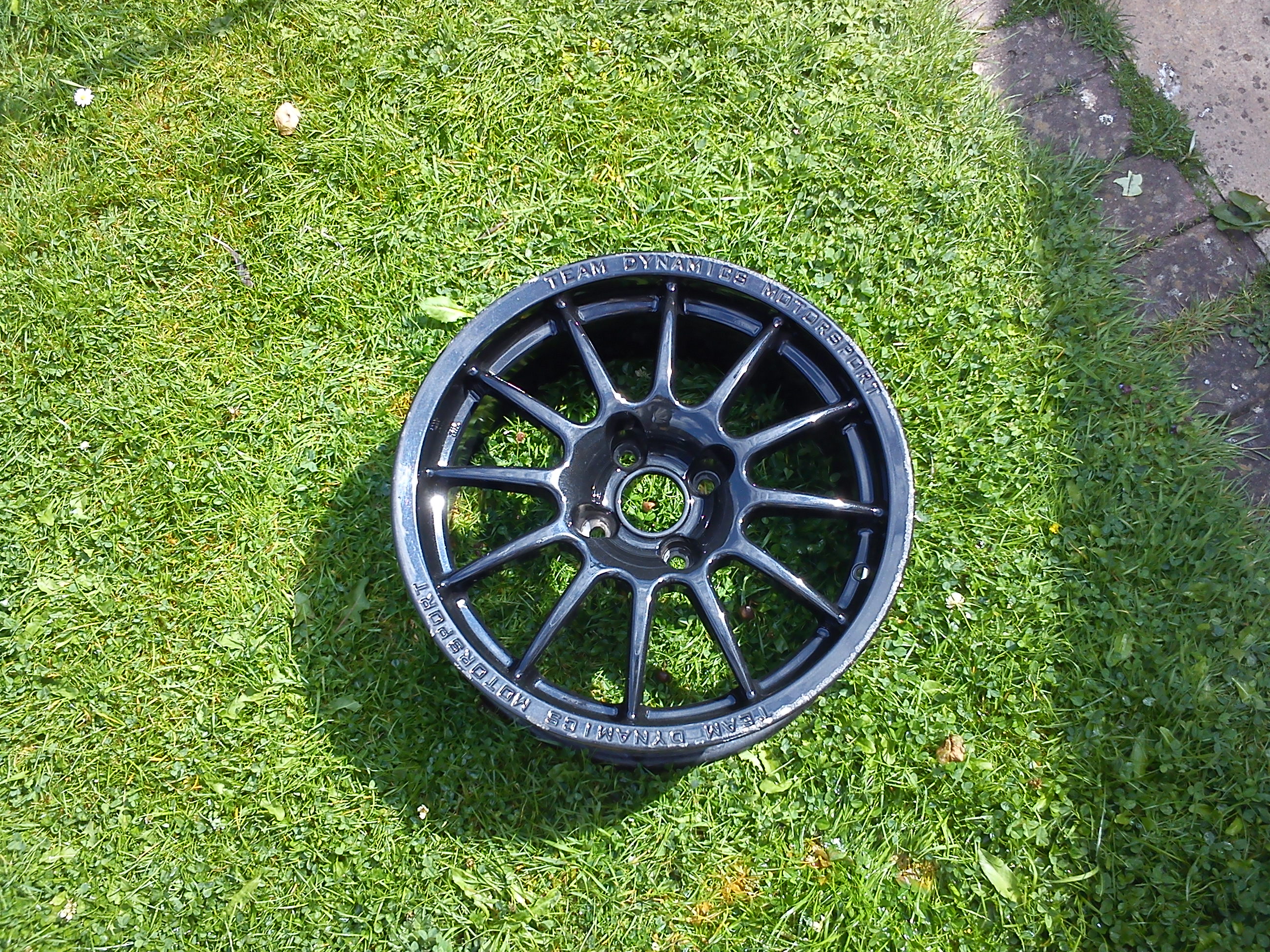

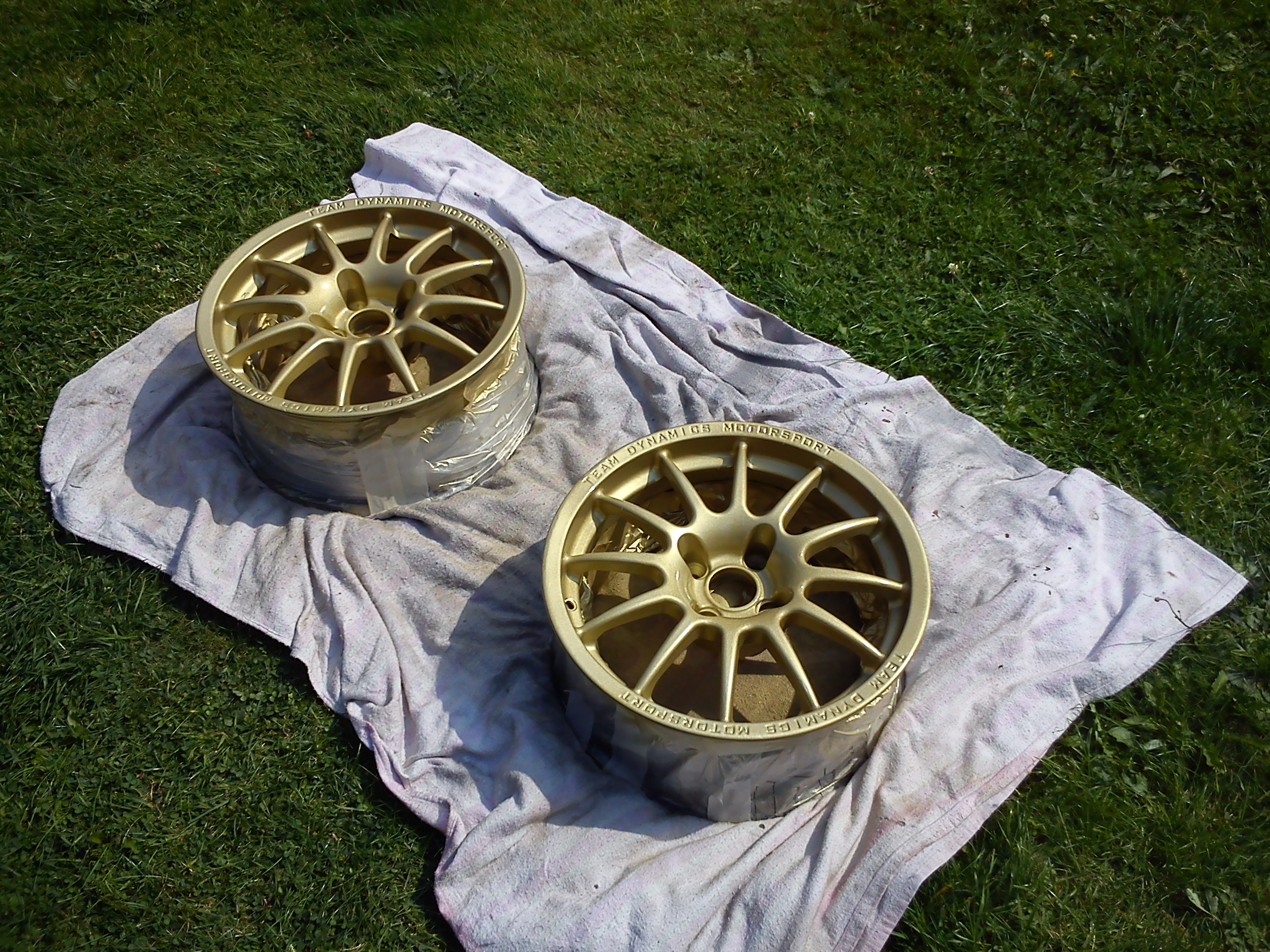

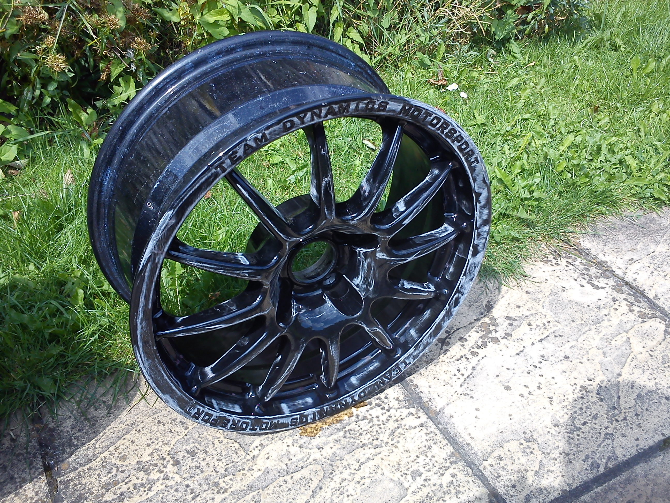

So started painting the Pro Races
Washed
Sanded
Inner barrel
Faces
Taking me about a can of hammerite to do each wheel as it needs a fair old blast to do the sides of each spoke properly.
