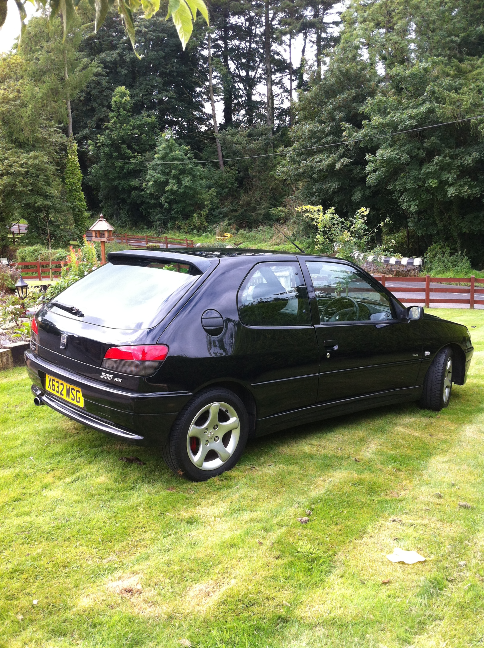

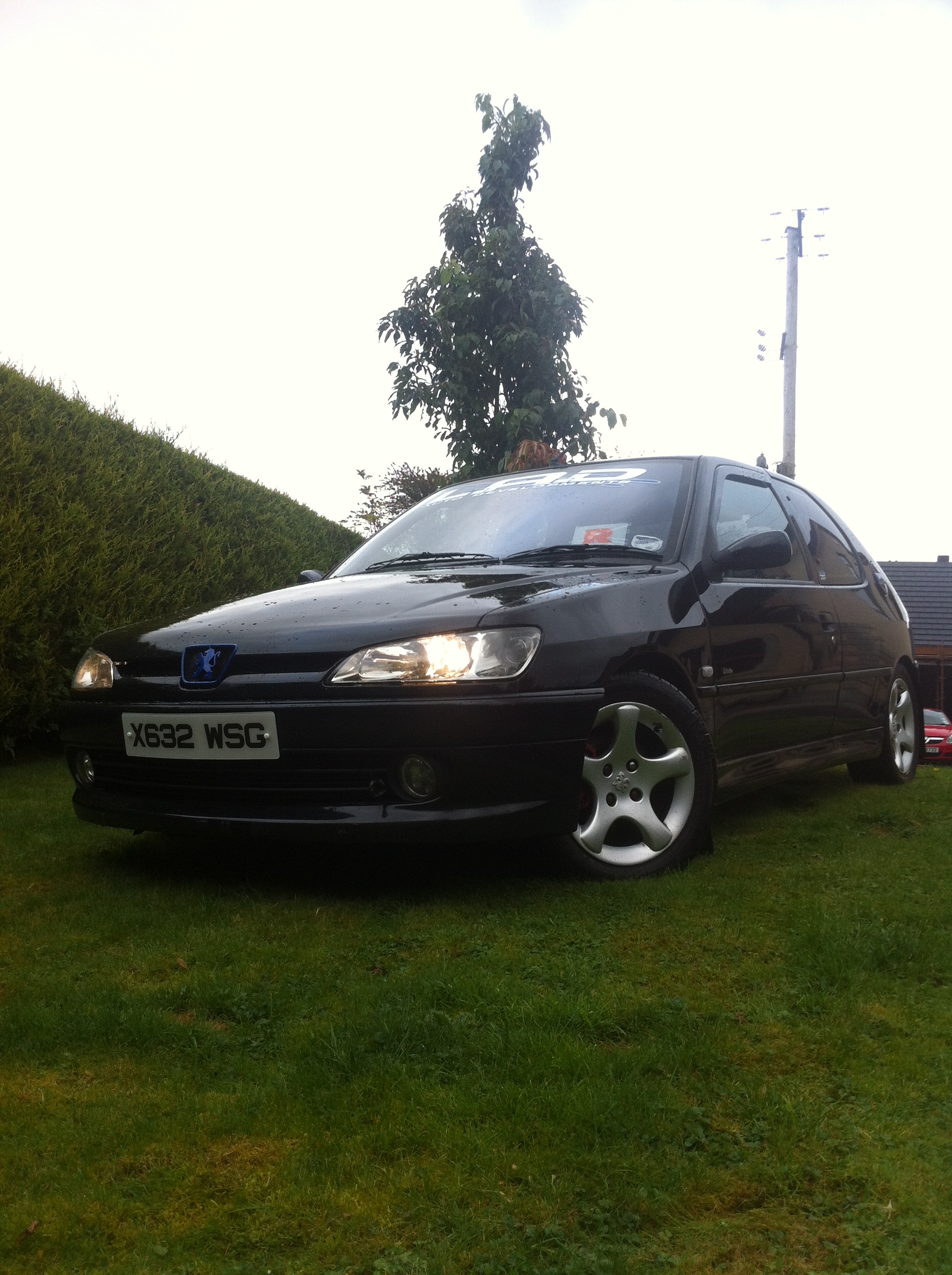

The day i brought her home from ballymena
De-wipered, De-Badged, windows tinted to 15% visability and 2.5" Decat/De-backboxed stainless steel pipe too 3" tip
Lowered on 60mm saxo springs and 2 nicks at torsion bar, xenon max lights installed
3 leg spoiler w/brake light added, eyebrows added, diesel filler cap strips wrapped blue, break calipers have since been painted blue, but this is how she sits today Smile

Those spoilers are awful, lose that along with the silly eyebrows & twatflaps and it would look alright
RE: My HDi - Poodle - 16-12-2012
Says the kid driving a vectra? GTFO. lol
Not to my taste bud, but looks like you take care of her, nice to see something different.

Just a little tip mate, you could get it that low on 306 -60mm gti springs and it would handle a hell of alot better, as the car is wayyyyy to heavy for those saxo springs,
Looks good though mate, brow's and filler cap isnt to my taste but the rest is spot on, the lows is nice and not well over done Big Grin

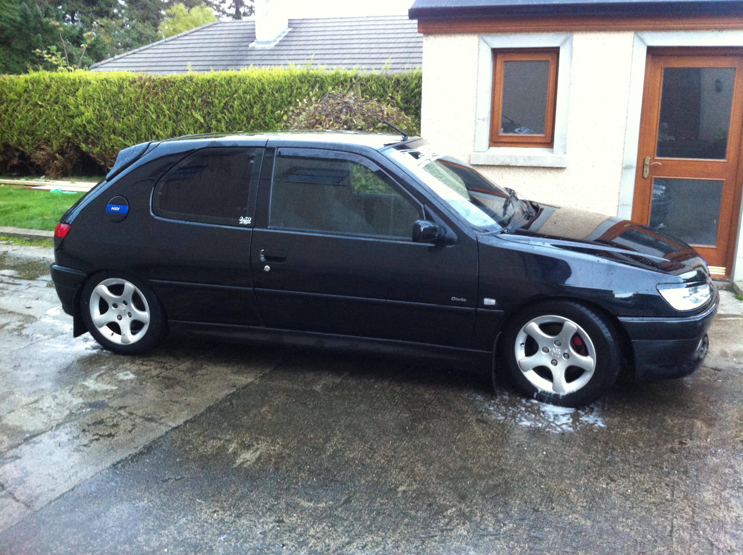

so aye, got everything ready to rock now, being left into mechanics on sunday night, should be ready in a week or 2, then saving for remap, this should be wise Big Grin

car look well adam
one thing though, are they new saxo springs? sitting while high at the front for 60 saxo's

Cheers lad, ayee 60 saxos, cant figure out why there sitting so high, at first i thought they just had to bed in but that was months ago and theres no difference now, getting my friends coilovers and going 3 nicks after the remap, so just gona leave er at this hight ty i get the money Smile

aye, its not uncomon, i bought a set of saxo's for my old miami blue car, when i sold it back to my mate he fitted them and it was about the same height as yours, nearly higher than when it was on 60 dturbo's
3 nicks is the only way, just dont cut bumpstops, mine are and its the height of 4 nicks atm with a boot full
