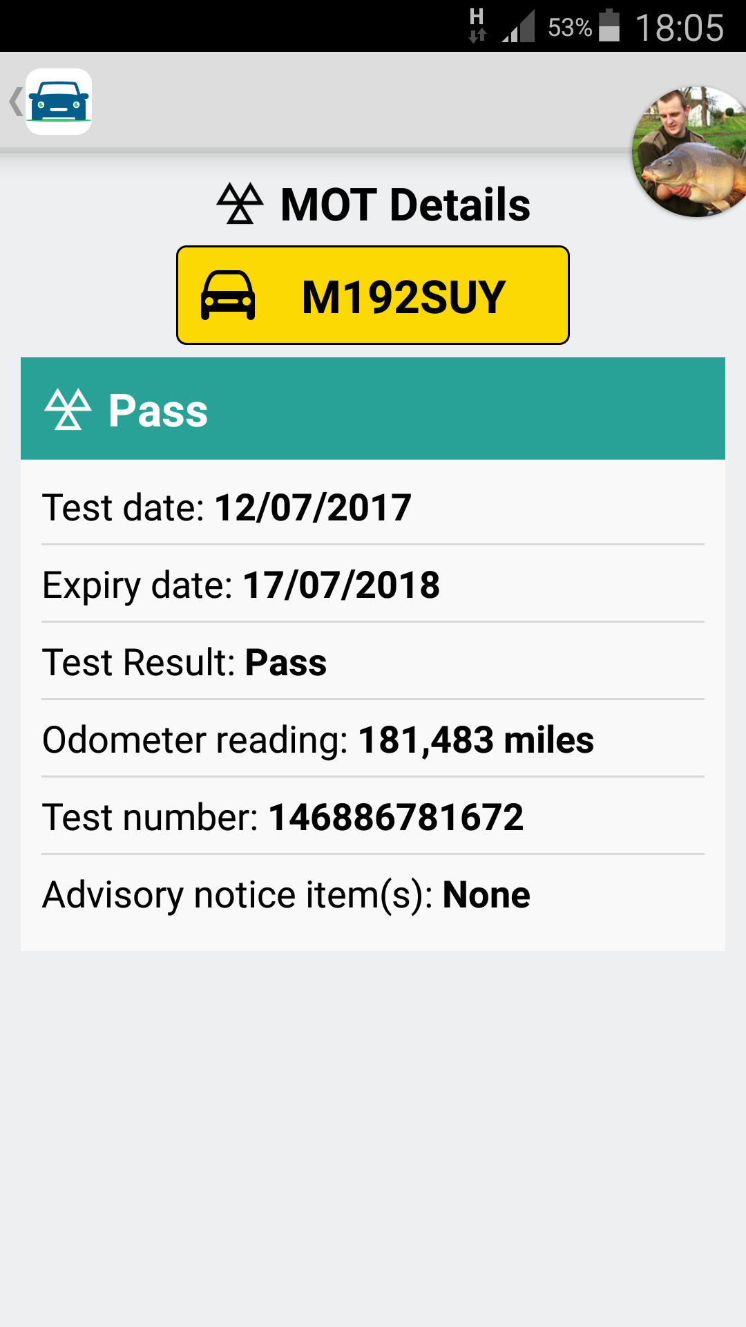

RE: Citroen zx volcane 3 door - Chris_90 - 12-07-2017
About time it I had some luck nice clean mot sheet for the zx.
RE: Citroen zx volcane 3 door - bashbarnard - 12-07-2017
winning. Cant wait to see this at fcs
