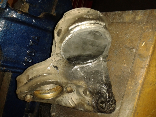

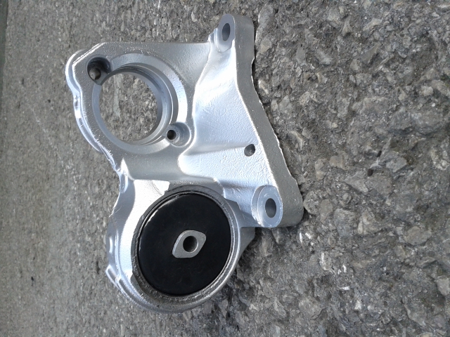

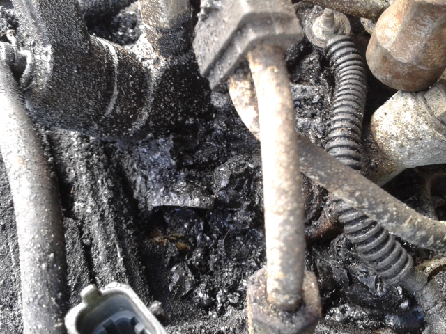

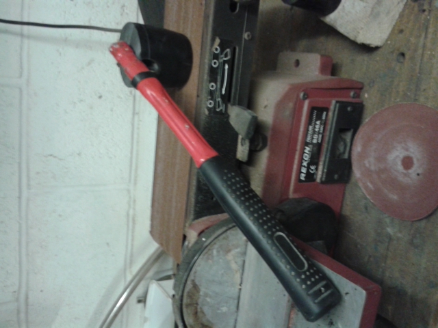

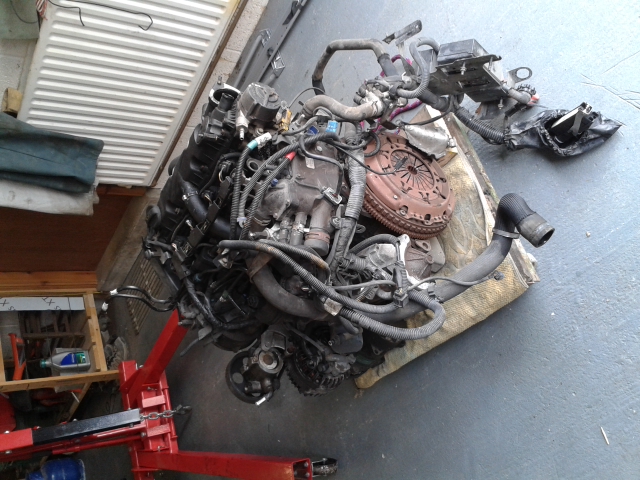

RE: Jonny's (and Vaughans) Broken GT20s HDi Estate - Jonny81191 - 28-04-2013 That'd be telling ![]() TBH it's not hard to work it out, you've got a head there in your garage, go and look at it and have a think. RE: Jonny's (and Vaughans) Broken GT20s HDi Estate - Jonny81191 - 29-04-2013 Bit of progress tonight, I've cleaned up the new engine and started making a stiffer bottom engine mount. This is what a leaking injector does over a long time. And the "solid" bottom mount. Don't know why my phone does that to the pictures. They were the right way up when I took them.. RE: Jonny's (and Vaughans) Broken GT20s HDi Estate - Ruan - 30-04-2013 The Rattle-your-teeth-out-o-matic 5000 being fitted to the lower engine mount, I see.. RE: Jonny's (and Vaughans) Broken GT20s HDi Estate - Jenkosowls - 30-04-2013 Just keep an eye on your gearbox bolts it's a solid mount that ultimately killed my car twice! I do however have my billet item for sale if you want a proper one lol! RE: Jonny's (and Vaughans) Broken GT20s HDi Estate - Grant - 30-04-2013 What did you use to put in the lower engine mount Jonny? RE: Jonny's (and Vaughans) Broken GT20s HDi Estate - cwspellowe - 30-04-2013 A rubber mallet it seems
RE: Jonny's (and Vaughans) Broken GT20s HDi Estate - Grant - 30-04-2013 Oh I see lol It looked like dirty metal. My bad RE: Jonny's (and Vaughans) Broken GT20s HDi Estate - Jonny81191 - 30-04-2013 Yeah yeah I'm a pikey. But tbh it's solid rubber pressed into the mount. Same as any other uprated one I've finished it now, looks good ![]() Jonny's (and Vaughans) Broken GT20s HDi Estate - Parksy87 - 01-05-2013 Good to see you're getting this sorted, on the bright side at least it went after you went on the ring take me a week to get round in smokey
RE: Jonny's (and Vaughans) Broken GT20s HDi Estate - Poodle - 01-05-2013 Will have to let me know how it is with the solid mount, if its bearable as a daily I think i'll do the ame. Fed up of killing engine mounts left, right and centre lol. RE: Jonny's (and Vaughans) Broken GT20s HDi Estate - Ruan - 01-05-2013 Lol, my GTi6 lower mount that I thought, ooh look DECENT lower mount, bonus! That'll be good for another 30k or so... Nope, f*cked already after about 10k! RE: Jonny's (and Vaughans) Broken GT20s HDi Estate - Jonny81191 - 01-05-2013 (01-05-2013, 08:31 AM)Poodle Wrote: Will have to let me know how it is with the solid mount, if its bearable as a daily I think i'll do the ame. Fed up of killing engine mounts left, right and centre lol. I've got half a mallet here if you want it? RE: Jonny's (and Vaughans) Broken GT20s HDi Estate - Poodle - 01-05-2013 Hahaha didnt realise you'd actually made it from the mallet, yeah go on then! Send it down with Chris and ill have it off him at ppcitp.

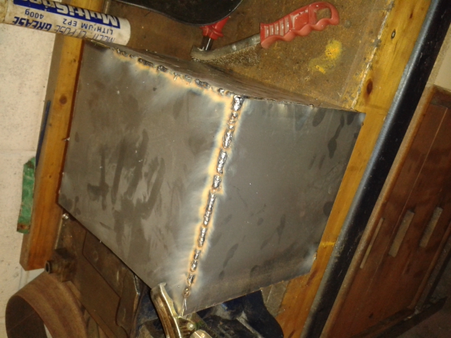

RE: Jonny's (and Vaughans) Broken GT20s HDi Estate - Jonny81191 - 01-05-2013 Ok mate, will do! I should be there anyway. In other news, I've got my aux belt fitted, hopefully going to make my new battery box tonight. RE: Jonny's (and Vaughans) Broken GT20s HDi Estate - rd070707 - 01-05-2013 I like the idea of a solid lower mount as mine is franced! what would be the best quality non solid replacement? RE: Jonny's (and Vaughans) Broken GT20s HDi Estate - Jonny81191 - 01-05-2013 Made a good start on my battery box, gonna borrow an auto darkening mask so I can see to finish it tomorrow. RE: Jonny's (and Vaughans) Broken GT20s HDi Estate - Poodle - 02-05-2013 Where are you mounting the battery? Got the eps sorted I see, good work! Will have to blag a drive - see what it feels like - if I may?

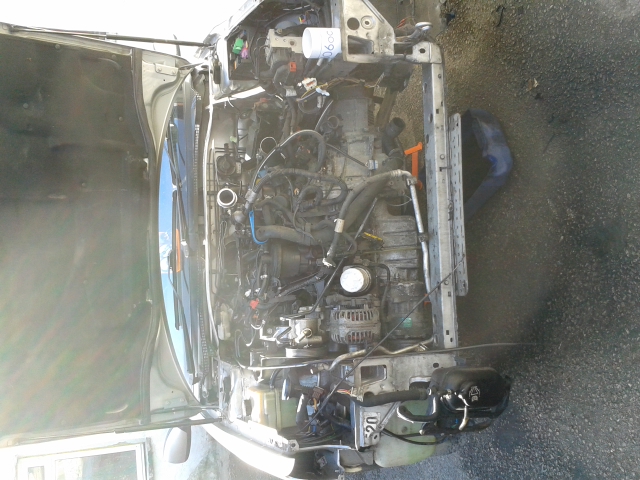

RE: Jonny's (and Vaughans) Broken GT20s HDi Estate - Jonny81191 - 06-05-2013 Finished and she starts!! Jonny's (and Vaughans) Broken GT20s HDi Estate - vlj - 06-05-2013 Hero! Ppc?? RE: Jonny's (and Vaughans) Broken GT20s HDi Estate - cwspellowe - 06-05-2013 Yay! And no thanks to my distraction
