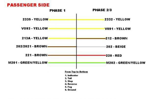

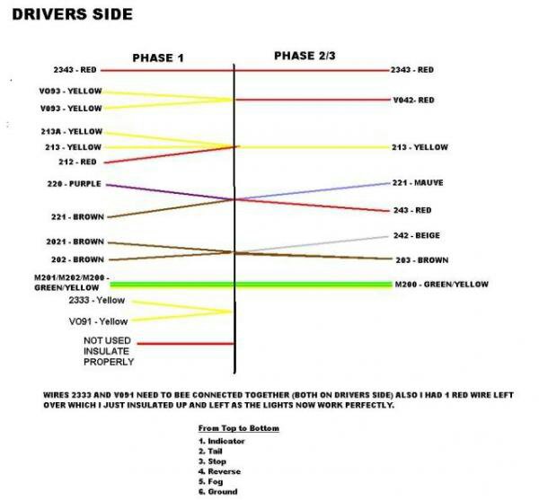

I belive the 7 pin plug is the tow bar electrics but I may be wrong
id say it would be the tow bar electrics. if you need to wire one up heres a diagram that should help wire them into the rear lights.
thats the diagram for ph1-ph2 rear light conversion but should tell you what colour each wire is.
Attached Files Thumbnail(s)
Brilliant - thank you for the very useful wiring diagram! Smile
no problemSmile
Will Scotchlok connectors be required for this?
you will probably need something like this wired into the rear lights and yes scotch locks will do
the board will probably have a plug on the end of the wire you will need to wire a socket into the cars rear lights
