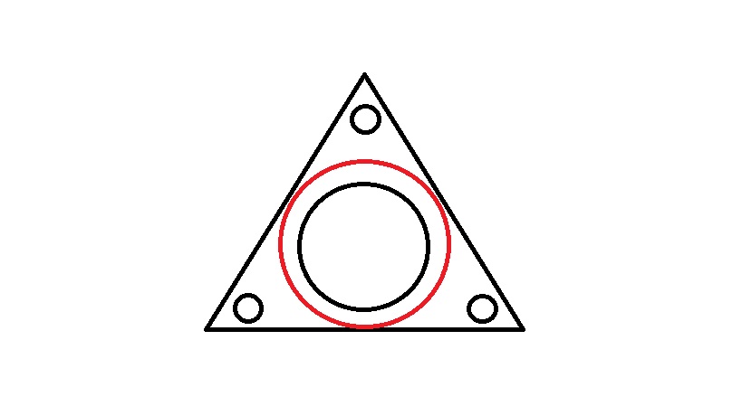

Do it like this fella.
Black lines are the flange, red line would be the exhaust elbow welded onto it. Should still leave enough material to seal properly.
Check JJC Race and Rally for elbows. I got mine from there, it's not a mandrel bend, it's two plates welded together for a tight radius. I've loads of space to the linkages and gear selector.

Ooh actually.. why not get a pre-fabbed elbow in 2.5" and just bash the sides to allow clearance for the nuts?
(03-01-2013, 07:31 PM)cwspellowe Wrote: Well if you hadn't bought a blower with such a stupid outlet you wouldn't be having this trouble.
You're an idiot.
/sore comment because i've still got no blower
Wastegates are so last year TMI (even though I may fail at VNT control)
lmao that method did actually cross my mind. Too red reck maybe?
Maybe I could make a 3" plate to bolt onto the turbo, tap some threads, then bolt on 2.5 bend with another plate? Would be fiddly but could work.
Stage 2 XUD Sedan
Would be fiddly but would be best option for clearance I think. So yeah, bolt a plate on for the studs, then another plate rotated 60degrees with more studs/nuts with the elbow welded to that. Should be a piece of cake too.
