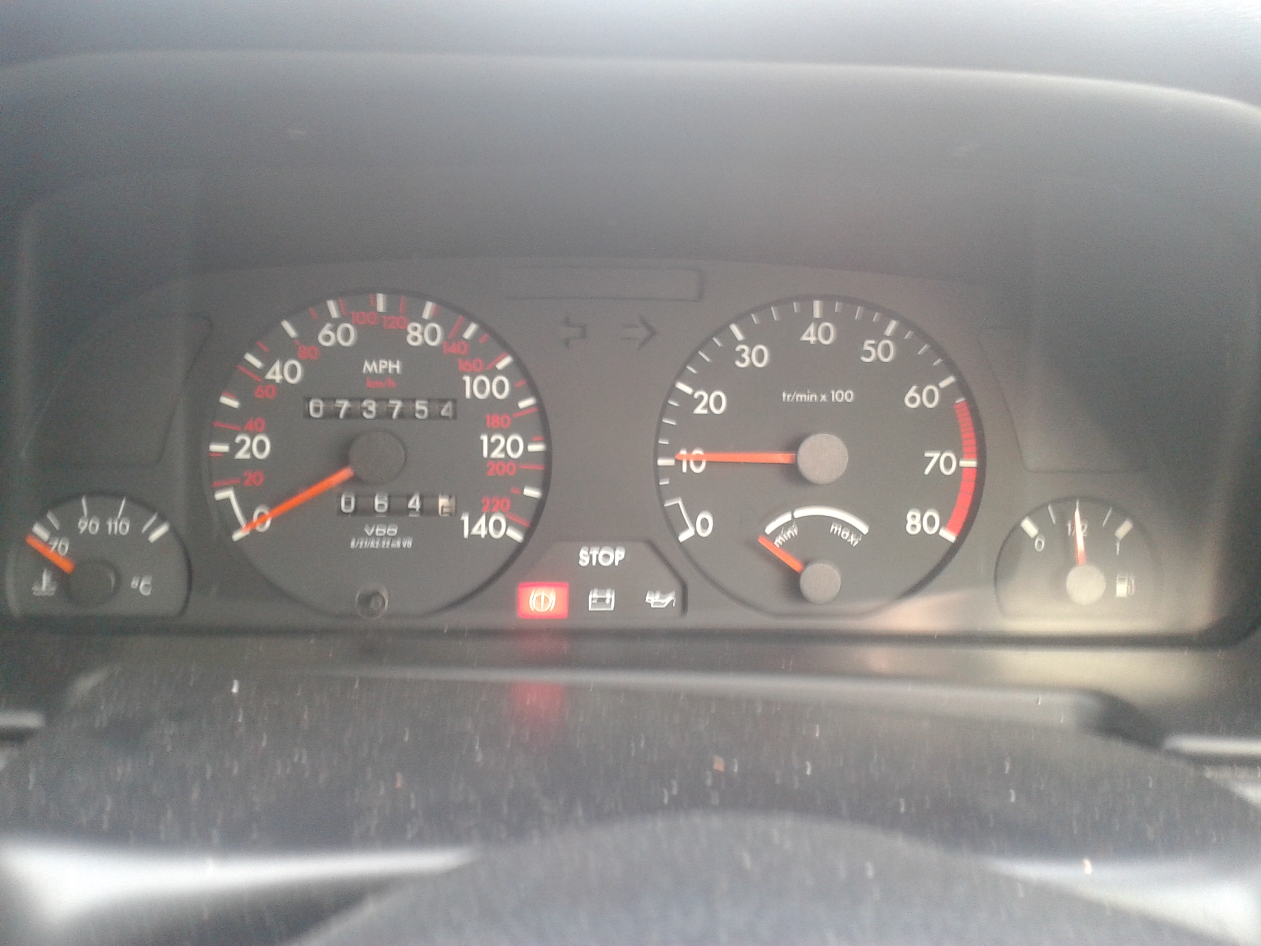

a quick pic of my dash. it lights up when i turn the side lights on but the only actual light is the handbrake. iv got no others. sometimes it tells me that the high beam is on but only when it feels like it :dodgy:
wait so the only light to come on when you turn your side lights on is your handbrake light?
Sounds like a definite earth fault with your clocks! Unless some 'tard has fitted bloody cheap LEDs in the others. Take the clocks out and have a look.
And also the door loom is the likely culprit for the CL and windows as above.
Will be the weekend before i get a chance to have a look
Hopefully it will be simple lol
By the go faster pedal theres an earth, make sure you clean that up, Deffo sounding like earth related issue Smile
