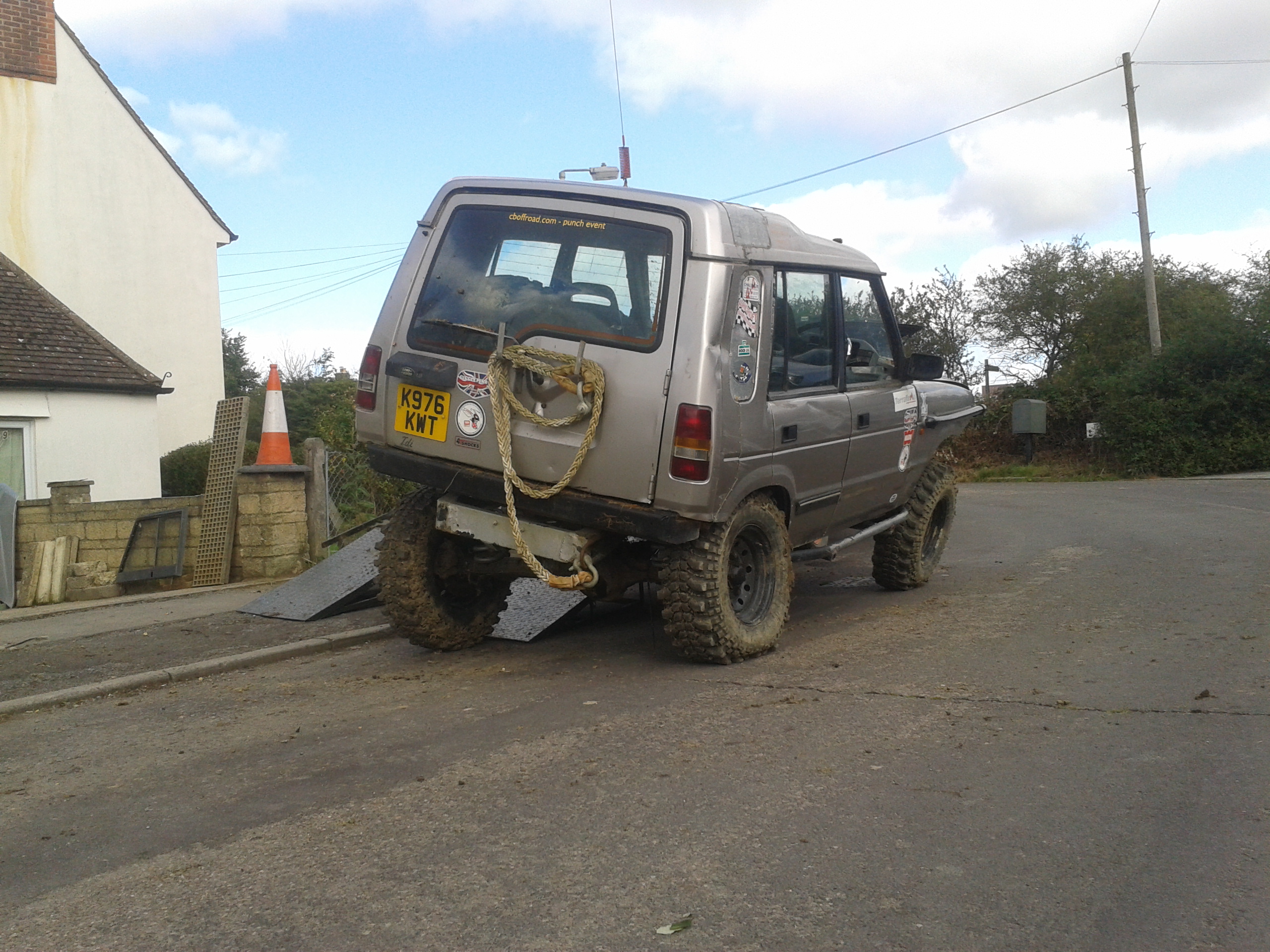

In basic terms. Its the mounts that do the steering. The whole beam turns. Basicaly under a hard corner your whell base will be SHORTER on the INSIDE and the wheel base will be longer on the out side due to the whole beam turning.
This pic of my disco shows what the gti beam is doing (all be it alot more extream)
Not that the rear wheel is pointing in even no its a soild beam the whole thing is turning
Also to add on solid mounts . They are fecking epic when everything els is uprated and your really pushing the car
