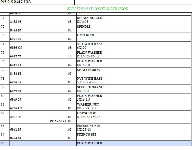

I don't know if these will be of any help in working out what's going on but I'm posting them anyway. For starters I guess the hydraulics need to be properly charged & bled for the roof to work properly. I wonder whether the pump or rams also has sensors/switches built in to sense when they're fully extended or retracted?
