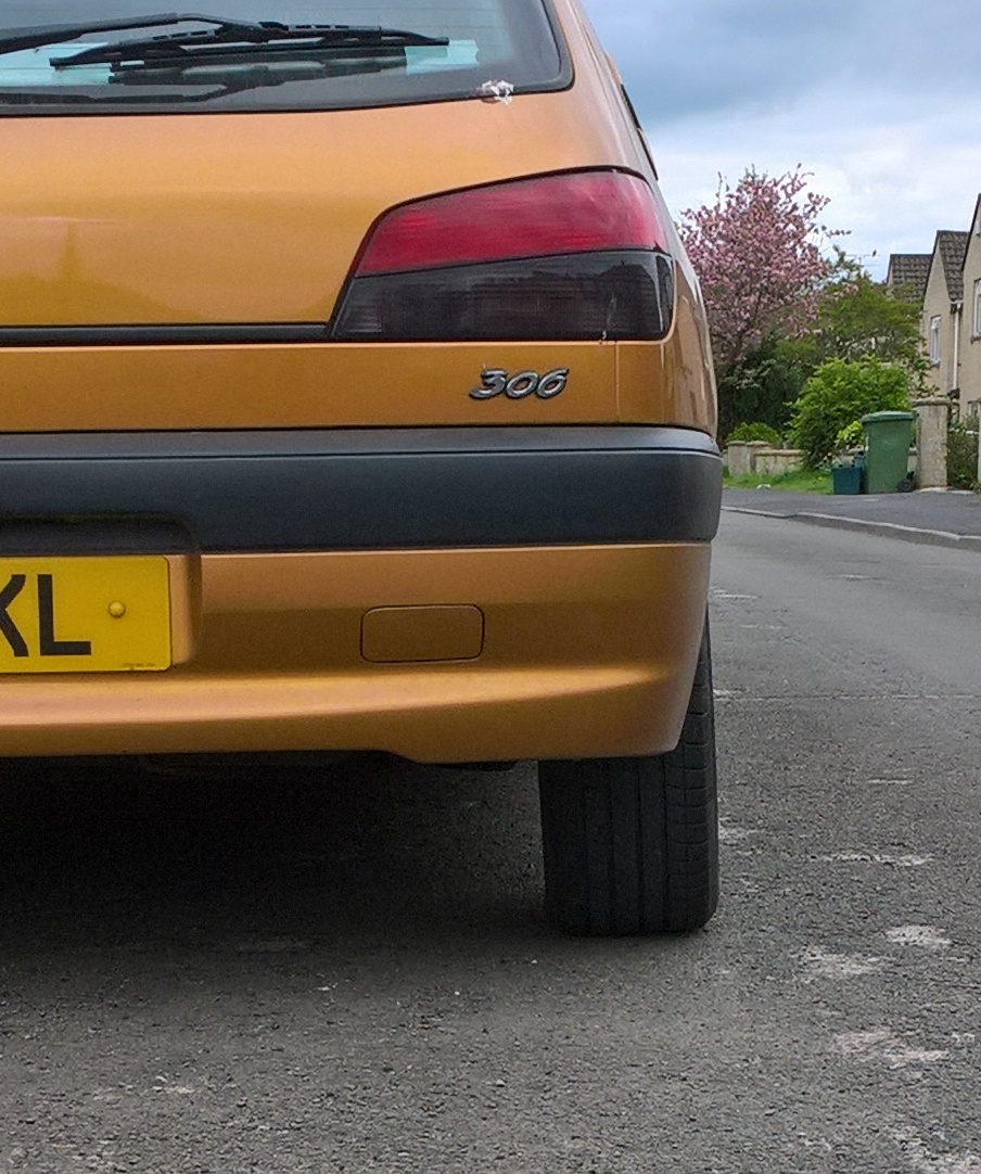

The camber looks no where near as bad as in that photo! I haven't really noticed any at all to be honest. I haven't heard any knocking or rubbing either.
I'll jack it up and give it a good wobble then and I'll go from there. Do all 306s have the same rear beam?
