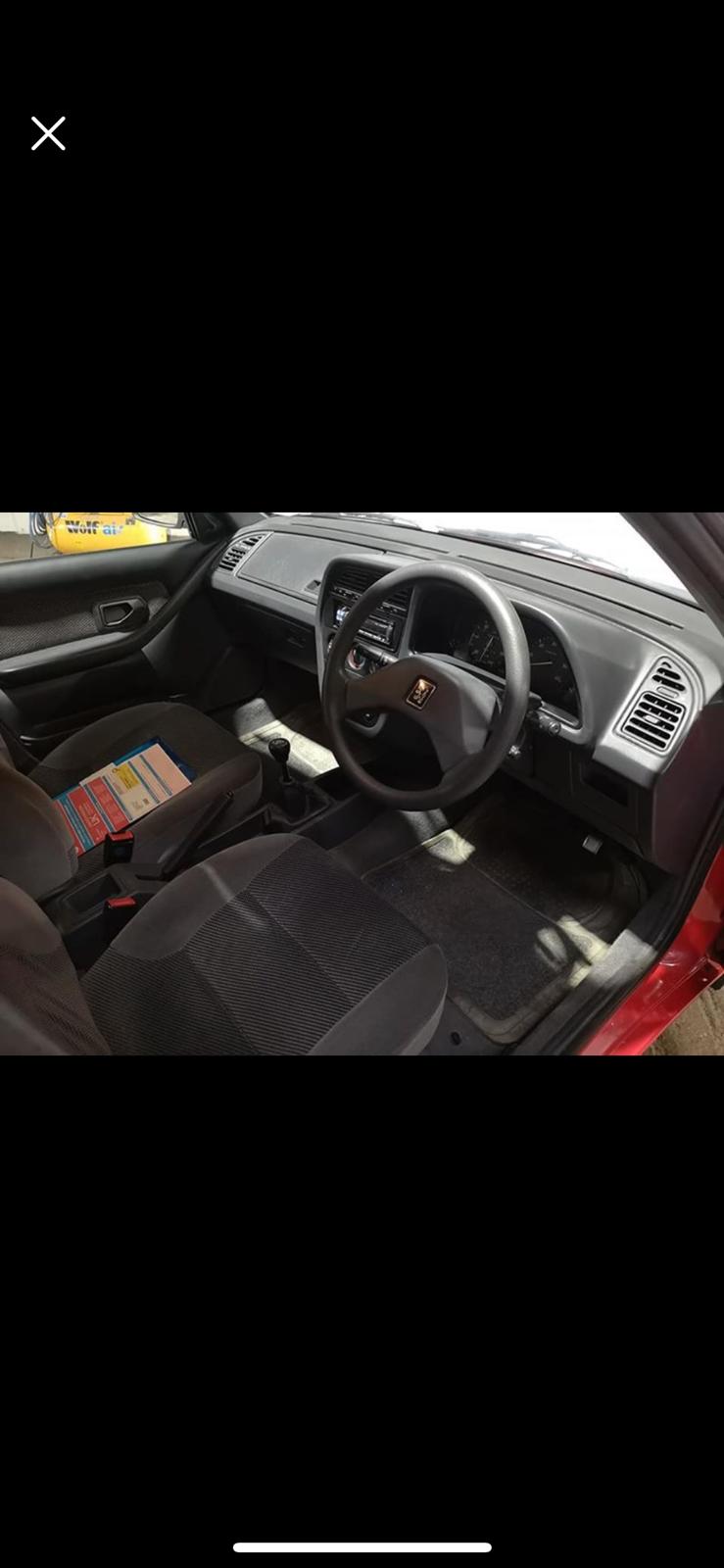

apart from that its completely standard (in need of some alloys) interior really is like new.
the car has done 122,000 miles and runs so nicely for an old diesel

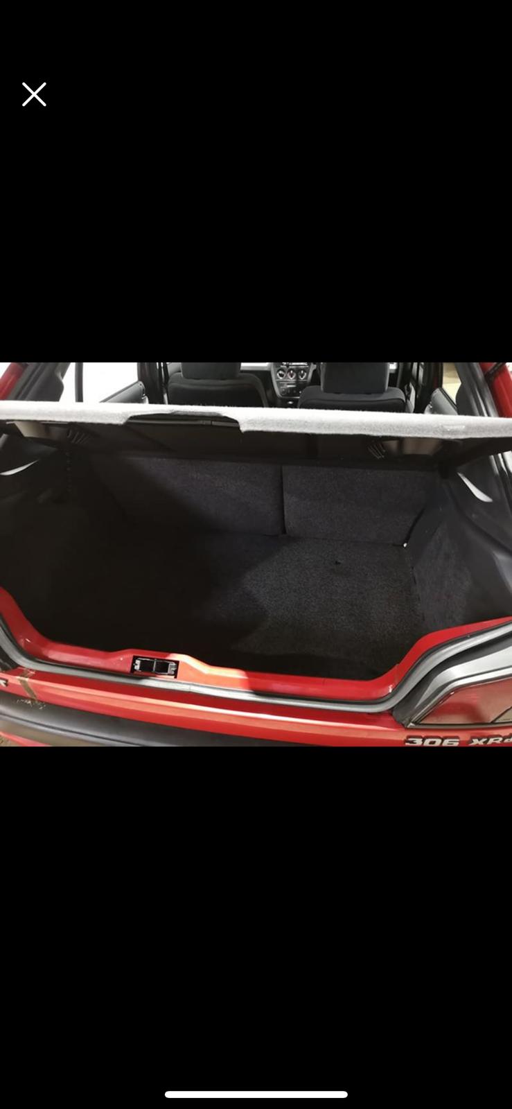

The car is very clean but worryingly I've come across rust in the passenger side rear arch where the lining has been missing. My local garage don't seem to hopeful about it and are taking a closer look tomorrow. Im now very worried the car is going to be a waste because of some rest. The only other bit of rust is in front of the electric sunroof but this is surface and is no worry to me and I will get this done in the summer.

is the rust on the arch or is it up around the seat belt mounting point. This is an increasingly common issue so I would get it fixed and move on. Carl can probably fix the rust too. Usually its a case of cut it out, weld a new piece in and then underseal it lots and leave. You can fit a liner if you want but NSR liners are rare. Its more likely that it came from the factory without one than it being lost!
In the arch around the seat belt
Garage is not sure weather it can/should be fixed. When you say move on do you mean get rid of it ? I love it and want to carry on with it if I can.
anything can be fixed with enough time and money! i had the problem on my current ph2 3door and my old ph2 5 door on the 5 door it was rusted out to the point where would could fit a football in the hole.
as far as i can tell the arch liner on the passenger side rear was only fitted to the ph3 cars although my ph1 d turbo 3 door did have one fitted when i bought it.
to fix it properly it needs cutting out by someone who knows what there doing and panels from a good car that has had the liner since new welding in and sealing properly.
sent you a pm also.
It's a very common problem & lots of 306's have had the N/S rear wheel arch welded. If the garage you mentioned don't feel confident in fixing it then phone around n find one that is! A good fabricator will be able to repair the panels with fresh metal.
I think Eyore was saying bite the bullet, swallow the cost to get it fixed n then enjoy the car. At this age they often need some attention but the compensation is driving something that's fun, increasingly rare & therefore a bit different from the norm!
I've got away with just a minor amount of rust! (You need remove the trim from NS of the boot to fully check the extent of it).

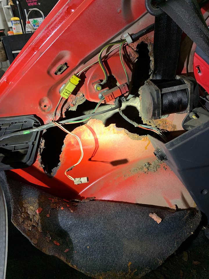

This is the extent of the rust.
This is the only major rust on it so this will be done Tuesday and the car will be solid can't be bad for a phase 1 surely its nearly as old as me lol
(09-01-2019, 04:03 PM)Karlos89 Wrote: This is the extent of the rust.
That's bad, can't be much car left!
Good job you checked and you're getting it sorted

Yea it is pretty bad but not unrepairable. It will be fine when it's done.
oooh yes thats a good hole there! would love to see some pictures of the repair once its all done

Interesting its got a fun pin stripe. Thats one of the worst rust cases Ive seen but to be honest youve got to cut and weld a panel regardless of the side. Sorted is sorted Smile
