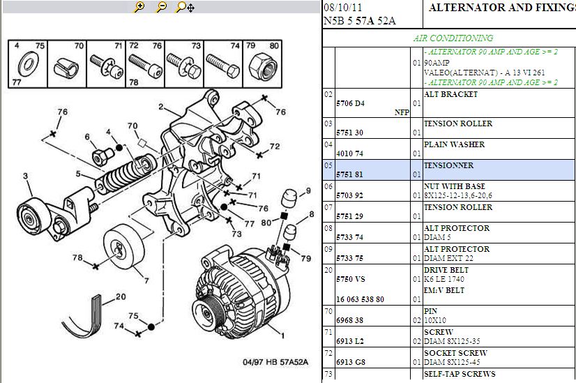

hi all...i'm newbie in here...and first , i'm sorry of my bad english...
i need to ask about type of tensioner that should attach to my XUD (engine code D8A)
few days ago....i suddenly lost tensioner when i drive ...somehow....which make aux belt loose
and since the XUD engine are very rare in here (i live in indonesia)....i can't get any reference in my country (806 HDI 2.0 is the oldest peugeot diesel engine in here)
so...my question is....
1.which tensioner should i buy ?
2.what type (or how long in mm) of aux belt should i buy for my engine ? (i use power steering , generator , A/C)
i'm little confused because there is few types (shape) of tensioners when i'm google "XUD9TE tensioner"
thank you in advance....

Hi there,
I have done the belts on my ac xud 306 recentlly.
If you remove the RH wheel and the plastic cover, you can look at or remove the aux belt.
There is a second adjustable fixed adjuster lower down that you can loosen and the belt will come off easily.
To retension there is a 7mm square hole for applying tension while locking it back up.
I had to apply more than should be neccessary to stop the auto tensioner from making a noise at low rpm.
The AC models have your picture (1) version of auto tensioner In nearly all cases, but you should just be able to
see the square hole on that one from below to verify.
I think these (ac model) auto adjusters are problematic, and though I haven't replaced mine yet, I recall that a bit
of gear (maybe the power steering pump) has to be removed to get at it.
Make a drawing of the belt fitment around the pulleys before you take it off, though you could probably find the diagram on the internet. Maybe mark the manual tensioner too if you are unsure.
In the middle of a long section he belt should be able to turn 90 degrees when using finger and thumb.
The auto tensioner takers over the tensioning to a degree, but you do have to make it take up some tension using the manual adjustment.
You are liable to get a stock belt off the shelf if you have the old belt in your hand, the tensioner I would buy online
unless you have a lot of peugeots in Indonesia.
HTH Ron

As Weka says, looks like you need one or other of the parts from image 1) in your first post, or possibly the second tensioner roller in the belts run.  Depends which part failed.  The tensioner is the spring-like part (5751 81) and the roller that attaches to it is 5751 30. Second roller is 5751 29.
5751-29 is quite similar with my tensioner now (one round hole , one square hole) and i just using 1 tensioner now....i know it should be at least 2 tensioners in a car with power steering and AC but now i'm just using one because i have no idea what kind of tensioner i should buy....i think its make my belt squeaking alot (because i just pick any car parts that can make my 306 works temporary....not set the belt yet in proper stock mode as it should) ... even i can hear the squeaking sound from 20metres

OK, so at the moment you have a short belt fitted so you can bypass the auto adjuster. The big problem with that is that the belt wont be wrapped around the load pulleys as much, and probably no amount of belt tightening would help.
Interesting that it can be done in an emergancy though.
it sound like you /will/ need to know the length/width of the AC belt before you can get the right one.
From memory, the Gates website had extensive listings.
I found the past ebay purchase for my belt and it's description is:
6PK1740
I thought of building a fixed tensioner to replace the noisy auto one, but i'm thinking that the longer AC belt may be more likely to slip with temperature change, not forgetting that we already have the extra load of the AC pump compred to other models.
Does anyone know for sure what has to be removed to replace the AC model auto-adjuster? I recall reading on this forum that it may be model dependant.
Cheers Ron

exactly ron...its not wrapped enough to reduction the squeaking sound....even it still can turn ac and ps ON...that exactly what i thought...
and BIG YES (and big thanks)....6PK1740 <----i'm badly needed this is info....even if...just if...there is nobody sell it in indonesia....there are lot garage in here that can made custom belt from scratch as long as we know the specs of the belt with cheap price....
in your third paragraph....is it means stock tensioners in XUD have tendency to squeaking ? (even in great condition)
I know of another person who had a noisy AC model XUD9TE auto tensioner in a Peugeot 406, but can only say that my 306 even though only at 55,000K, was making a plastic cover rumble noise, almost like an induction noise, just above idle rpm, quite noticeable as you drive off, then as the revs climb it goes away. Much different to a bearing noise.
As I said before, I had to tighten the manual adjuster a bit more till it stopped, but the hinge mechanism of these adjusters is a bit suspect, I guess a new one will give no trouble for quite a while.
Ron
