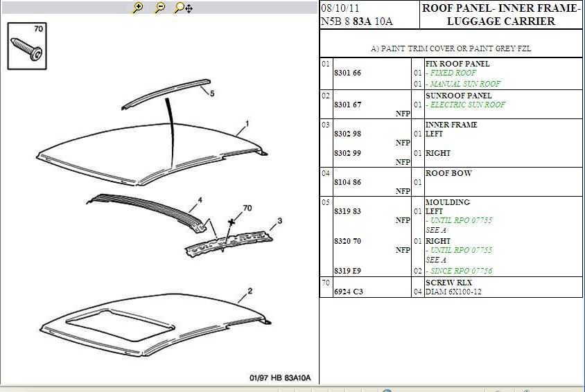

Hi,
Does anyone know or can look up the size of the bolts which fix the genuine roof rack to a ph.1 3dr? I'd imagine they're the same for all roof racks but still. I did have the bolts but they've escaped the tape that held them to the rack in storage...

As I've never had a roof rack on the car I'm not entirely certain which bolts you're talking about.  Could they be the M6 x 1 x 12mm ones in the schematic below?
Hi,
Those are the ones, and the mounting holes aren't deep so that sounds about right.
Thanks a lot!
