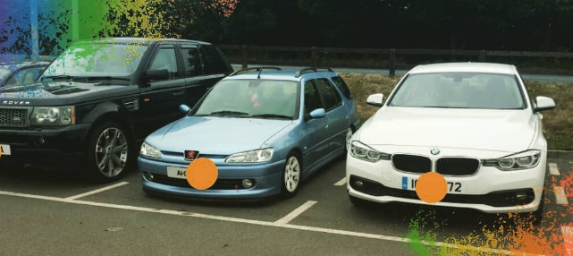

But my main concern is this.... i have a 1.9dw8 in my 306 ESTATE and have my eyes on a 405 estate to use as doner for my 306... [Image: thumbsup.png]
So do i need to get the entire engine bay/gearbox/clutch/driveshafts (anything else?) [Image: thumbsup.png] [Image: thumbsup.png] [Image: thumbsup.png]
Or can i do a straight engine swap and sstill use the same gearbox and clutch ??
 [Image: biggrin.png][Image: biggrin.png]
If anyone has any questions that would be great, answers even better!! Thanks
billz888
my car reg is ahz1115
p124 mkp is the car i might buy if everything on here goes well Smile
