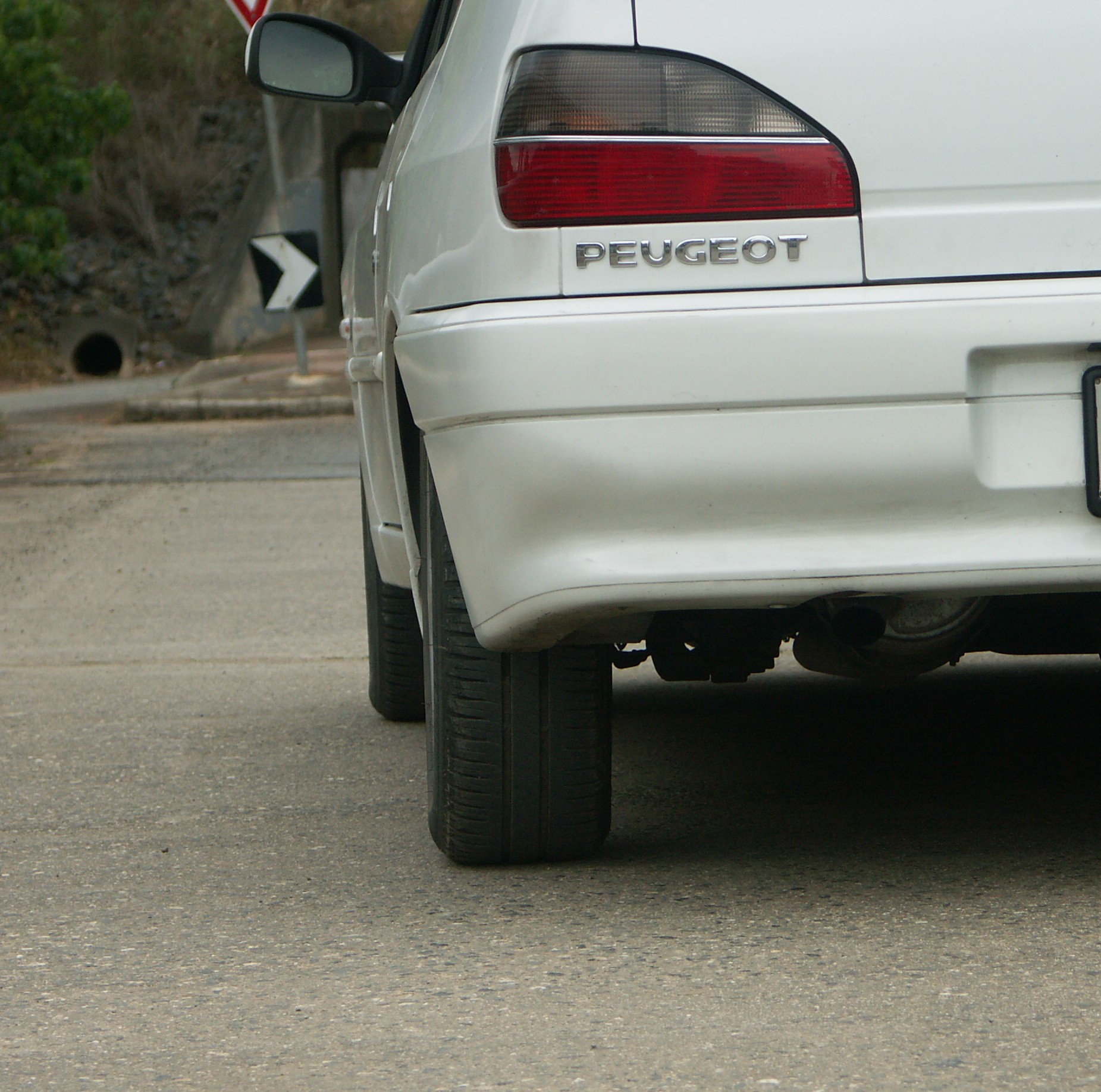

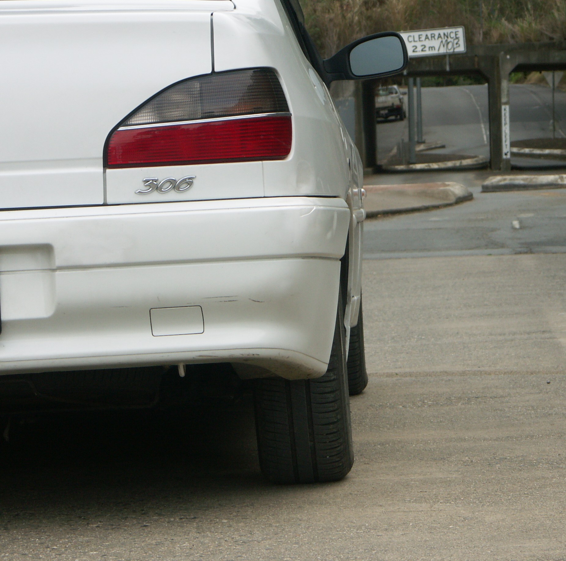

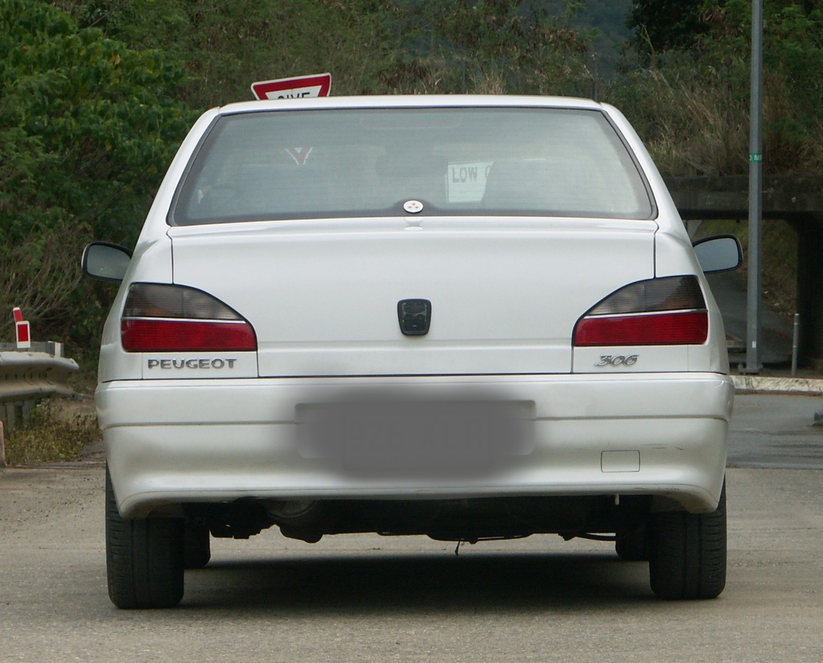

I've attached some pictures I took on a concrete bridge, not too far from level.
Car is not unloaded of junk at this point though, you can just see the right side is lower in height.
Using a plumb-bob made with light nylon and a small lead sinker, I picked up worse positive camber on the left side.
I could convert it to degrees by using the gap over the tyre contact point distance, it has to be done forward of the bulge at the bottom of course.
The difference top to bottom on the right side was about 6mm positive, the left side about 10mm positive.
