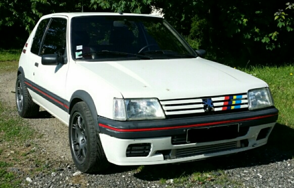

Hi Friends.

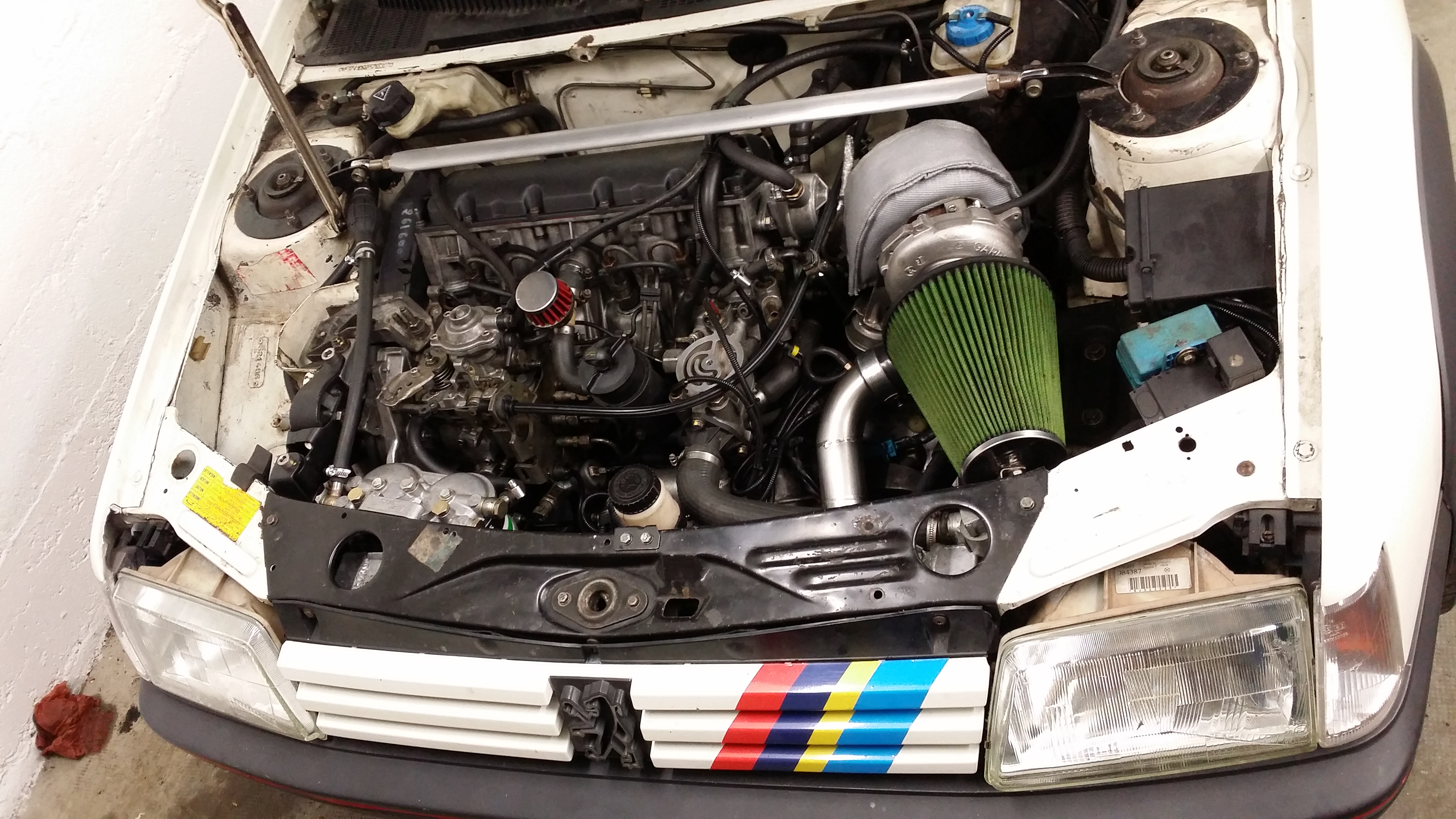

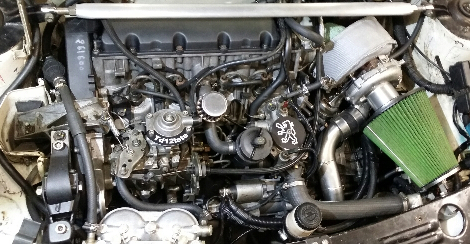

A long personal project, started in 2009, lots of work, lots of nights. But it runs....From France
2.1 TD 12s Forged, with GTB2060VKLR MFS 62mm
Custom 4 in 1 exhaust manifold and intake manifold

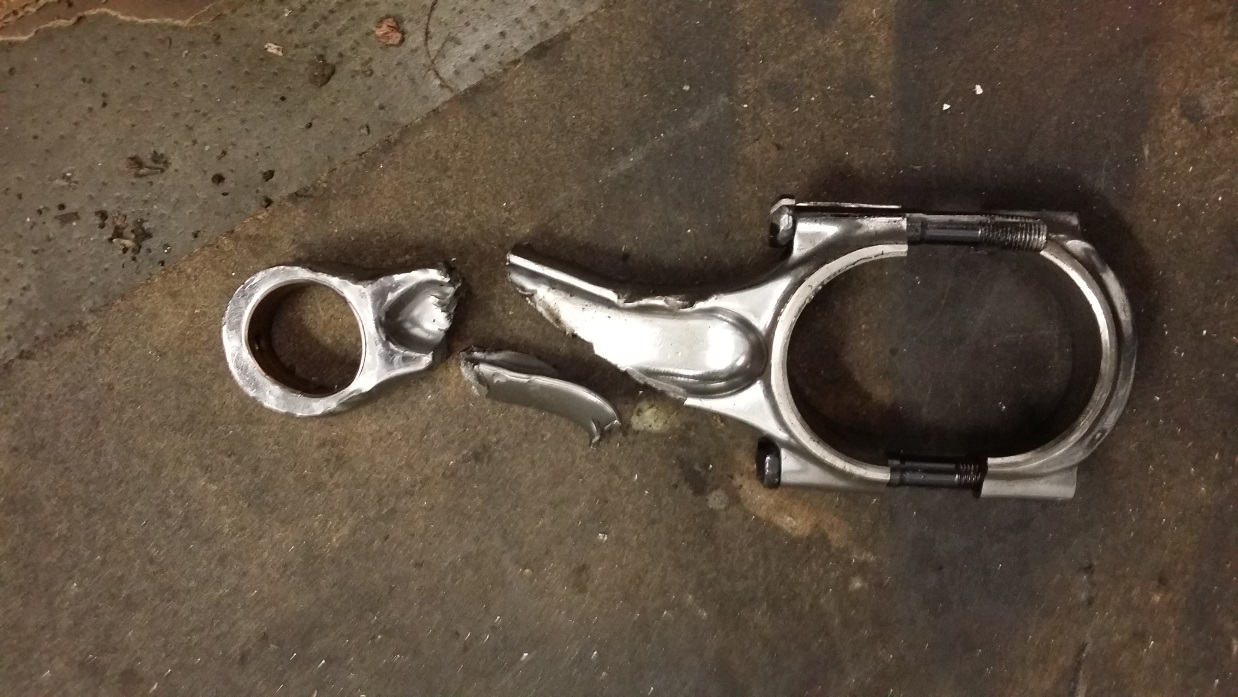

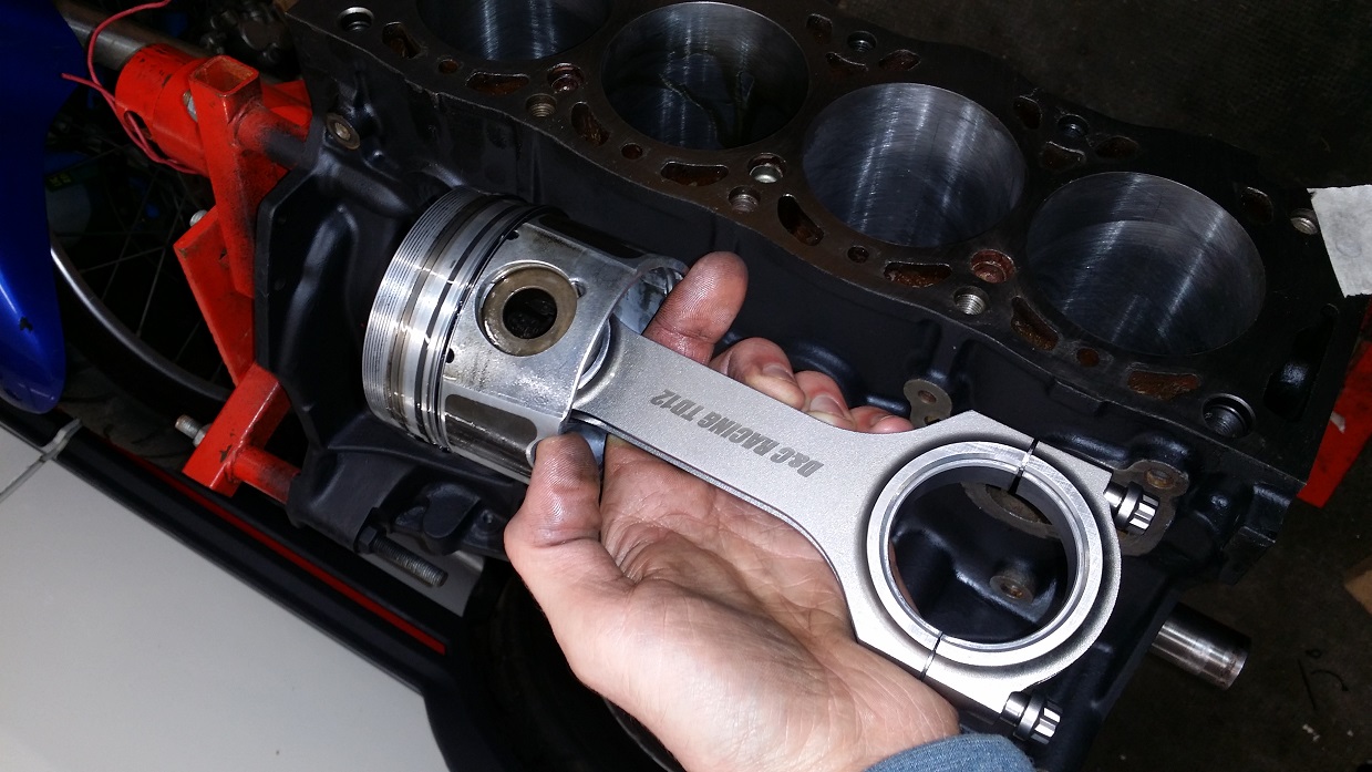

First version OEM conrods broke
NOW CUSTOM 2.1 TD FORGED CONRODS
Diesel parts designer:
-HDi/1.9td and 2.1 XUD11T forged HBeam conrods available in stock
-Custom ARP Head Studs kit available for HDi/1.9Td and 2.1 XUD11T
-Aluminium damper pulley for Hdi/Xud11T
-MFS prechamber for XUD
Ask for delivery

Welcome along. Well done on braking a rod. I don't think anyone in the UK has amanged that yet

How does it handle with the big engine?

(07-06-2018, 05:48 PM)Danny Wideboy Wrote: Excellent work.
Good to see the XUD11 in a 205, not seen that before.
This sort of swap is very famous in France!
The torque is crazy. And handle very high but the setup is not ready for the full power.

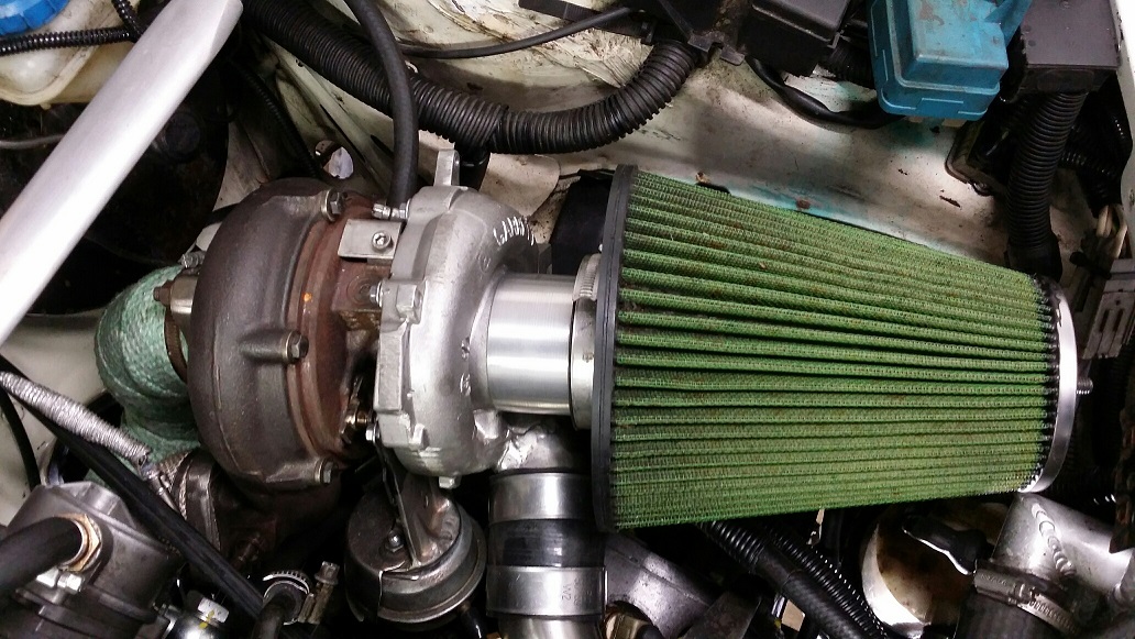

I have some adjustements with the front frame. And for the moment the turbo is not managed by my electronic boost controller. But engine is very powerful yet

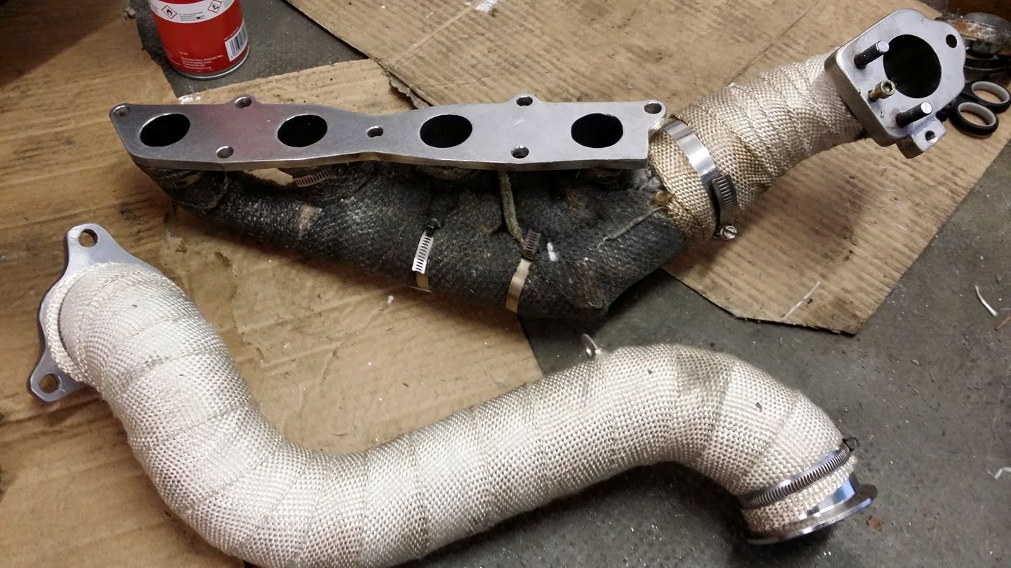

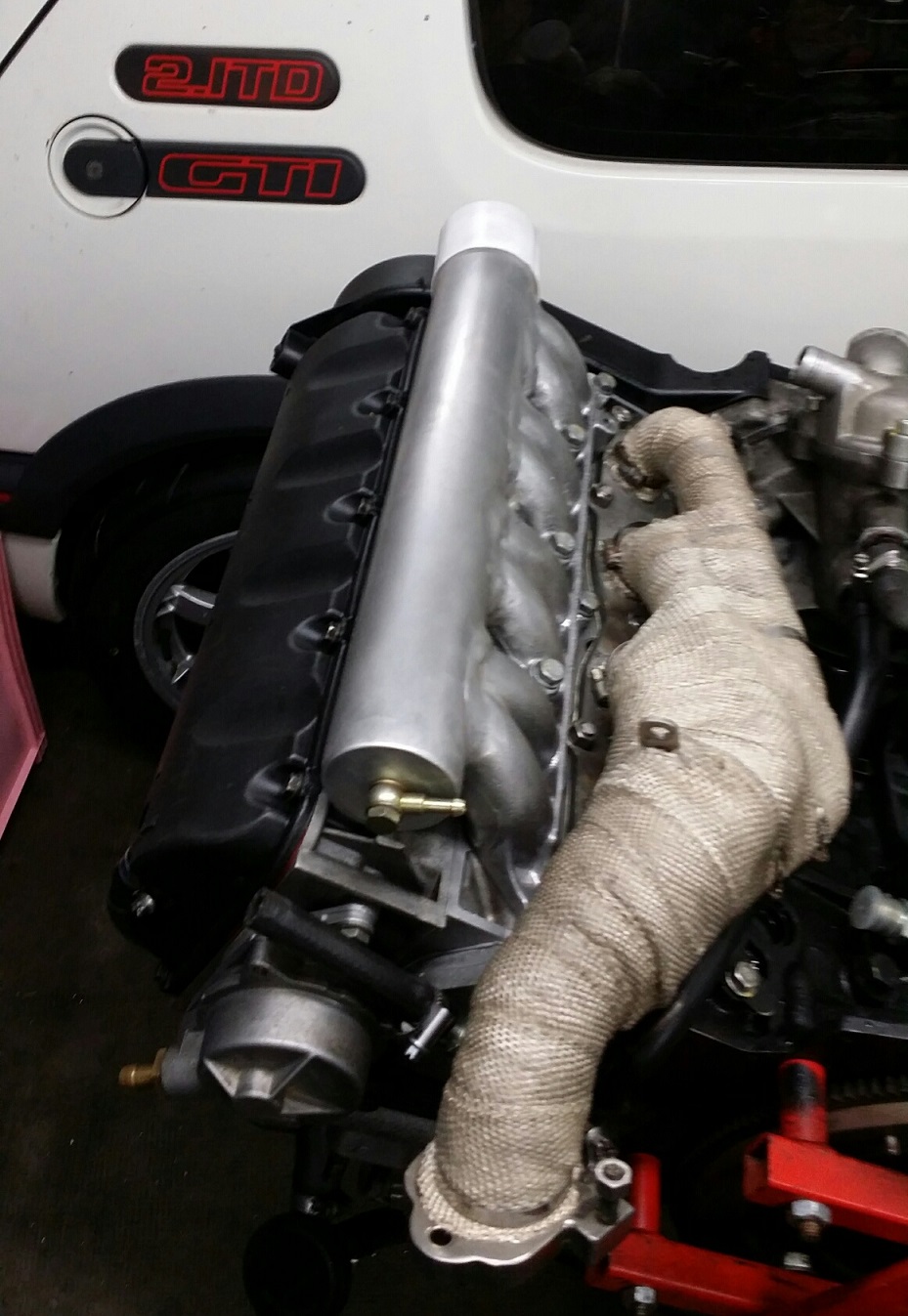

My exhaust manifold

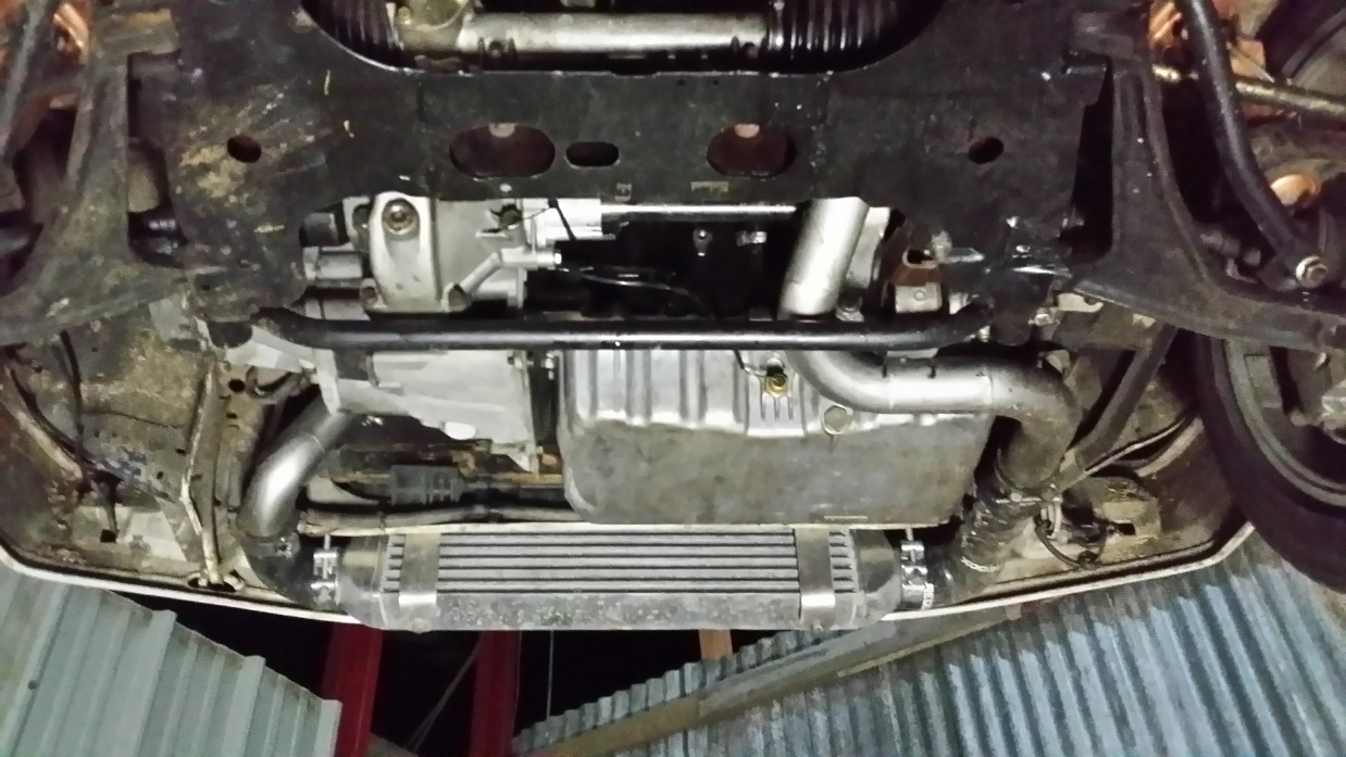

I prefer to pass the intake pipes under the engine, for more space over

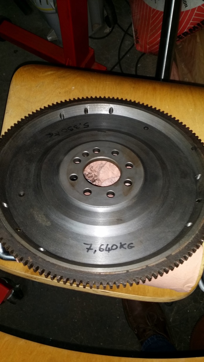

The flywheel is lightened -2.2kg

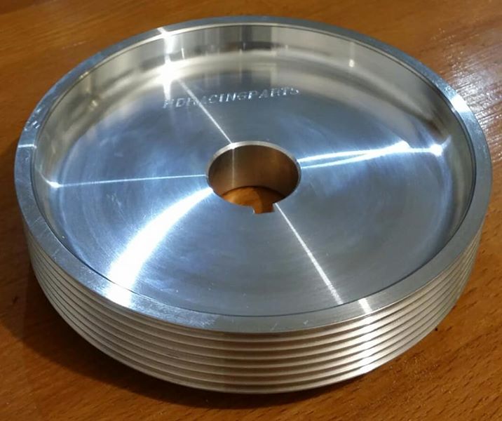

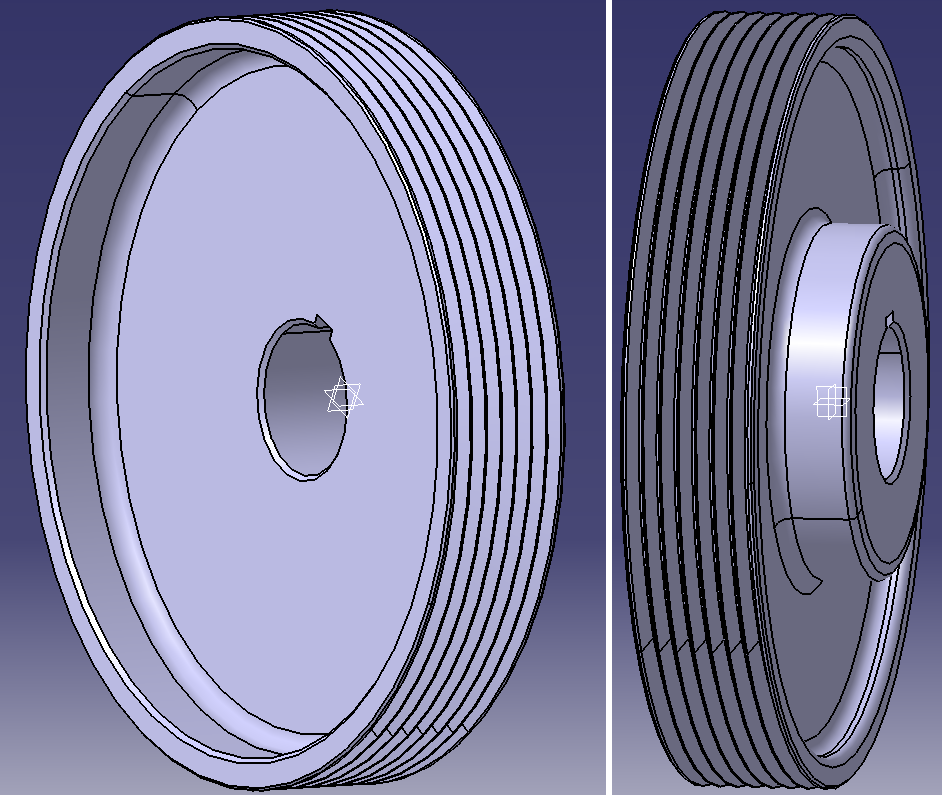

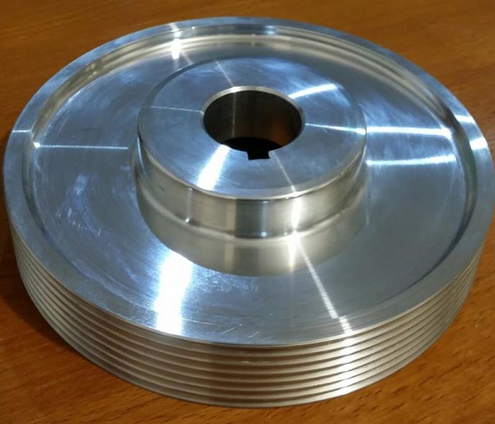

I designed this new aluminium pulley for xud11T and 2.0 HDi, now it's 520gr against 2.2kg before.
Available for who wants the same.

I'd strongly advise fitting a later 206 or 406 HDi alternator with that pulley if you can - it will prevent damage to the belt, idler and dampener. With the engine rotating assembly so light, the inertia in the heavy alternator can cause damage to the belt. That's why HDis have a rubber pulley or a freewheeling clutched alternator instead.

Ok Ruan. Thanks for the advice. But are you talking about the timing belt or the alternator belt? Not sure to understand....

He means your alternator belt.
The alternator will become too heavy to turn because the drive pulley is so lightweight, the belt will slip/vibrate etc and become damaged.
Newer alternator from a 406 HDi has a freewheel alternator. It has a "clutch" on it which operates one way. a bit like a bicycle wheel.

So the risk is only to brake the alternator belt.
I run like that during more than 5000km before with my first R.I.P 2.1td (standard conrods broken).
And the belt is still alive.
Do you have picture of the 406 hdi alternator?

(21-07-2018, 10:20 PM)Biggen Wrote: So the risk is only to brake the alternator belt.
The risk is to the belt, alternator and the dampener - it will be made much worse with the lighter pulley. You can usually tell the clutched, freewheeling alternators as they have a cap over the pulley like so:
It will also help the engine's response as the the alternator can spin down freely, so the engine revs fall faster, meaning faster gear changes etc.

Thanks a lot for this information, i have never heard about this new technogy. I know only the old engines...hahaha
But I will test like that. I have never got problems before. I will let you know.
The revs already fall faster with 5kg less on the crankshaft....
