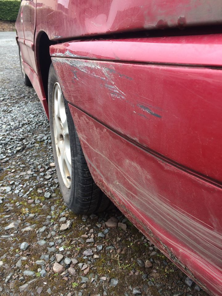

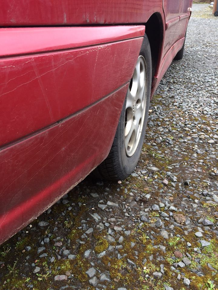

i have a 2000 306 2.0 hdi estate, 62k miles due an mot soon.... ive not owned the car long, but i know they are prone to rear axle problems.
how do you spot the problem, theres no knocking or banging going over bumps but the driver side does make a noise when braking hard for a few seconds, and also sits alittle more in at the top i think than passenger side, i was more thinking it was the brakes as the disks have seen better days, but worth mentioning just incase
i have a few things to do for the mot, id happily do them, hopefully mot it then maybe the axle in future, but if the axle is on the way out right now, ill probably weigh it in
its 18 years old and if its never had an axle it will need one, if one wheel has noticably more camber than another then its probably beyond saving and you need a replacement axle.
no reason to weigh it in, they will last another 10 years if assembled correctly.

comes down to what work it needs and what its worth, axles are selling for £200.
looks abit lower on driver side to
Hard to tell from that to be honest. At the end of the day if the car is driving OK and the suspension is still basically working at the back - oh and if it isn't rubbing on the arch liners - then there is no immediate need to panic. I bought my last car at 106k and the axle was creaking but still working. Wheels went in a bit at the top and eventually when I was changing tyres I ended up going for 175 rather than 185 as a 185 rubbed a touch. I drove that until the axle went sold one winter.
