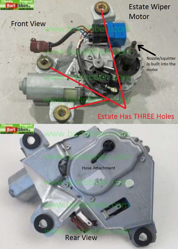

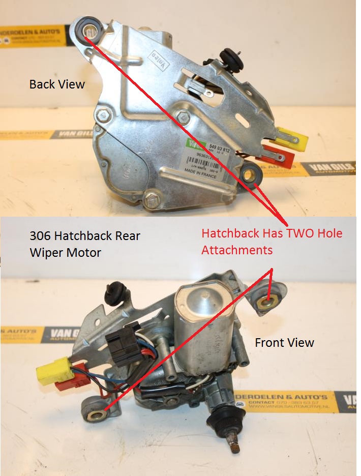

Please find below photographs of the differences between Hatchback and ESTATE Rear Wiper Motors. I made the mistake of buying a Hatchback one myself so I hope this prevents others from making the same mistake:
Then followed by the correct motor, the BELOW Photo is for an ESTATE variant tailgate, the major difference is that is has three insertion holes instead of two.
Your best bet in finding these motors will unfortunately be second hand / used ones from scrappies or ebay etc. They don't exactly come cheap and you are taking a bit of a gamble that it's in good working order. I paid about £50 for mine from a scrapper trading on ebay. If you don't any screws to actually affix the motor in to your boot, you can pick up a pack of WINGNUTS from your local DIY store. You only need 3.

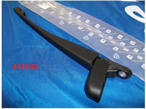

If your buying from scratch you will also need a wiper arm 6429Q5, I think you need a 7" wiper blade, just pop in your reg number on most car part websites to confirm:

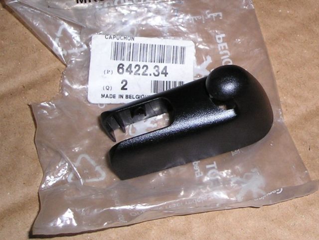

And if your wiper arm does not come with a little tidy cover on it, you can get one separately under part number 6422.34
