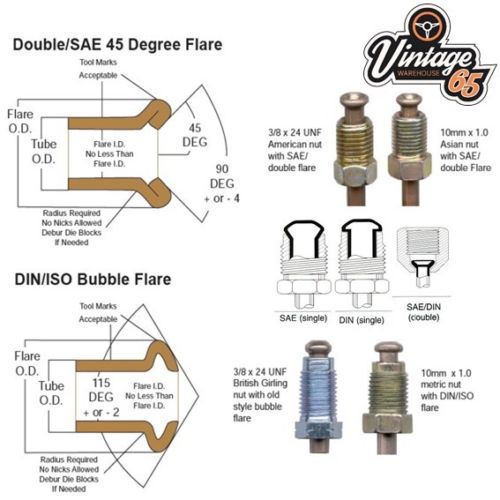

Think I've just worked out from the pic below that my single flares would have to be DIN single flares to fit the metric unions as the 'bubble' flare as I described it seems to be for older UNF unions.  (Why is nothing ever simple with cars!!!).

So, I finally got around to purchasing a tool for making brake pipe flares n have been doing a bit of practice. No problem with the DIN flares but the double SAE flares don't seem to be wide enough even though I put some force behind the tool (turret). The DIN flares don't sit inside the concave double flare as I expected them to. My only thought is I hadn't prepped the pipe properly. Any advice gratefully received.
if the flares are too small you need to use more pipe.
Ah-ha, that makes sense. Thanks for your advice yet again Welshpug.

Be careful with the unions, making the right type of flare for that union, din and sae, just look at the instructions.
