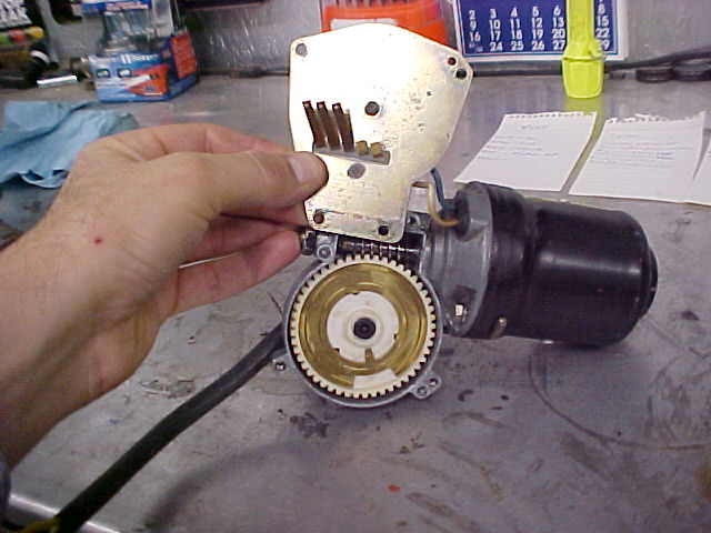

"Also, the wipers have started playing up (not parking, no intermittent wipe etc.,) and I believe having seen a guy on youtube explain the same problem on his Ph-1 that this is a relay as well."
you may have a broken/burned contact inside the wiper motor.
try these;
https://www.youtube.com/watch?v=Pa4jv8FvjAQ
https://www.youtube.com/watch?v=1Ww5-pmiokc

only if water gets inside, mainly due to blocked drainage hole below it.
