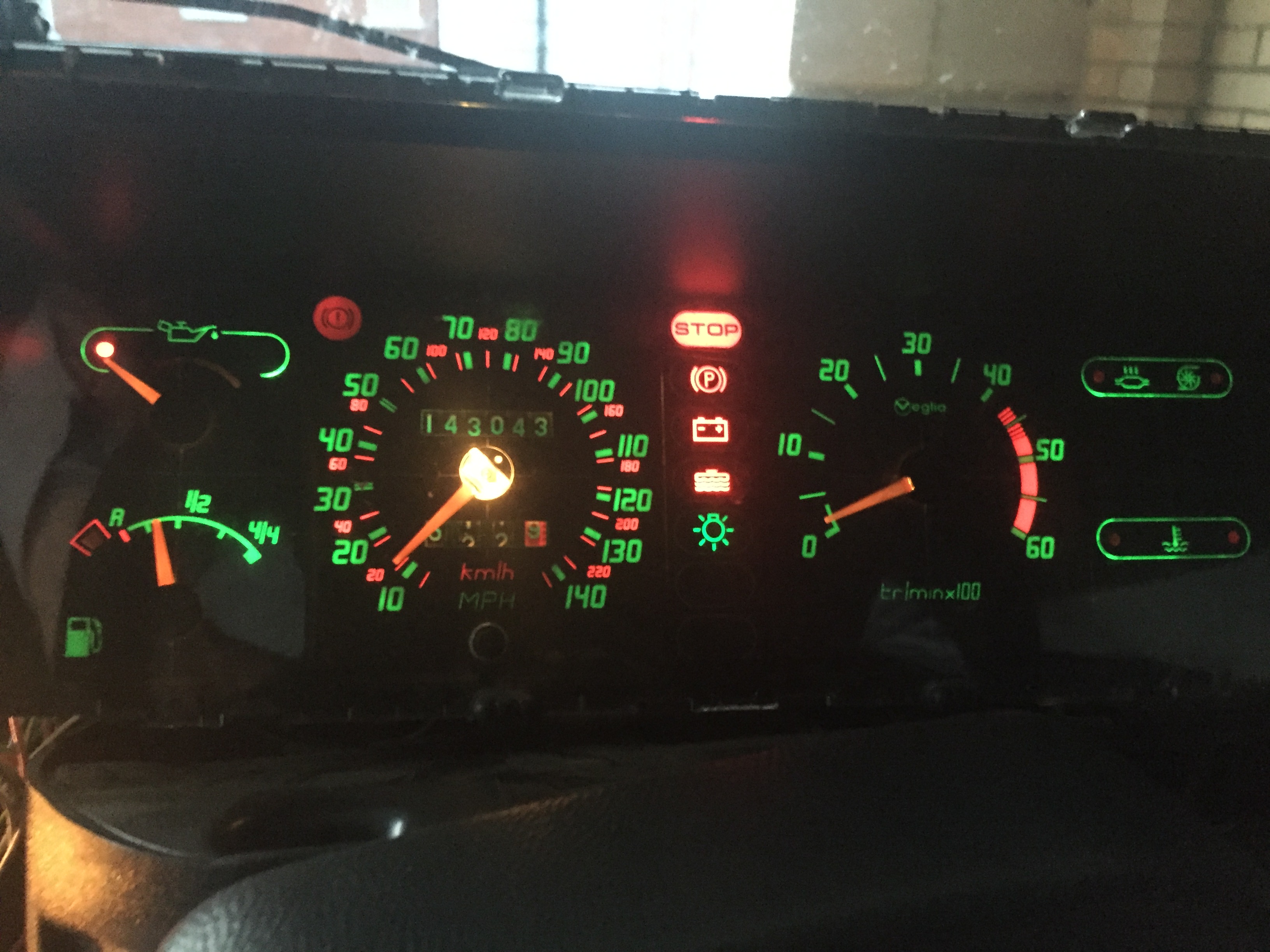

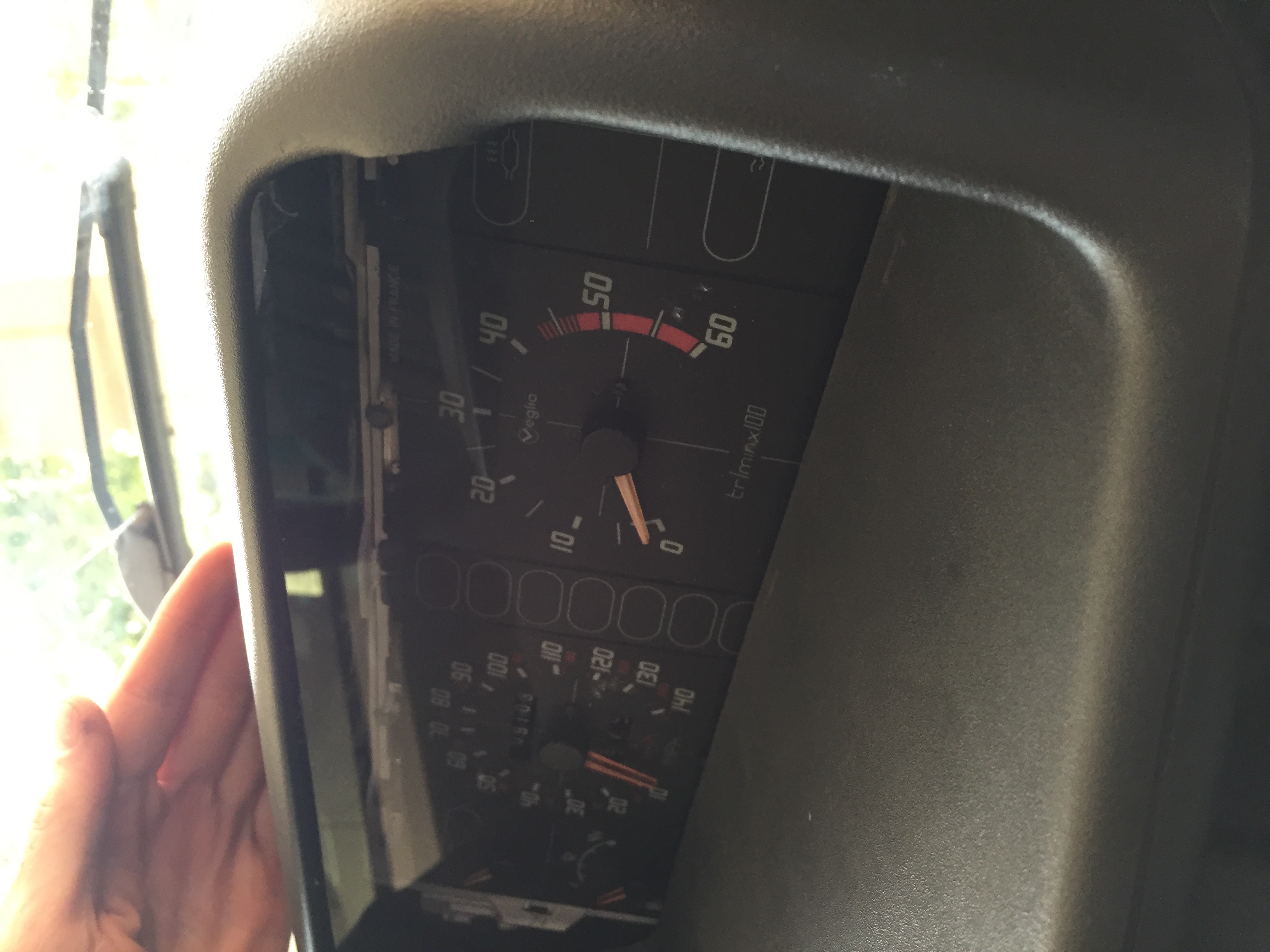

I installed the BX dashboard a little while ago as well, this was an experience and definitely contributed to my baldness. Good to have a rev gauge though!
On top of this i dont want to spend an astronomical amount of money on a gti dashboard so i cut my poverty spec one up and cut out a piece of acrylic to fit. This doesnt cover the dash enough so it reflects on the windscreen at night  Doh
the plexi turned out to rub on my fuel gauge making me think i had a full tank o' veg on a few occasions, so I removed the dash glass.

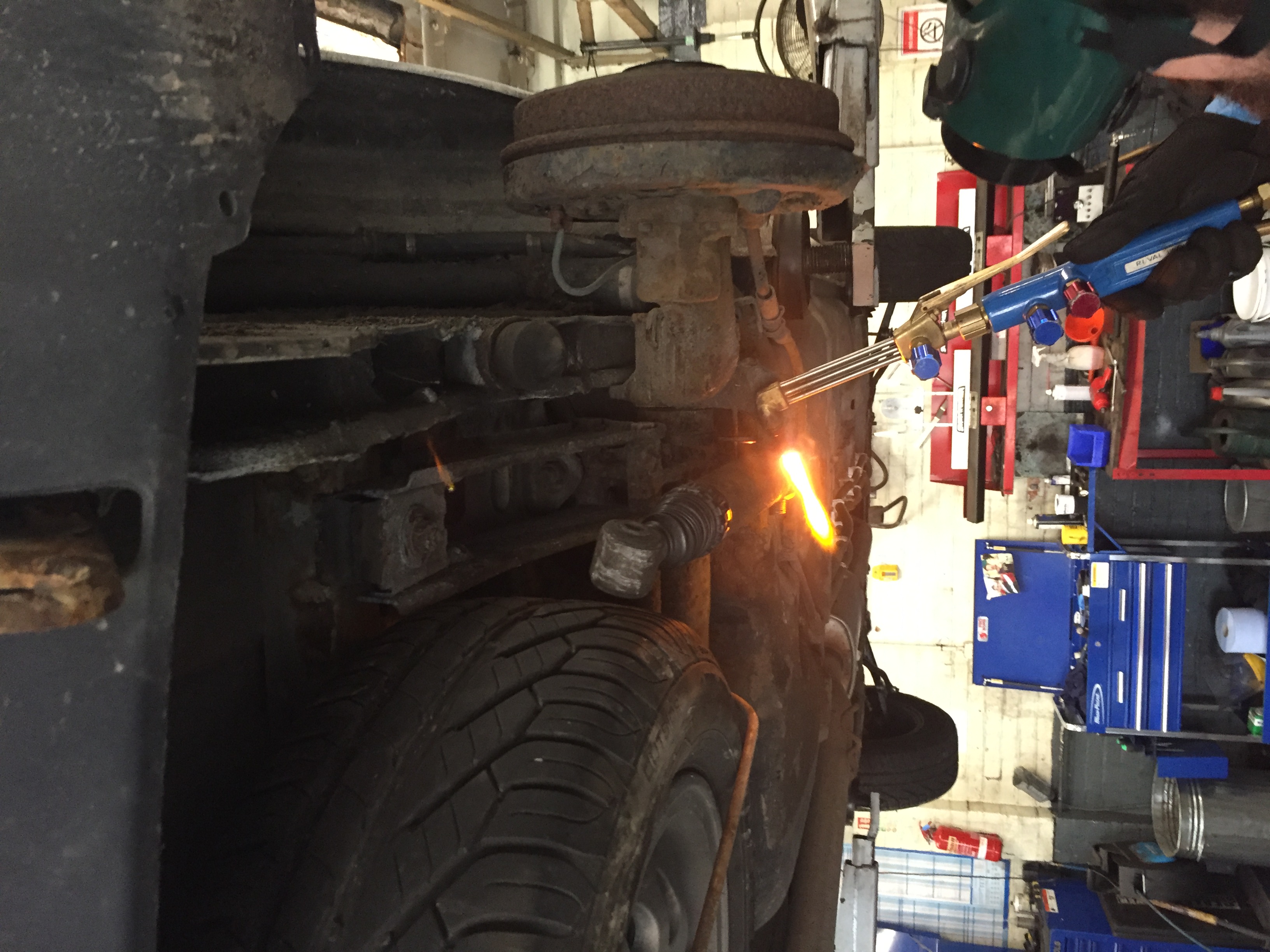

I got a 205 gti sub-frame a while back and painted it black along with the wishbones and front arb. I also purchased new drop-links, Eibach E7001-120 springs and Bilstein B4 shocks (the gti ones with the tabs of course).
The front was bolt on except for one bolt which needed grinding off, and yes i did that nut up.
The rear shocks needed some persuasion with fire.
The rear beam adjusted to suit the new springs
After all this was done i got my brakes adjusted and in the process the stub axle sheared wtf?
The difference the old and new setup is night and day, I always heard 205's have great handling but had never experienced it until now.

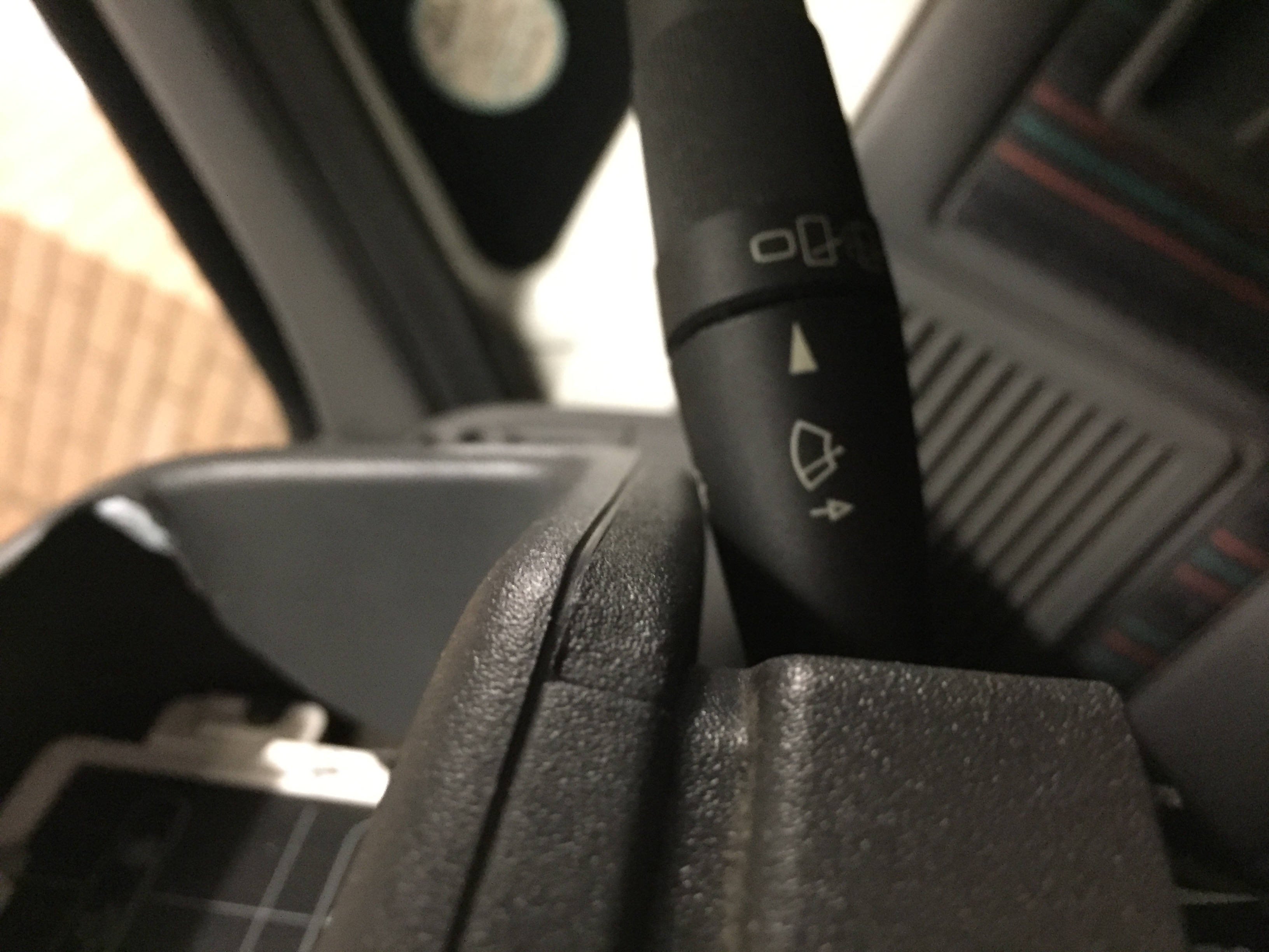

My 205 doesnt have intermittent wipers and it's really annoying when its that shitty rain and I have to flick the wipers every few seconds (first world problems).
So got myself a wiper stalk with intermittent and a relay. This is a straight swap, just replace the stalk and put the relay in place of the blanking plate, this does mean taking off some of the trim but i am a dab hand at this after all of the times i pulled the dashboard out in the past!
it's a tight fit
I was pleasantly surprised to find my wipers auto cycle when i wash my screen as well Smile

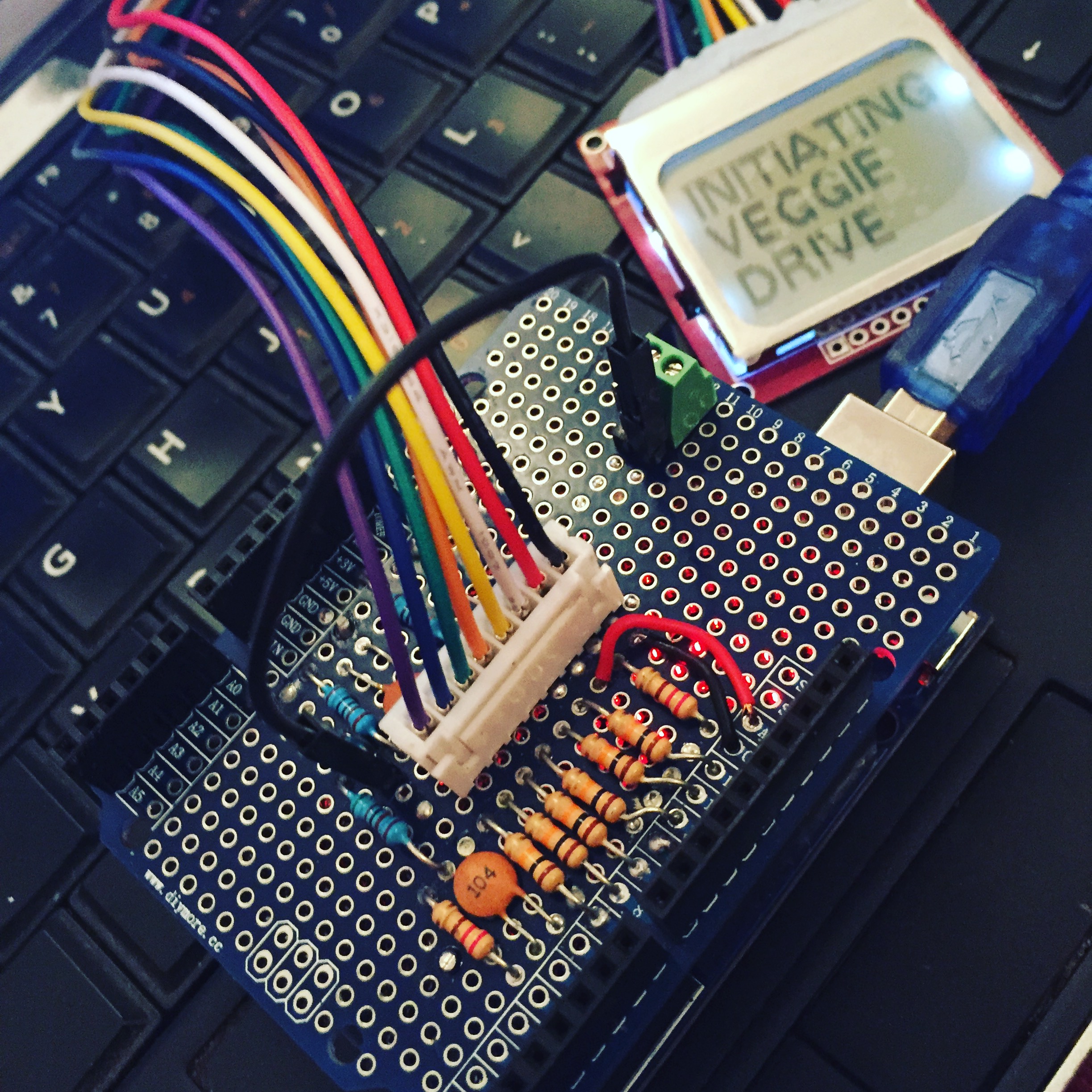

Sorta finished the monstrosity that a few people saw at pugfest and it is kina integrated into the dashboard now.
