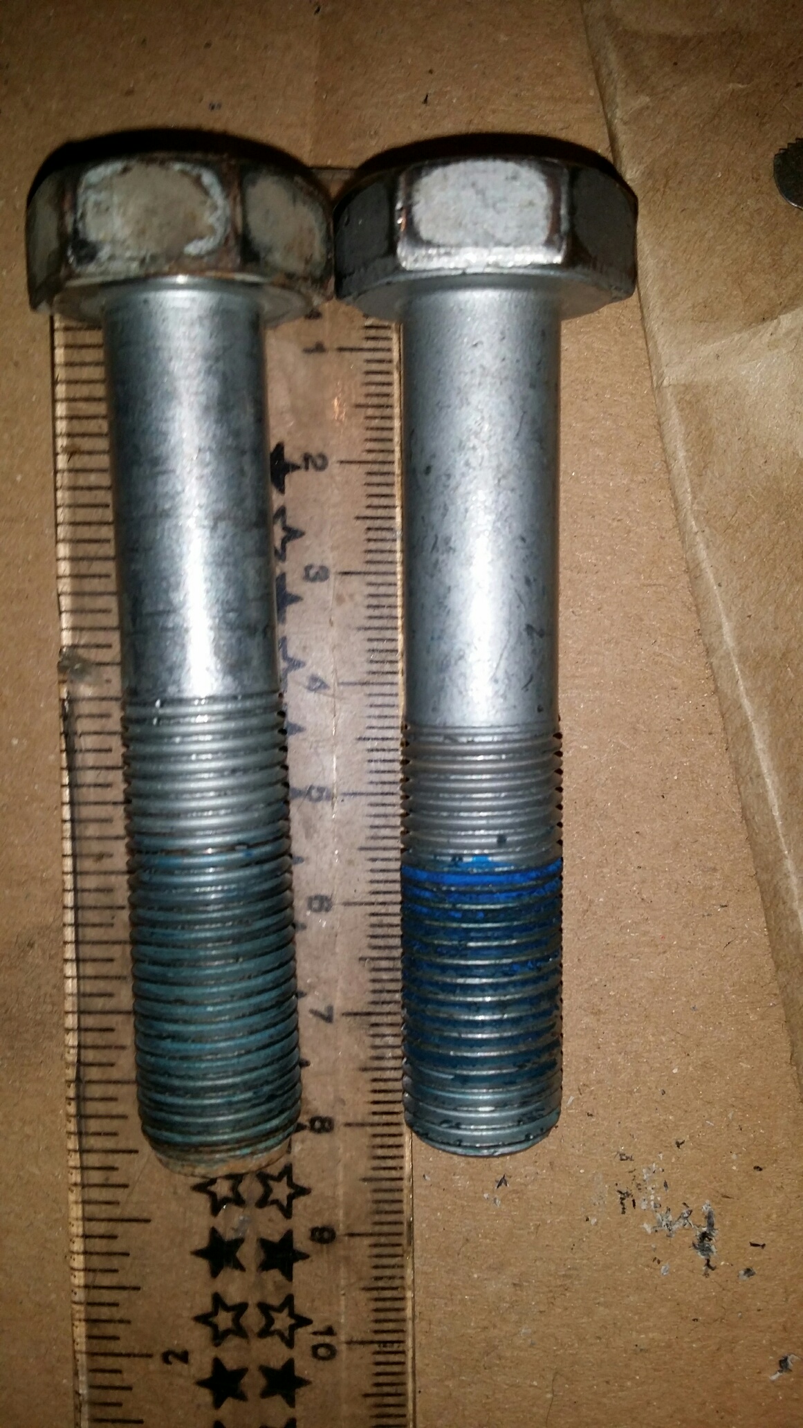

Anyway I used the starter trick (oooooh sooo carefully!) to remove the not-quite-fitted bolt, getting the hang of it now! Won't be so scary when I have to do it on the Defender! Careful measurements with the calipers and thread guides found the measurements of the pulleys to be identical and the bolts to be almost identical. Only difference being the new one has about 3 threads less down the length of its shaft. However you can see the threadlock hasn't been disturbed far enough down for it to have made a difference?
Not really sure what to do next. Maybe have an inspection of the bolt hole and clear out any debris carefully with a pick? Find out the exact thread and size to buy a tap to clean it out with?
I've included a picture, new bolt is on the right. I feel they're similar enough for the problem to lie elsewhere.

Just tap it and clean it out. Or heat the bolt up then thread it in. If its warm will melt the thread lock on way in. Had it a few times where they get "tight"
Sounds like you've got a dirty hole! Clean it out the best you can.
If you're really stuck I'd just use the old one is that goes in ok with thread lock.
Yeah clean the internal thread out, a pick would do the job fine. 40nm isn't right for torque setting, that'll fall out in a week. Should be about 200nm.
Edit: Quick look on autodata says 40nm +51 degrees, then re-check with torque wrench to 195nm.
Yeah I forgot about it being angle tightened later, I thought 40nm seemed low when I was going through stuff. The final check for torque I'll have to get done at the garage when it goes for MOT as mine only goes to 170nm
Anyway, I've had great progress today! I went to clean the threads out but upon investigation they were almost totally clean! By a stroke of luck the largest tap I had in my set was the exact one I needed! Ran it through but it didn't pick up anything besides a very faint trace of blue colour from the threadlock.
Anyway, I refitted the new pulley and decided just to have another go but using the original bolt. I also applied new threadlock, but it was in liquid state rather than the putty-like stuff that comes on the bolts by default.
Don't know if it was using the older bolt or if the liquid threadlock was just enough to lubricate it, but it went in all the way with just my stubby wrench on it! I was amazed! Tightened it to 40nm no problem and had it angle tightened without issue either!
