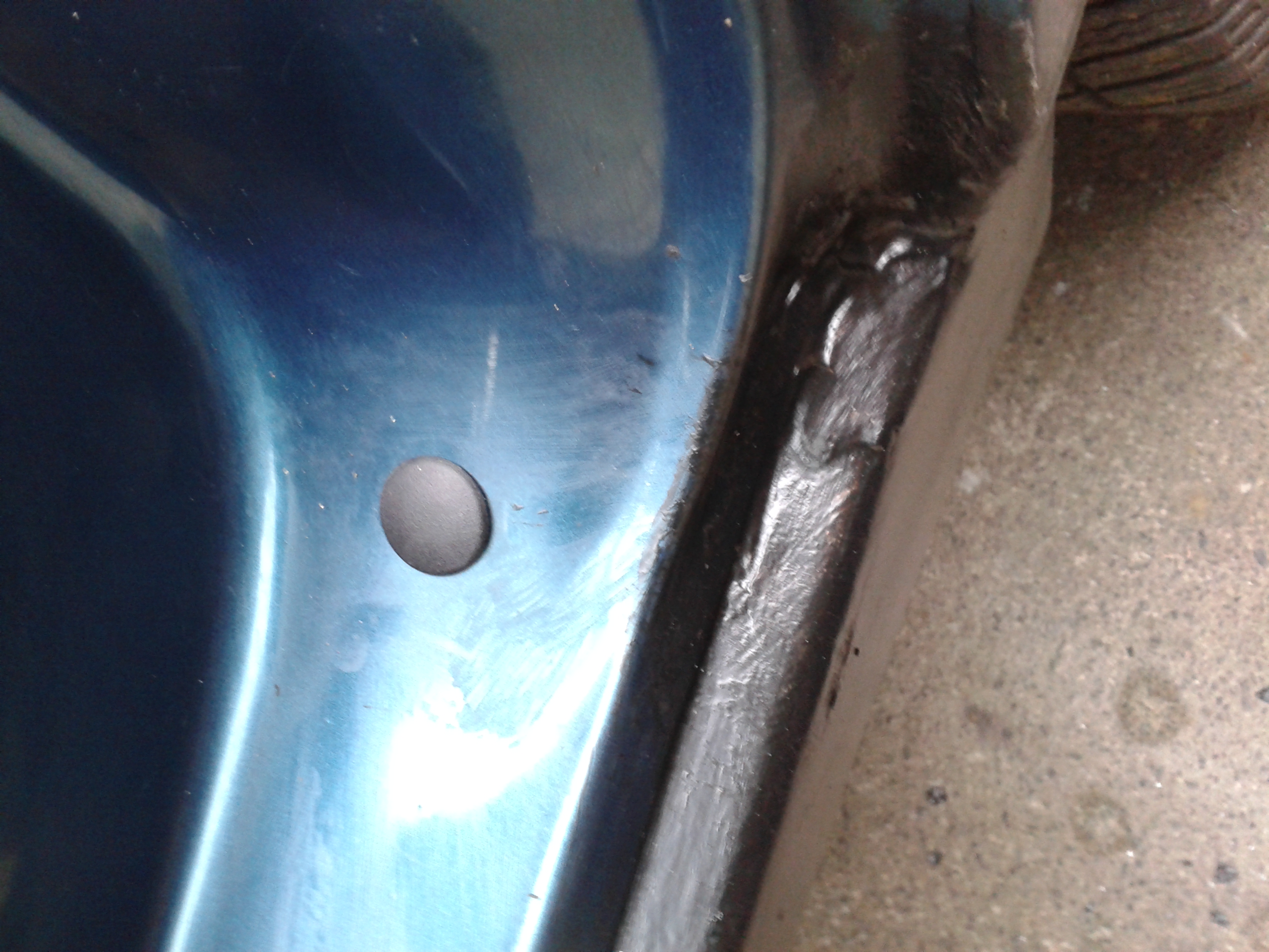

My mate just welded up the usual spots at the rear end of both sills  on my Peugeot 405 and as I discovered a 5 litre tin of waxoyl and compressed air applicator i squirrelled away over ten years ago in the recesses of my shed.   Is there access to the "back"/"inside" of the sill to blow waxoyl on the inside cavity of the weld if I prise off the plastic trim/carpet inboard of the door or is it better to drill 10mm holes in the sill apply waxoyl and then knock in peugeot fir tree fasteners?
Photo before welding!
there are bungs in the end of the sill.
However you risk blocking the drain holes.
What i always do on a welding job is cut away old rusty stuff. Use weld through primer (expensive but worth it) before welding that way protects everything inside. Then weld up. But otherwise as welshpug said just bang it through a hole if youre concerend

    Drilled and filled with warm waxoyl and a drop of white spirit (at 80psi)...double skin where I drilled so long "Tree" used.
