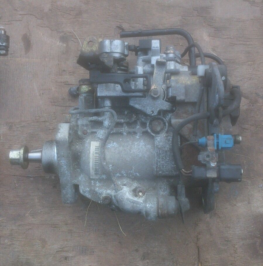

I have the chance of getting a Bosch pump from a Citroen ZX with injectors, pipes and everything to convert from Lucas. It has two sockets a black one and a blue one, the black one is for the immobiliser which I think I know how to deal with, the blue one, I dont know and do not want to buy an electronic advance pump which would need an ECU etc I am pretty sure this ZX pump is not electronic but would like some confirmation if possible, thank you.
pop a pic up if you can Smile
(27-10-2016, 06:28 PM)Mattcheese31 Wrote:     pop a pic up if you can Smile
That's a non-turbo pump anyway in case you're thinking of putting it on a turbo xud
(27-10-2016, 09:06 PM)Mark Wrote: That's a non-turbo pump anyway in case you're thinking of putting it on a turbo xud
It will be going on my LDV Pilot with NA. XUD. I'm trying to find out if it is non electronic and compatible
Hi is there anybody that could let me know if this pump is non electronic and compatible for my LDV pilot with XUD engine,as I have to let the seller of the pump know this week end Thank you
it looks damn like a mechanical set up non ecu looks near enough bang on the same as a turbo bosch pump except the obvious differences
As it's from a Citroen ZX then I'd say it won't have had an ECU with electric advance, however it looks to have the armour over the stop solenoid so was off a car with an immobiliser, but I believe people have managed to remove the immobiliser from them before so it is possible to use one like that.
