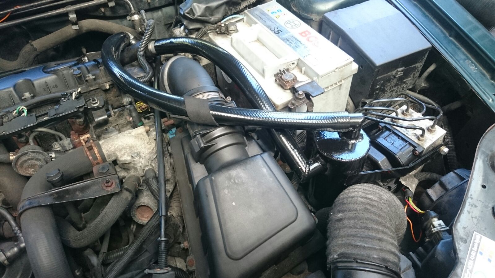

There simply isn't anywhere easy to put them in the engine bay and it's hard to find them with 25mm ports, so we figured we would design our own. We can make them for other models too if there is demand, but our products will be focusing primarily on the hdi for now.
Following from Alex's post, here is a picture of the finished item installed!
Fitted my catch tank the other night. Fit well. Took a bit of fiddling to get the tank in (Needed to remove maf and top of air filter box)
Also my extra power cables really got in the way and I didn't know how I was fitting the pipes unfortunately. All sorted now though Big Grin

Looks good! Where does the pipes from the oil catch tank attach to on a standard HDI 90?
Noticed any difference or good results so far Jack?
So far nothing hugely different. Although it does sound a little less sorta diesel clunky on start up and idling but I dunno if that's placebo. Might take a while for the oil built up in the intake to clear through.
The pipes attach from the top of the cam cover where the big 1" outlet id on the right side. And then to the tank then back to the intake pipe behind the air flow sensor where the origional pipe went.
how is the tank made up is there any baffles in it?
or is it just a tin with some outlets welded to it
GTI6 Info
No idea. Poodle made it. Hopefully has baffles although I haven't seen inside it haha
Oi! I made it haha!
There is a baffle in the tank and we were going to put some packing in too, but the prototype had absolutely no oil in the outlet pipe after a long test period so we decided to leave it with just the baffle in.
Woops my bad haha. Where it is located at the front of the car it hardly even warms up. It would probably condense any of the oil vapors anyway.
The company made it. Tongue
That's exactly the reasoning we came to when trying to understand why it didn't appear to need any more media inside, ie it was cool enough to condense the oil vapours. I don't mind admitting we were surprised by how clean the outlet pipe was after 10 weeks or more on my knackered, old, heavily-breathing, ragged-to-fook hdi.
