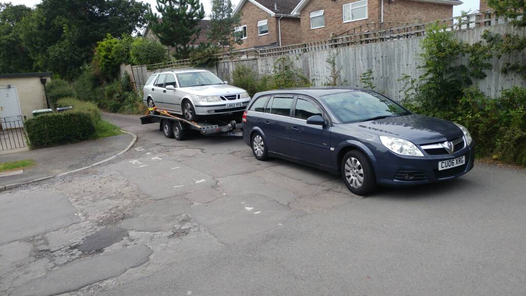

This is how ive just got my new car home.. Lol
