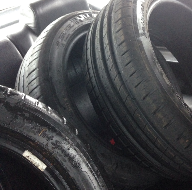

what do you mean find a set of tyres to run 15s? is that tyres for15" alloys or alloys for 15" tyres. Ive got a spare set of ps3s but youd have to pay me cost for them but if it helps time wise you can get them from ipswich.
(31-05-2016, 04:20 PM)Eeyore Wrote: what do you mean find a set of tyres to run 15s? is that tyres for15" alloys or alloys for 15" tyres. Ive got a spare set of ps3s but youd have to pay me cost for them but if it helps time wise you can get them from ipswich.
Need to either sort a set of tyres to run on track - in 15inch, with or without wheels.
or a spare set of wheels and tyres to get me home - I can probably borrow some for this purpose

Thanks all, was a last min decision to buy Dumdums tracktime
Cheers to Paul who is gonna lend his time and skills on Friday
Looks like sorted a set of part worn ps3 for tyres, need to source some rims to stick them on.

Tyres sorted

Have managed to sort tyres, and hopefully some spare steels to put them on to
