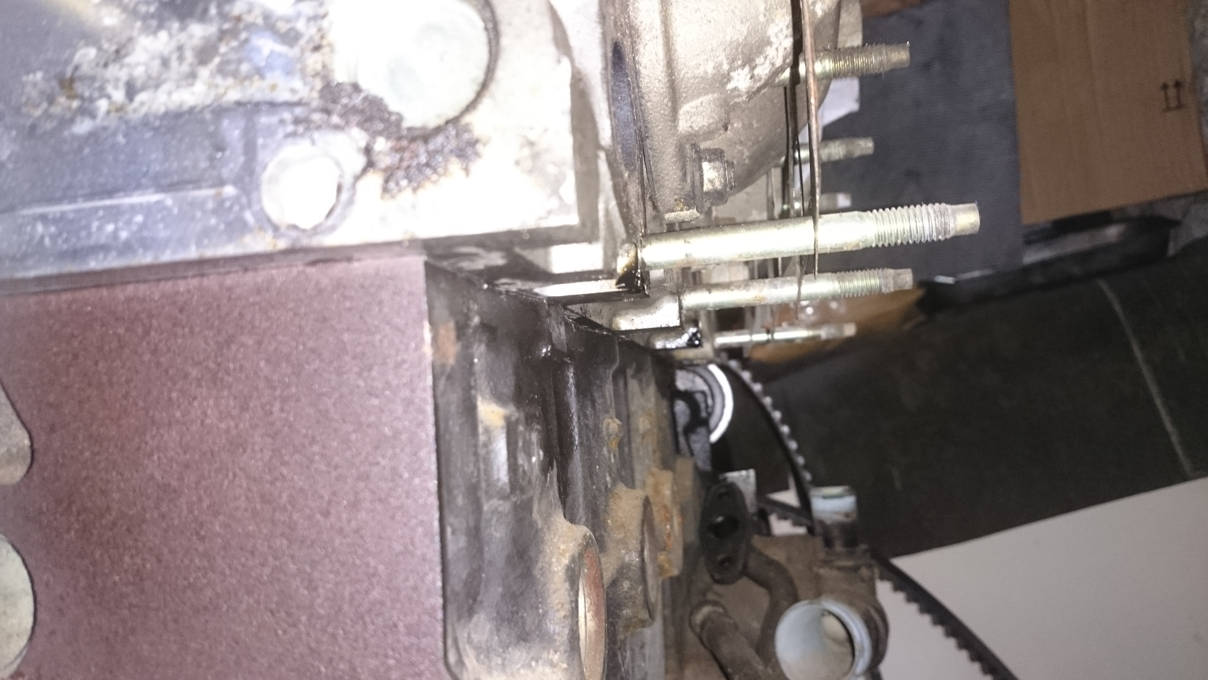

I need a measurement  of how far the head hangs over the block
Just for turbo clearance really down the back

The head is wider back to front than the block.
The head sits 20mm or so proud off the block.
Just trying to Gauge how much room I've got for an actuator
I'll try and remember to check the one sat in the garage tomorrow.

Due to the casting... The overhang varies.
27mm on that very first edge...but generally about 22mm from the flange for exhaust to the block edge
Spot on. Repped Smile
Gives me a nice amount of room to fit an actuator on
