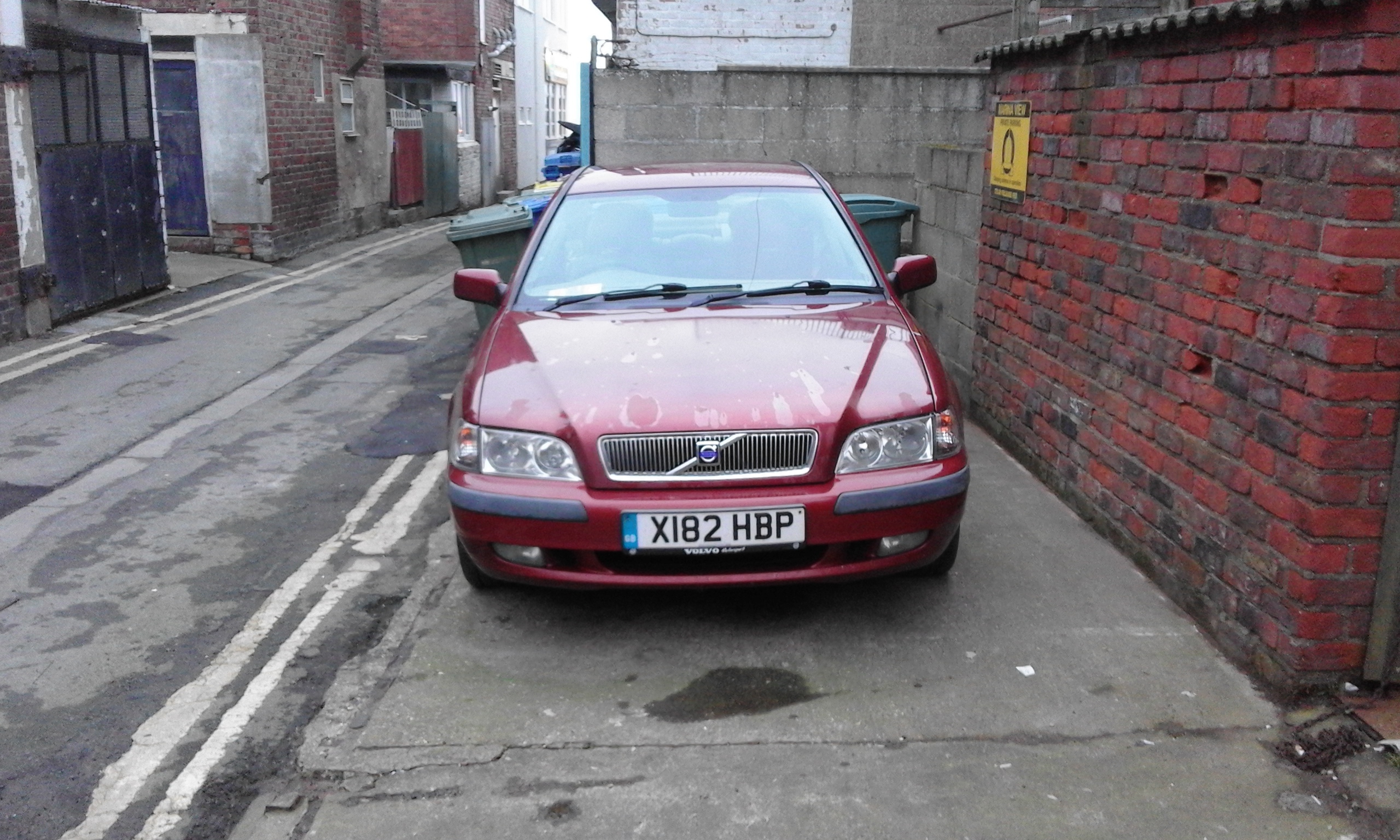

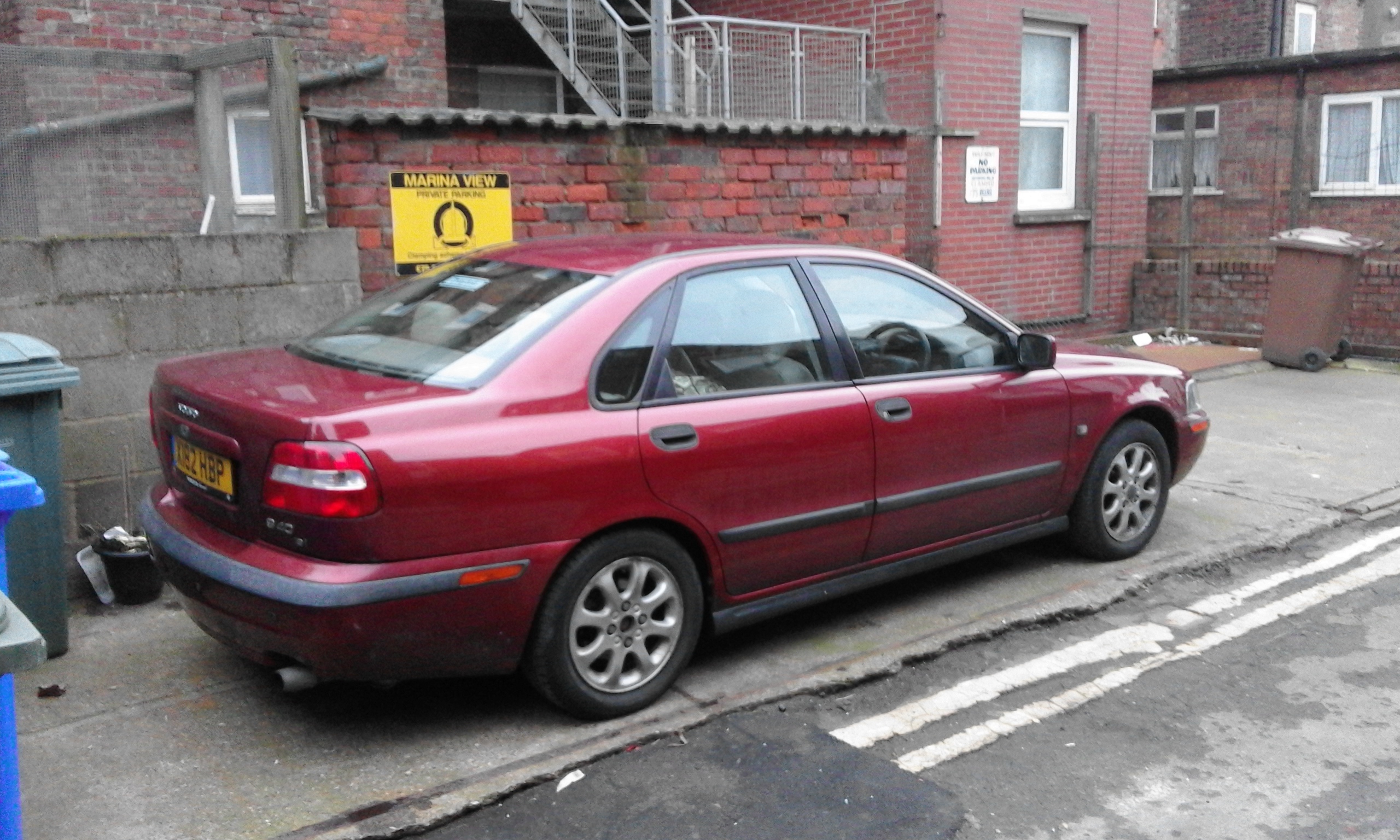

The new car.. an S40 1.8 GDi (the mitsubishi engine one) full of cruise control, climate control, ABS, Heated Leather...comfy barge
just cruising round in it atm, but plenty of stuff to do, theres a fairly hectic clunk o the front suspension, engine management light comes on and off at random, so may have to buy a scanner for some codes, plenty of stuff to sort on the bodywork, thankfully not dents... Smile
160k - miiint

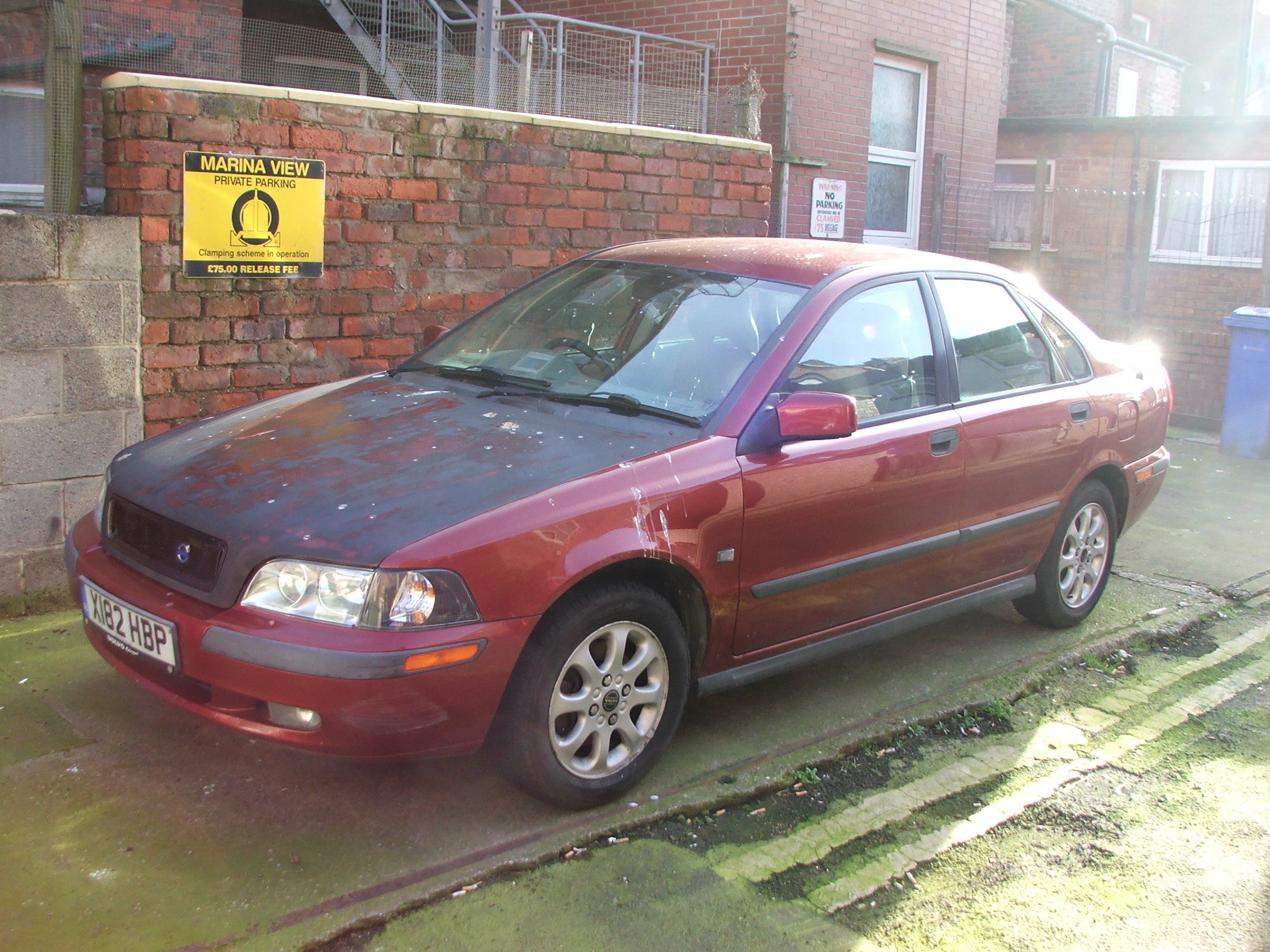

ended up like this :
just sat there for a couple months being shat on by seagulls, it's on the bay for 99p atm
