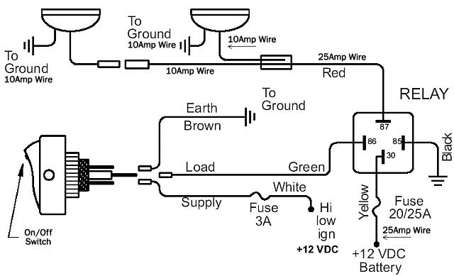

will defo need a fuse & relay to power them. just have to decide which circuit to tap into for switching.
a typical diagram

a typical diagram
