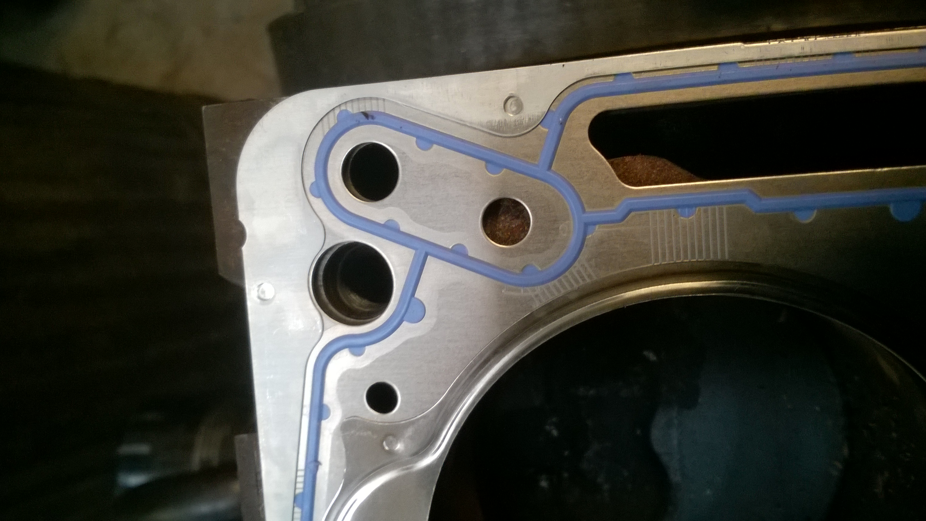

What hole in this gasket does the had line up with on the 1.9
Its the little hole in the gasket that doesn't appear to have anything behind it.
Must be the same as whatever the other hole is for without a seal between them, oil way isn't it? Maybe some have them in slightly different locations?
I'm sure that's a slot on some gaskets. Oil drain AFAIK.
See I thought the oil drains were down the side. This would be two high pressure feeds I think. (had help with this) its an xud9 gasket on an xud 11. So I might mill an xud9 head out so one feed can feed both if that makes sense. If they are both high pressure.
Where my finger is is where the hole would be on an xud9 for reference. everything else lines up
Ah that makes more sense, the oil drain is to the left of where you're pointing. So must be high pressure feed.
Thats a strange looking head gasket.. Whats the blue lines about?
                                                      HDI D'Turbo Daily Driver ---- XUD D'Turbo Project
(17-12-2015, 10:28 PM)daveylennon93 Wrote: Thats a strange looking head gasket.. Whats the blue lines about?
Was just a payen one. No idea about lines but have fitted many like this and never had an issue with them.

so we are back on this. if these are oil feeds my mate has offered to machine the holes together in head to make the one 2.1 feed fit the 1.9 two feeds.
