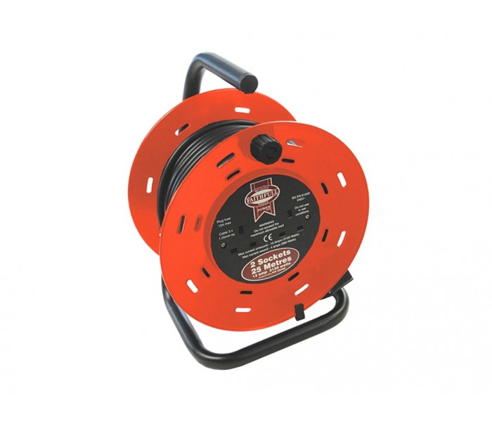

I am not surprised the electrical system on the corsa bit the dust, if you ran 500 volts threw it! i bet the full works was smoking too!
What sort of jump pack runs 500 volts?
(20-09-2015, 10:11 AM)Jonny81191 Wrote: What sort of jump pack runs 500 volts?
13amp extension real type will be rated at 500v Tongue
