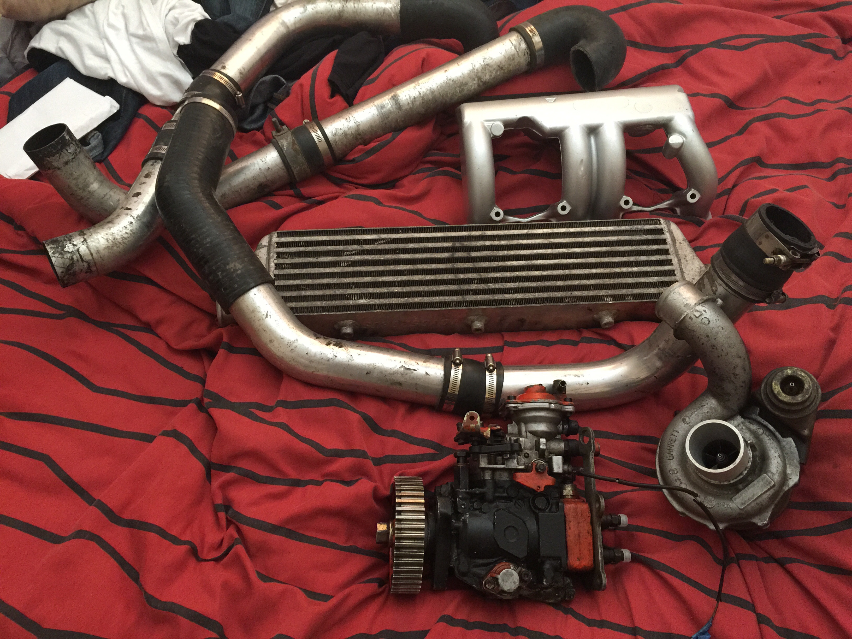

Ah yeah my mistake. This is my intercooler kit if it helps. It goes over the top of the intercooler like you described. I can get better pictures tomorrow if needed
Thanks given by: blinkyeatu

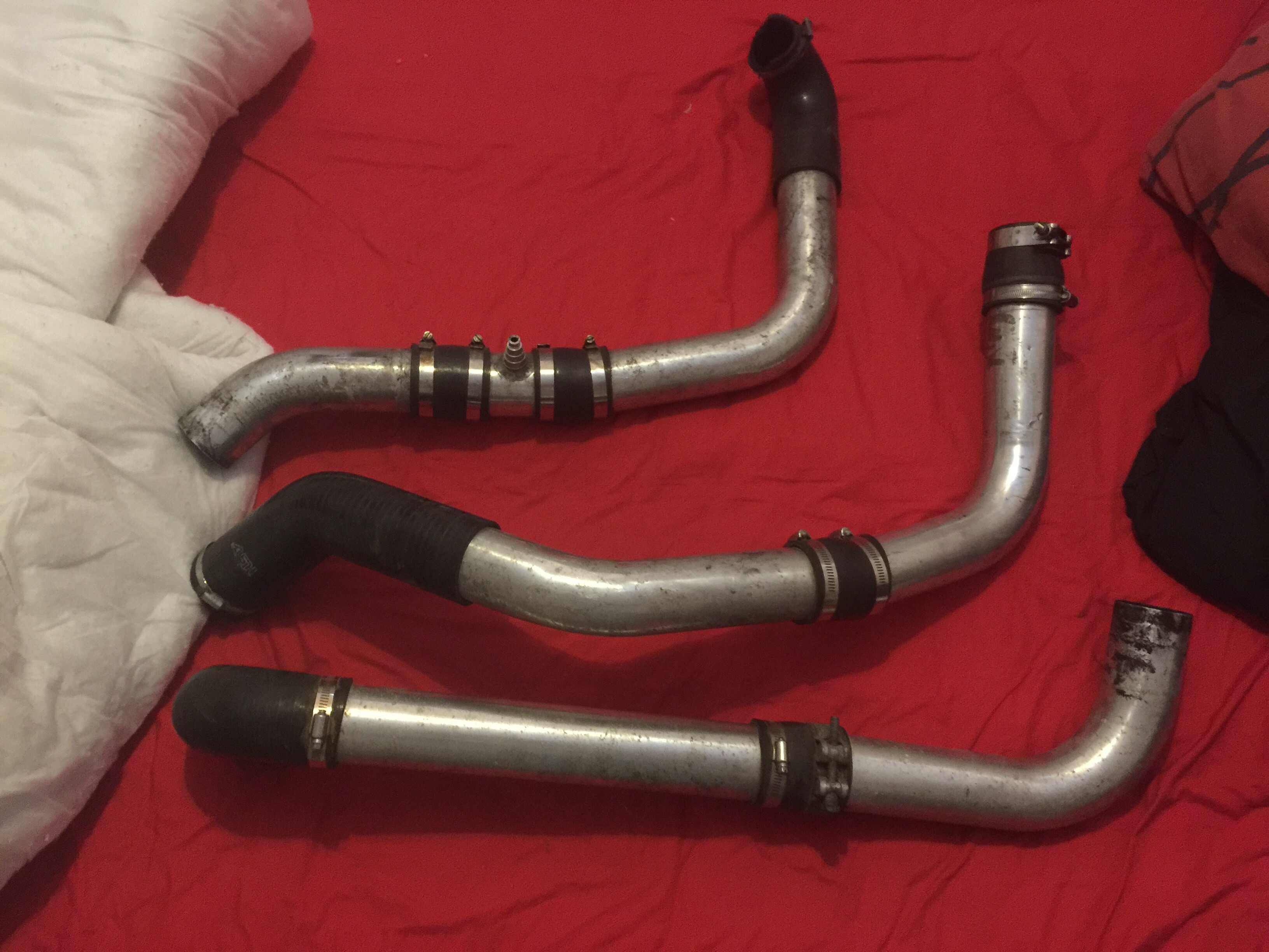

Omg that's exactly what I needed, yea if you've got any more pics that would be wicked. Did you buy a kit or buy the bits idividually and if it wouldn't be to much trouble you got like a parts list or are they all just 45 degree bends
(08-08-2015, 11:41 PM)blinkyeatu Wrote: Omg that's exactly what I needed, yea if you've got any more pics that would be wicked. Did you  buy a kit or buy the bits idividually and if it wouldn't be to much trouble you got like a parts list or are they all just 45 degree bends
I bought this off of the 306 D-Turbo Facebook page. I would put a wanted ad up on there before you buy new.
You have to make the kit up if you're buying new. That's a photo of just the pipe work. I'm pretty sure everything is there.
Ahh yea they do look abut custom I'll have to rinse A few post then Sad
