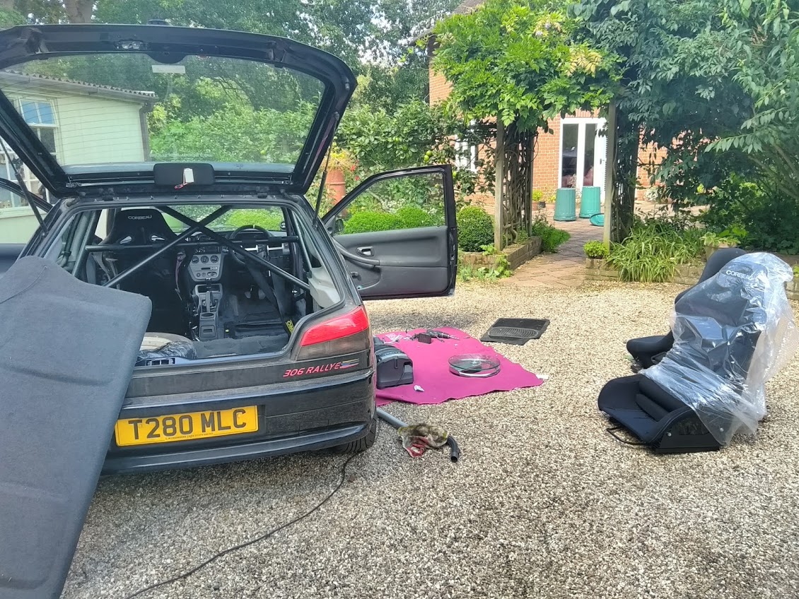

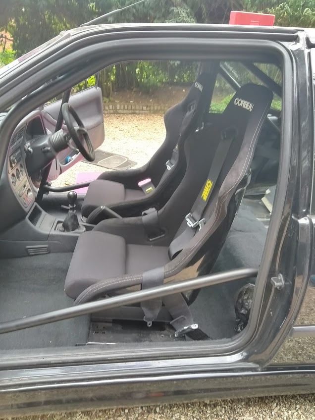

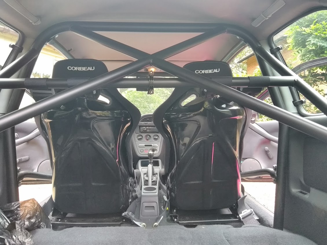

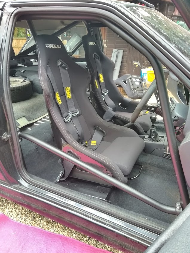

So the first thing that happened was I was sick of the cobra buckets. I sat in steves corbeaus and they were a lot comfier so I got onto a forum member who works there for some ace mates rates. Seats arrived along with a tow strap. Fitted those one day and now theyre comfy. Also saved some weight but I fear ive lost the numbers. I think it was about 13kg once the frames were out.

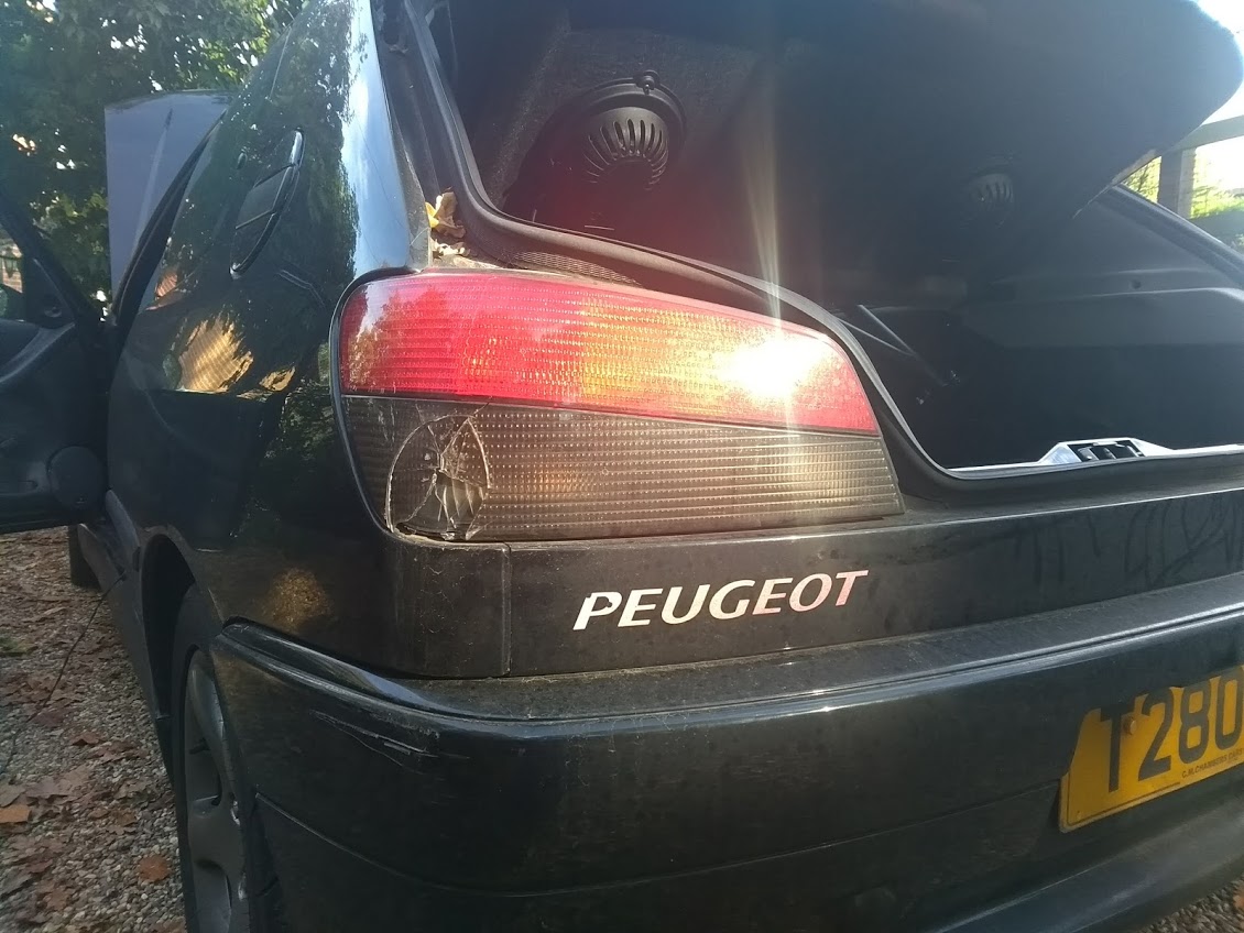

Dad also managed to smash one of the rear lights when he forgot he had panniers on his new bike. I replaced that.
