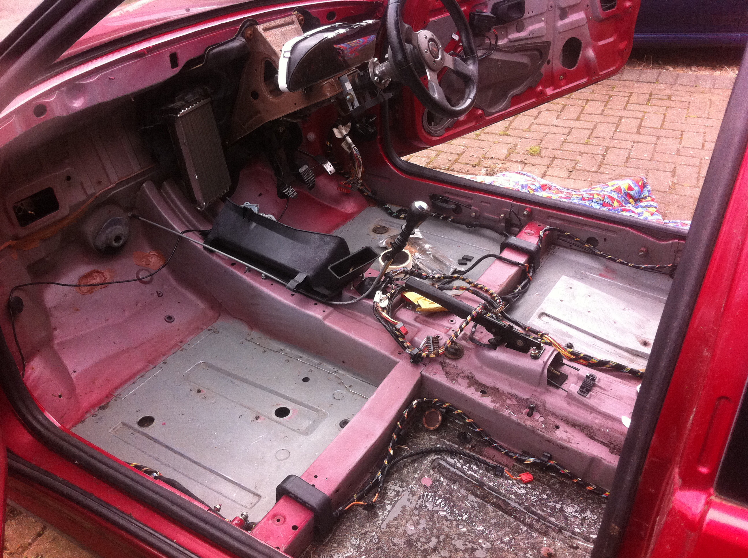

Started on stripping the interior out, all rear is done and now scrapping out the stuck on sound deadening (bits chucked back in for now)

Got a bit bored with the sound deadening removal so took the dash out!

Started pulling and cutting out the foam deadening from the firewall but again its very tedious!

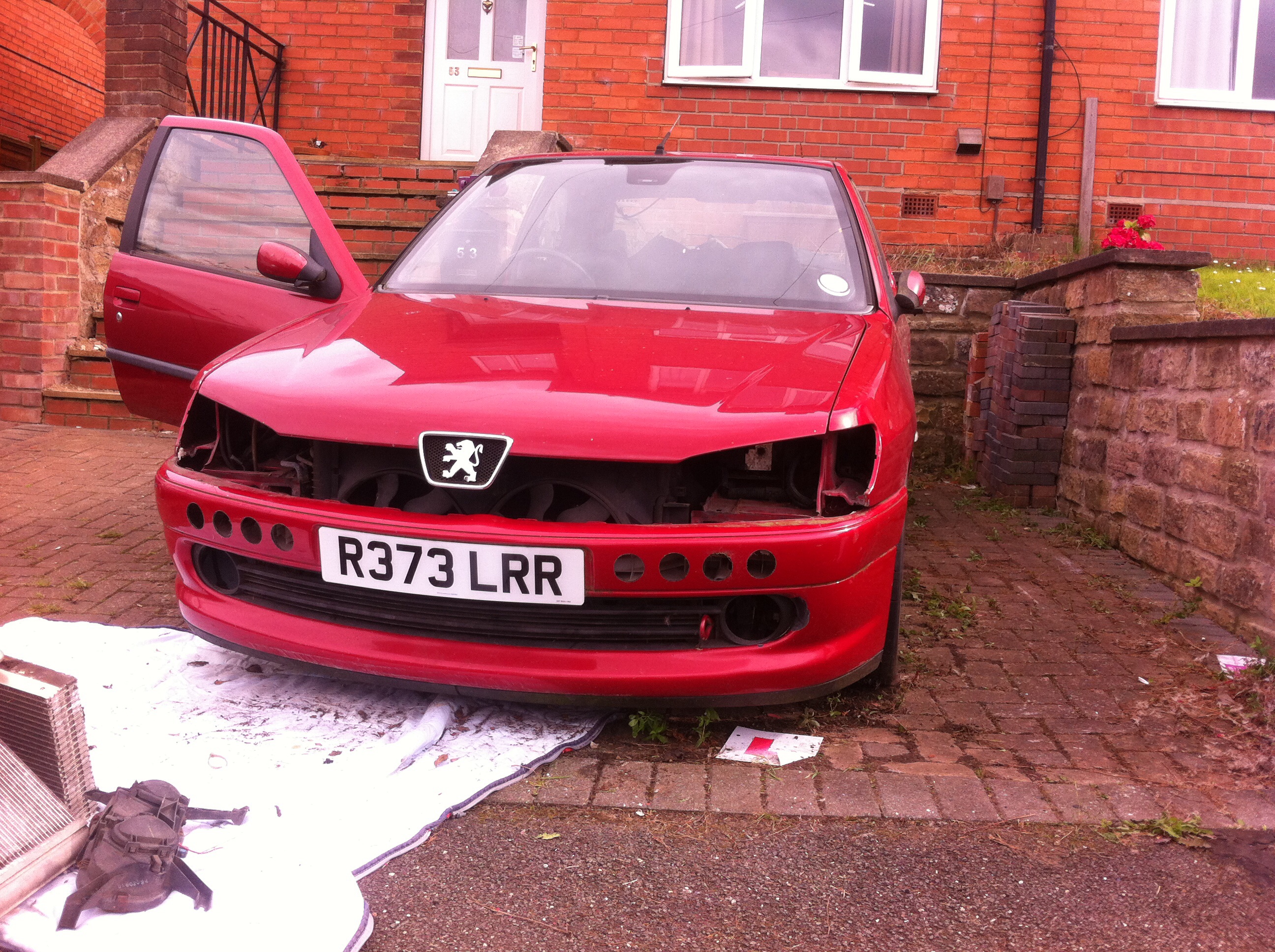

Took door cards off and drilled out the metal brackets and while the drill was still out cut some cooling ducts in the bumper and grille, didn’t have a big enough drill bit for the grille so they will be enlarged, bumper needs to come off to so I can cut out the “second skin” and whilst its off the fogs are coming out and fitting some brake cooling ducts.

Keep going, lots of weight left in it yet.... Not really sure what the holes in the bumper give you?

Hate you so much. ive been looking for a 3 door diablo for months. At least yours isnt a phase 3... Good luck with the project. Not keen on the holes in the front bumper. Ive got a few diablo parts if ever you need them.

Second that,should of just done it on the number plate.
also you need to bin them fogs,which will save you some weight

Holes are there for a bit of extra airflow.
Fogs will be coming out as mounting ducts from there to the front brakes.

So all sound deadening removed and tar residue cleaned up.
Dash out, some wiring removed (currently going through the looms), momo wheel fitted.

my suggestion is to move the plate onto the bonnet, then continue the holes across the gap.
