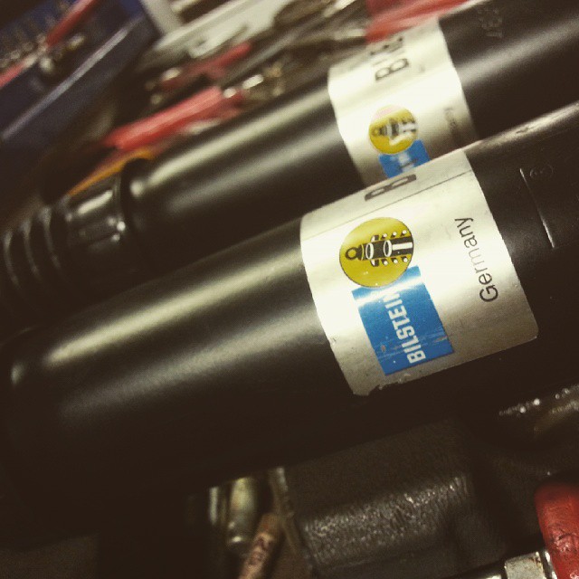

-Fully steam cleaned underneath
-Completely stripped front suspension
-secondhand Monroe shocks and lowering springs

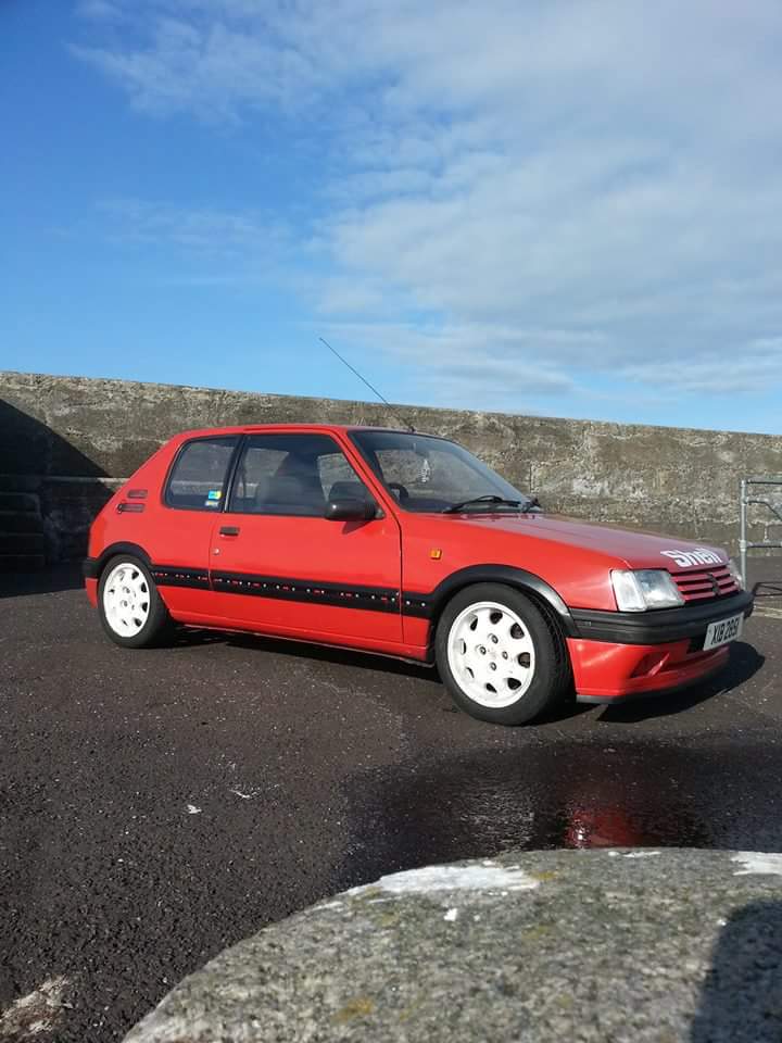

Before and after lowering the front. Rear axle rebuild imminent D:
Front suspension all greased and rebuilt. Brakes got the same treatment. And fitted up the splitter.
New inner cv boot fitted and then some shameless pics from yesterday.
I'm very happy with the progress so far, been flat out with a lot of late nights at it, only had it two weeks so it's had a mini restoration already haha. Next on the cards is a rear axle stripdown. There isn't any noticeable play, but I'd rather strip it down, inspect and tap in a grease nipple or two as preventative maintenance, it also needs dropped to match the front. The arches already scuff like mad but unfornately at the minute I only have have the rear gti arches, missing front ones and door trims so will have to acquire them and make some arch clearance courtesy of Mr grinder.

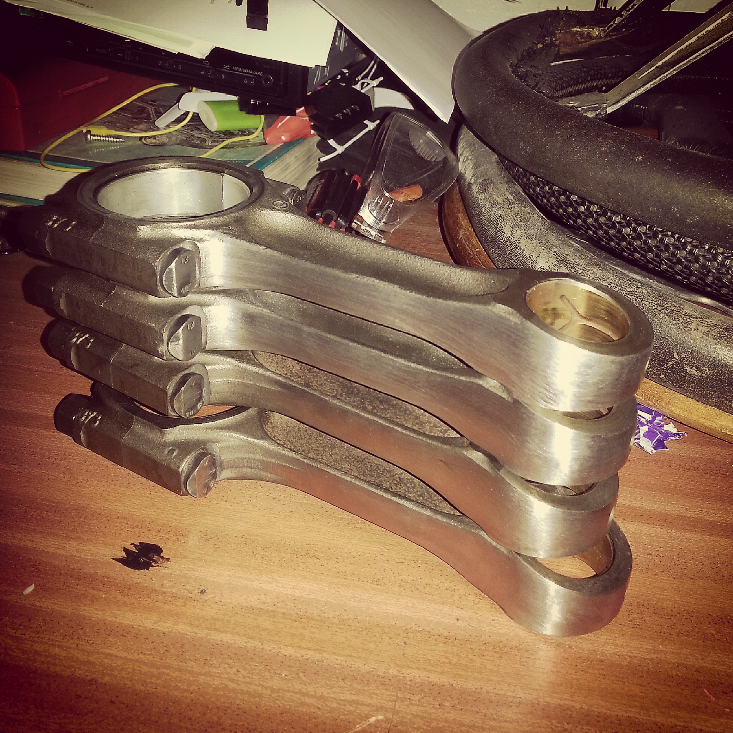

Hi zx volcane, assume you are Tom, I'm Aaron was talking to you about the rods last week!

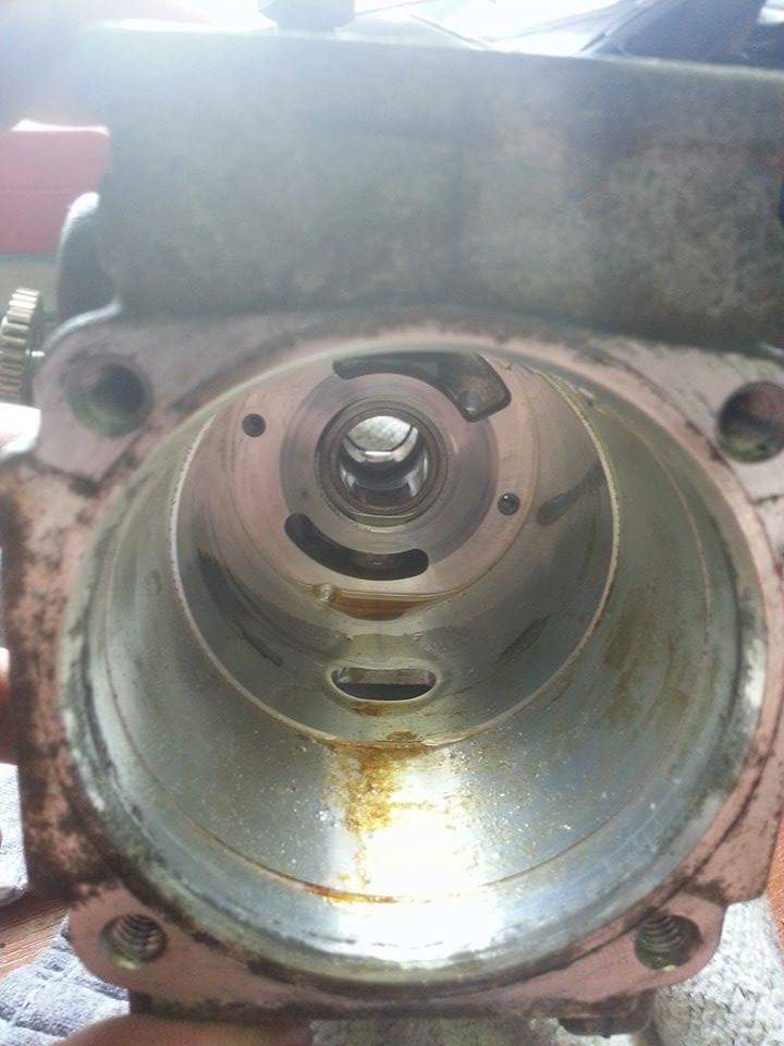

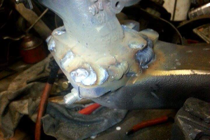

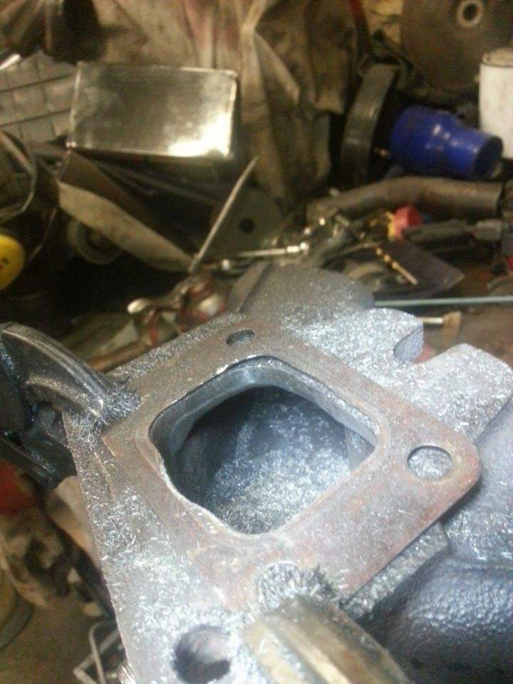

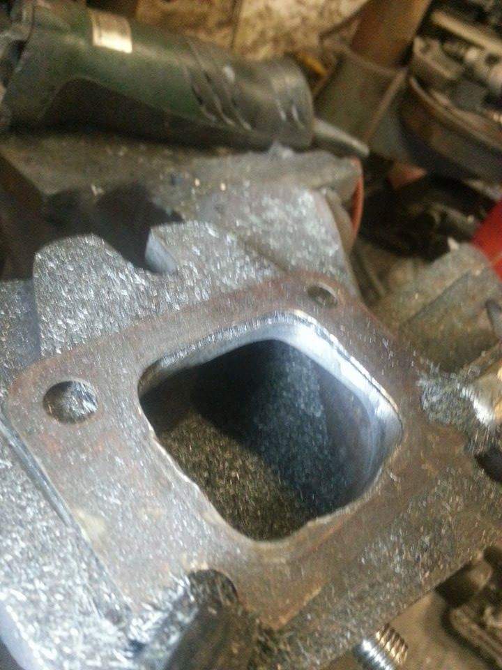

Plans enginewise are to put my tig skills to the test and fab up some manifolds of the exhaust and inlet variation.

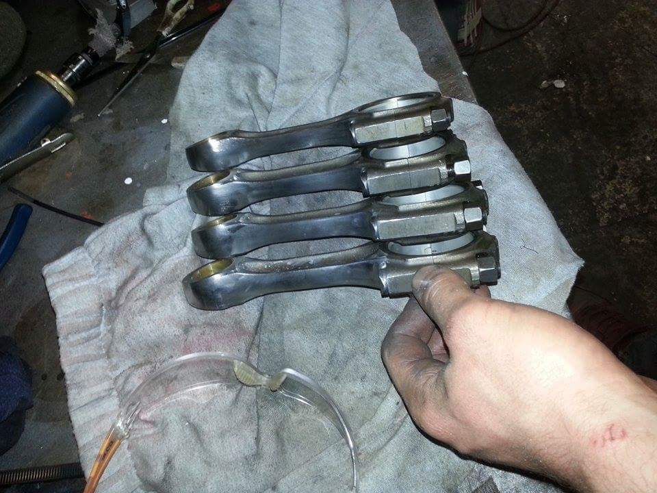

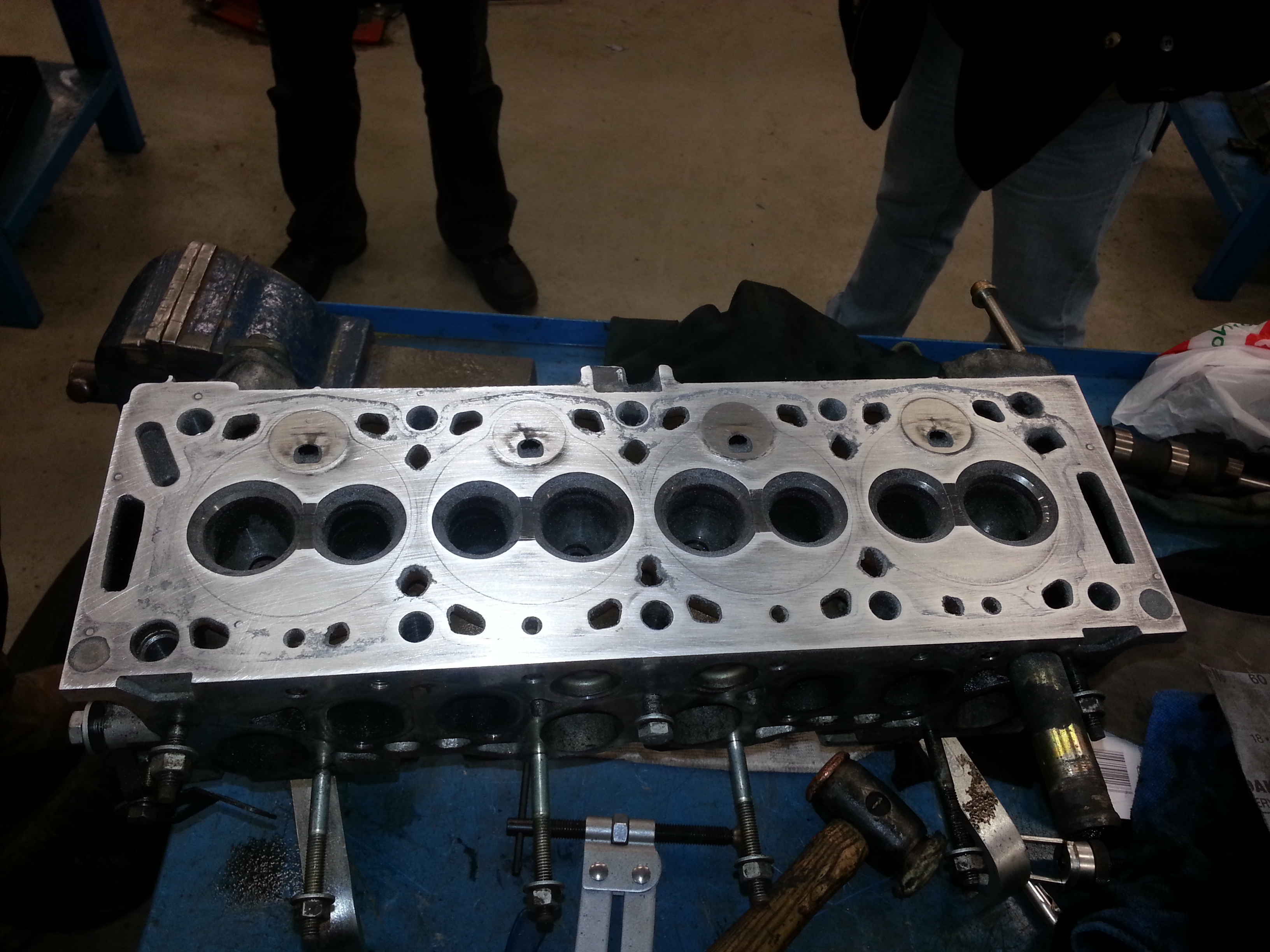

I have stripped and rebuilt a fair few engine so will hopefully get my hands on an xud9 to strip and rebuild with all the fancy bits. At the minute I'm trying to prep it for mot as I do plan to daily it whilst putting together a decent dturbine.

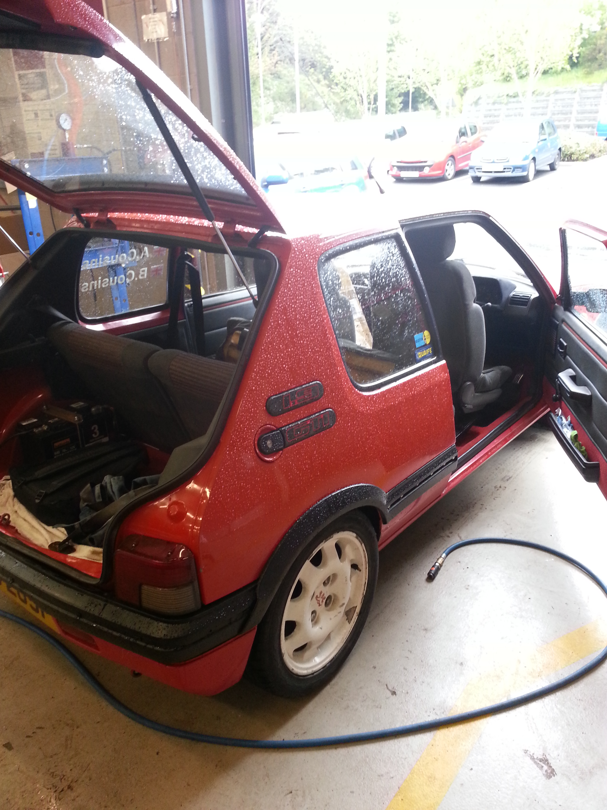

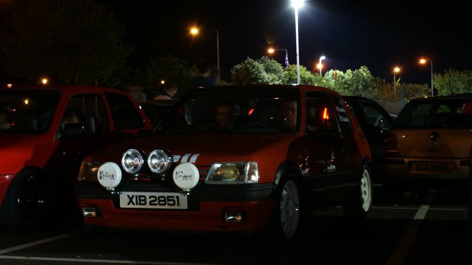

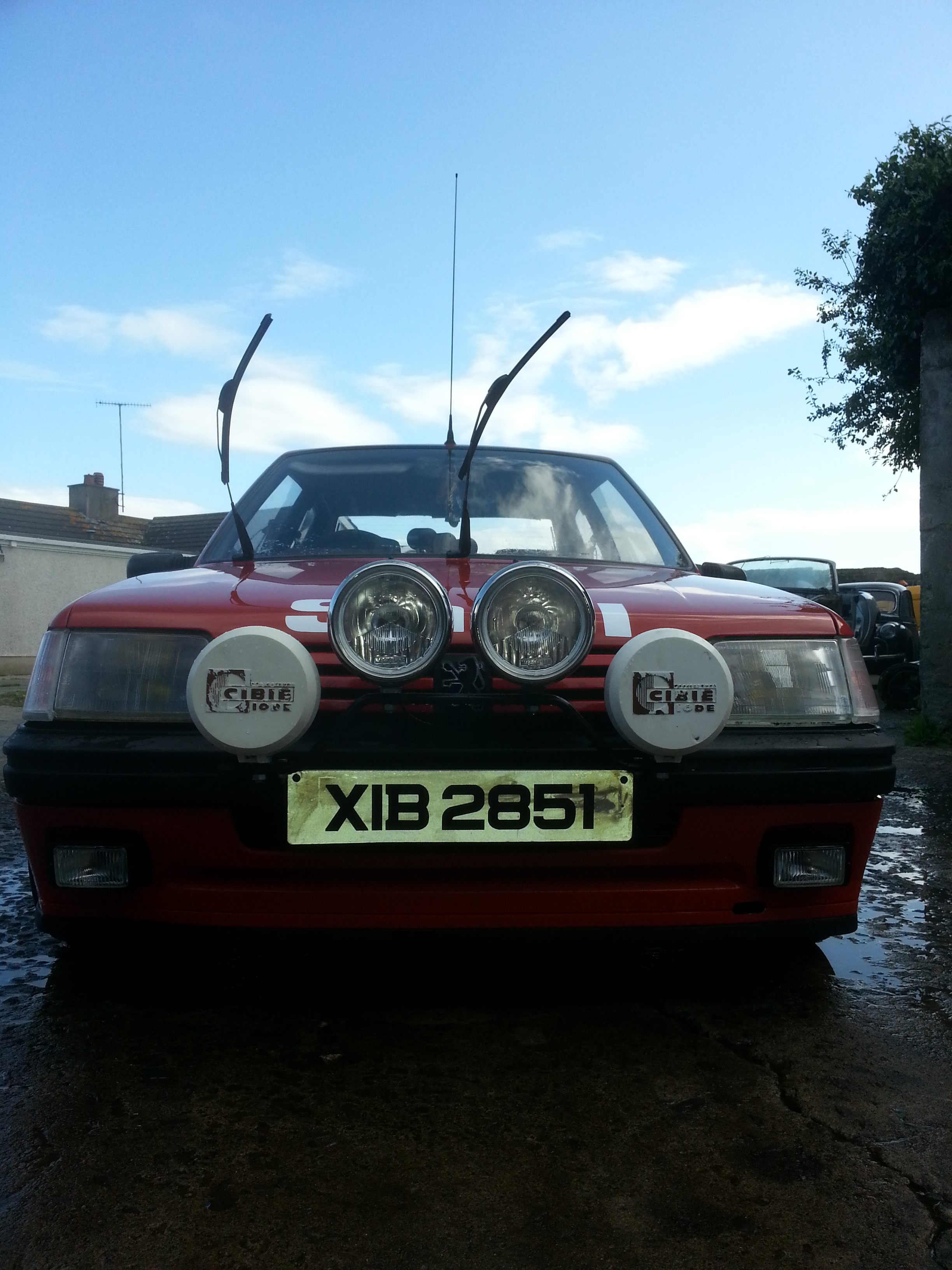

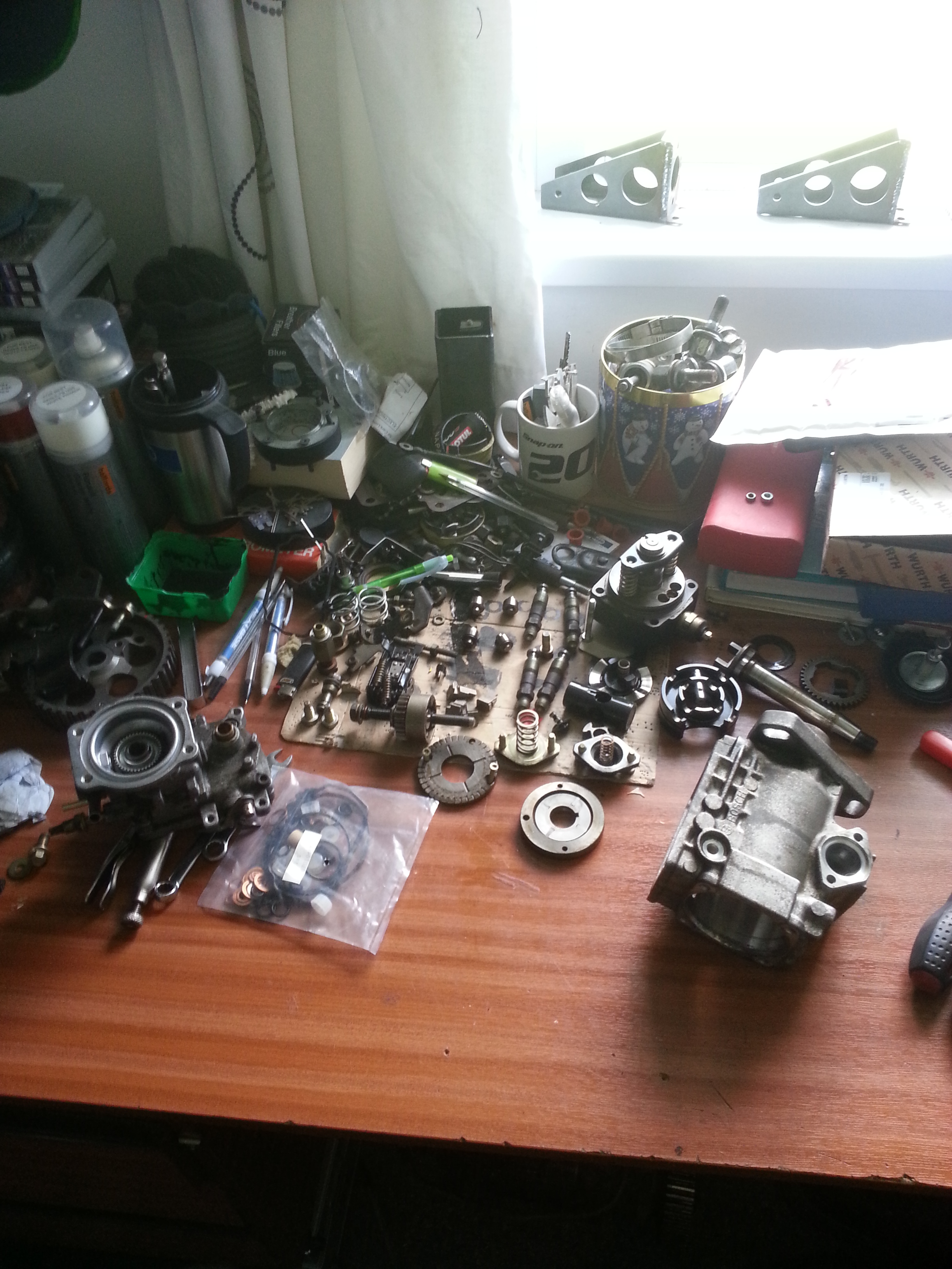

So a small update is in order. SoItme progress has been made, been struggling to get gone at it between work and other projects. But have been gathering some parts, bits and pieces for it.
Some fibreglass sparco bucket seats, unsure of whether to fit haha, need the power to back up the sort of statement you make by fitting them.
Cibie iode spots (going all out rally spec ) brand new ring roadrunner front fogs as the reflective backing on my own has gone brown and some nicer number plates with fancy writing haha. I got a driverside headlight off a mates breaker but unfortunately the sealer/glue around the lens must go off as it fell off in my hand. Not to worry, araldite soon sorted that. Replaced the one in it as again the reflective backing had corroded and would not pass mot.
I decided to strip the bumpers off it to clean in behind, prep for welding the inner guard at the front and to waxoyl in behind. Also because the bumper bolts looked seized to feck (they were) thought better to deal with the pain in the arse now rather than when I go to fit a huge front mount in the future
Got my cousin who does vinyls to print the shell writing (group b rally style) to cover a huge stonechip on the bonnet.
And found a graveyard where I acquired a very straight red bootlid with the black trim to replace the one the previous owner had used as an object detector.
That's all for now!

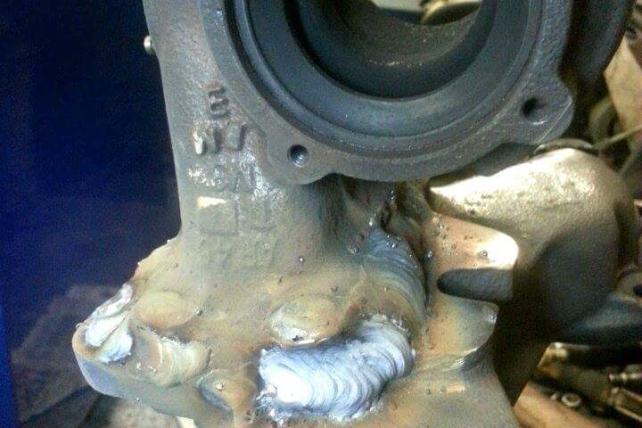

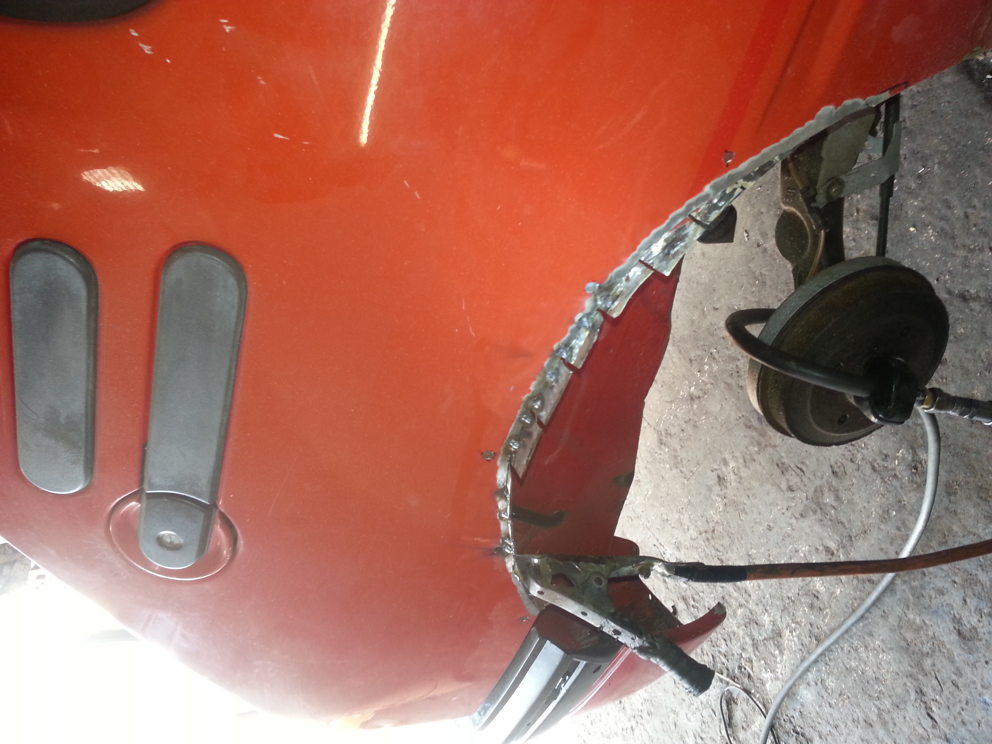

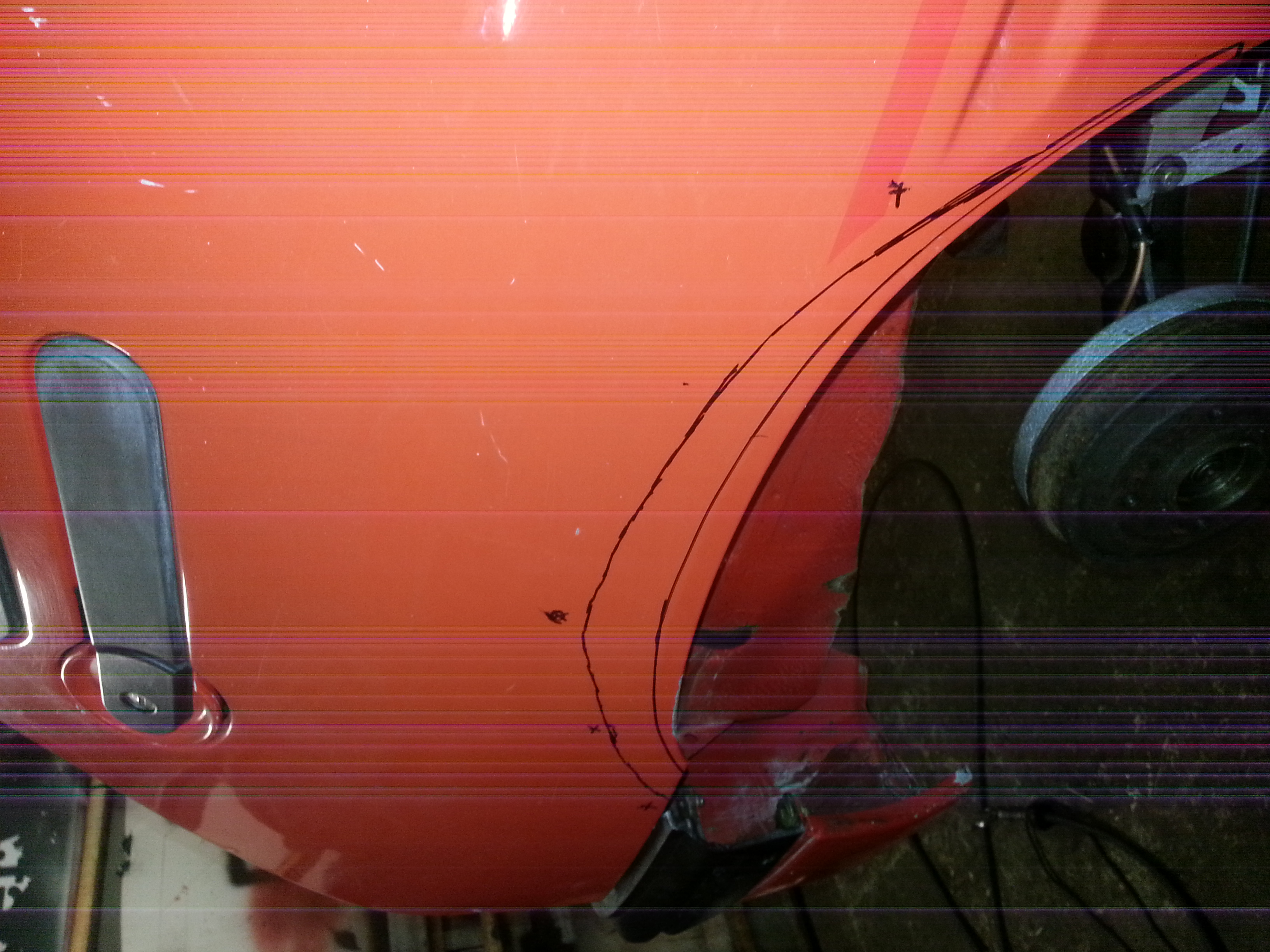

So another update. At 8.30 last night I thought it would be a great idea to begin sorting the rot on the d/s wheel arch between the strut and the headlight, a very common area for rot on 205s, I actually acquired the gti interior by sorting this rot on a friends 205 in exchange. Naively thought mine wasnt anywhere near as bad, until of course I started peeling back underseal to find the nice crusty stuff lurking underneath. I'm a great believer in doing it right so peeled it all back entirely and cut out every piece of questionable metal I could find. And then started rebuilding it with fresh 2mm plate, a bit heavy but nothing argues with 2mm ended up chopping out the front panel below the healthy and right up to the strut Tower. Rebuilt it in three pieces as it seemed easiest. Fully seam welded up top and in below. Awkward place to weld but took my time and finally finished at 2.30am last night lol.

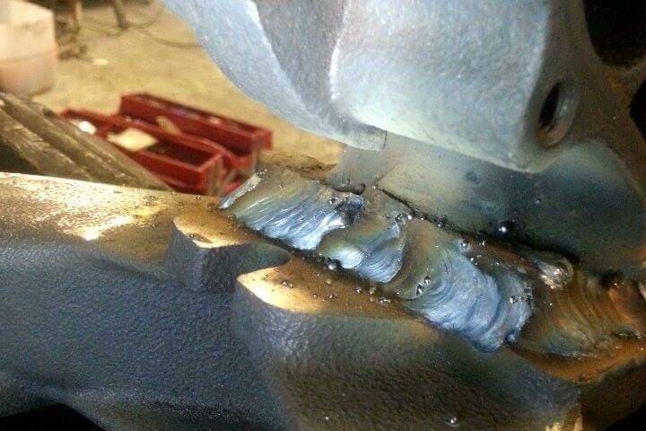

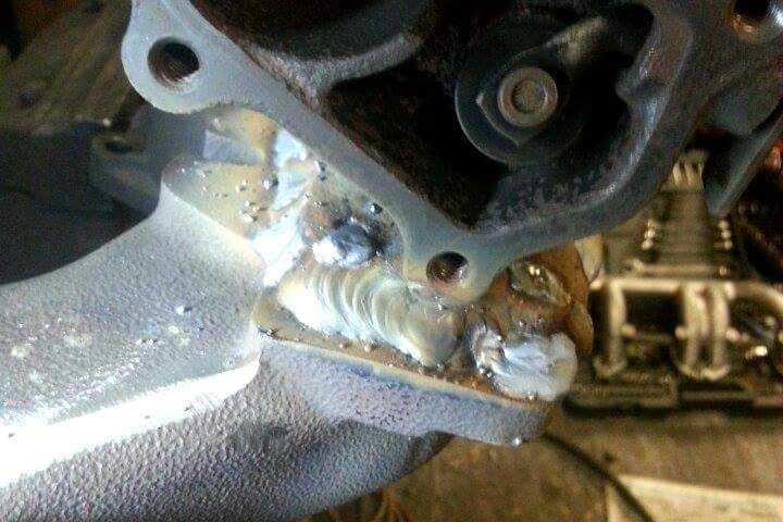

Just read this project from start to finish thats some of the best bodywork repair welding ive seen in a long time at least your doing the job right and cutting all the rot out when i was a mot tester some of the repairs i saw was unbelivable plates just welded over rotten sills etc.
Posts: 1,058
Threads: 18
Joined: Jan 2014
Reputation:
10
Location: Wiltshire
Car Model/Spec: 3 x 205 GTi & 306 HDi
Thanks: 3
Given 17 thank(s) in 17 post(s)
Good work, looks like a tidy repair. Flat that back, lick of paint and it'll be hard to spot it's ever been welded.
As you say, that's one area were most 205's are suffering rot these days, often worse than it initially appears as there's inevitably more hiding out of sight beneath the underseal.

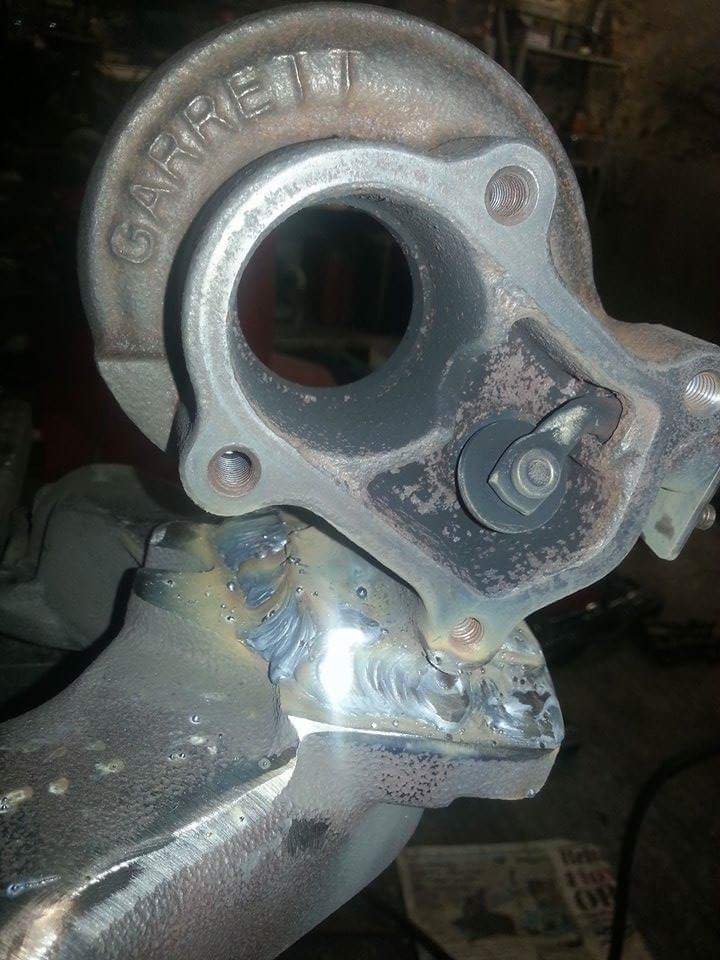

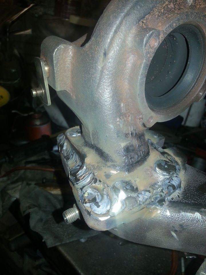

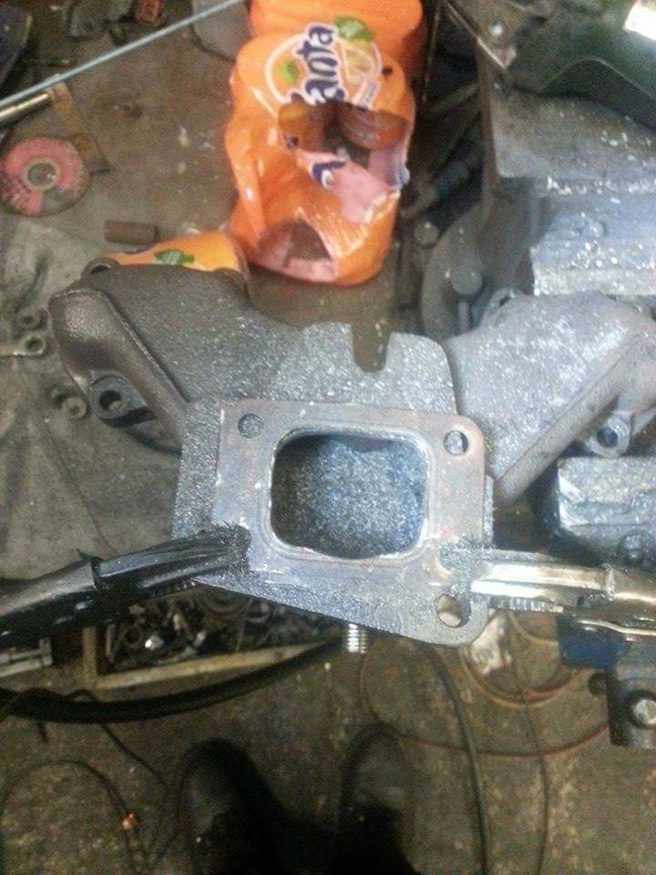

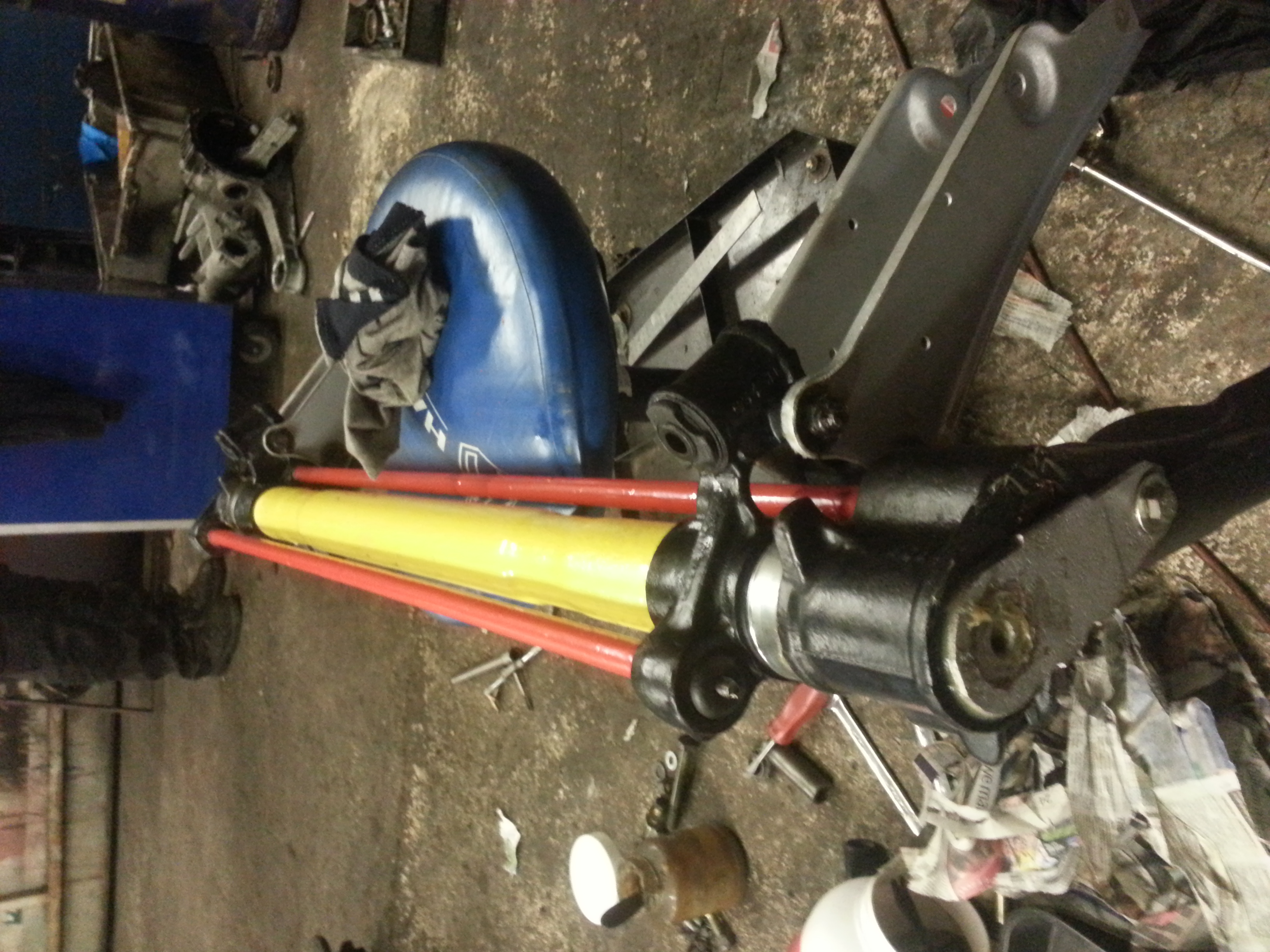

Plenty of progress since the last update. Need another laptop to upload it all mine is painfully slow. Next few days I'll post a big update

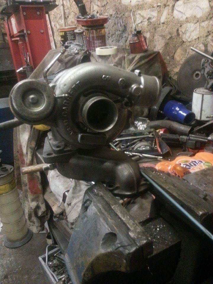

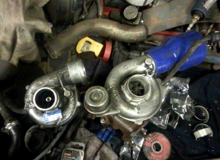

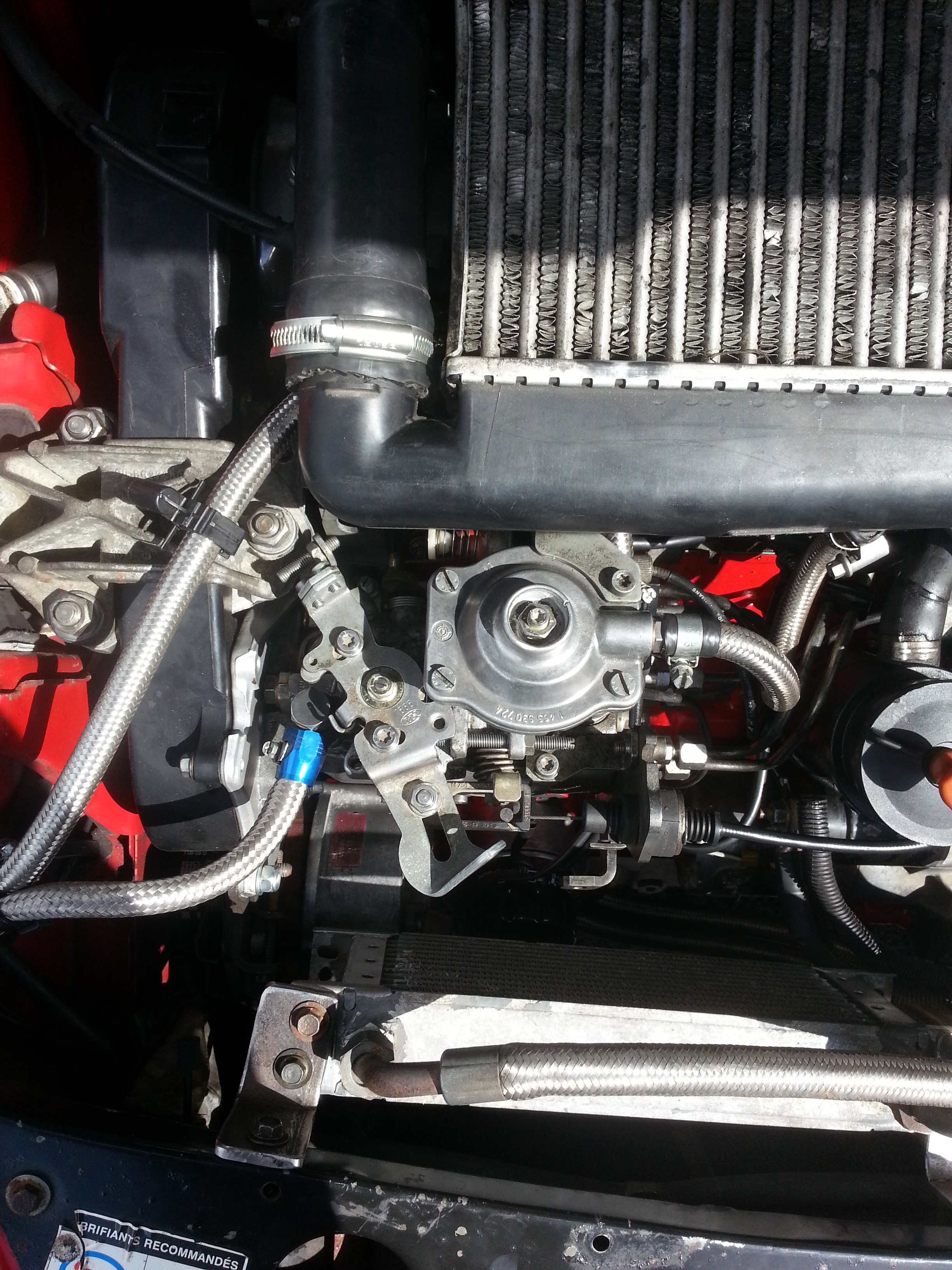

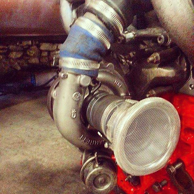

Love the project not too sure about the gauze on the turbo, gonna be quite restrictive I would have thought

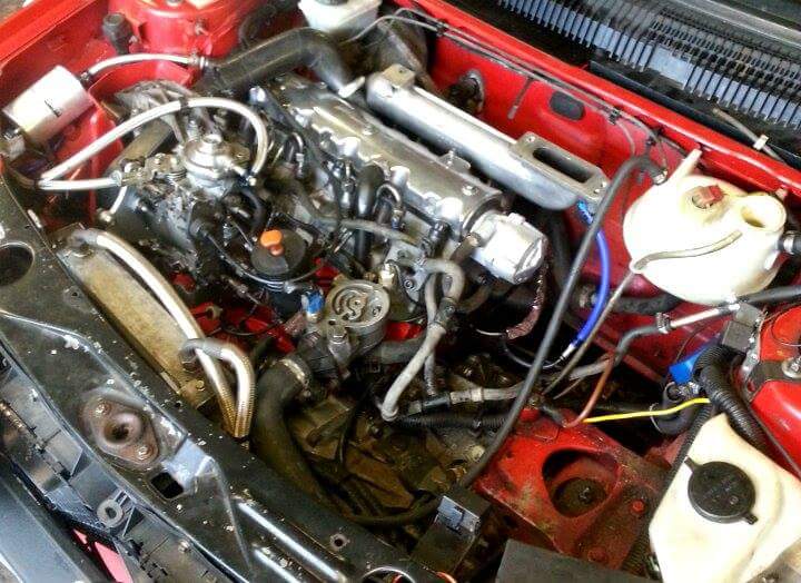

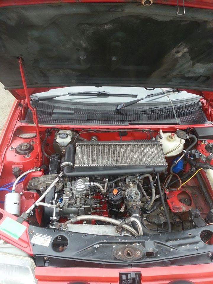

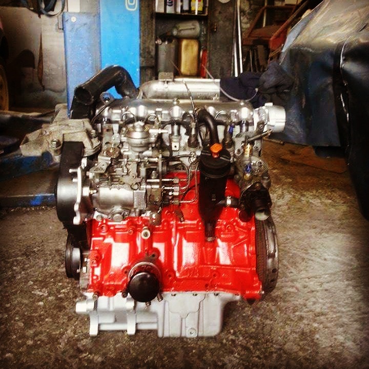

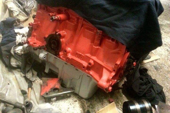

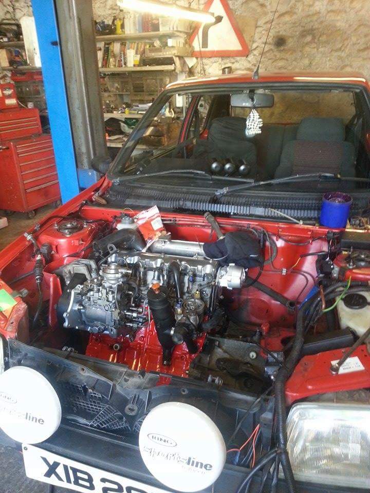

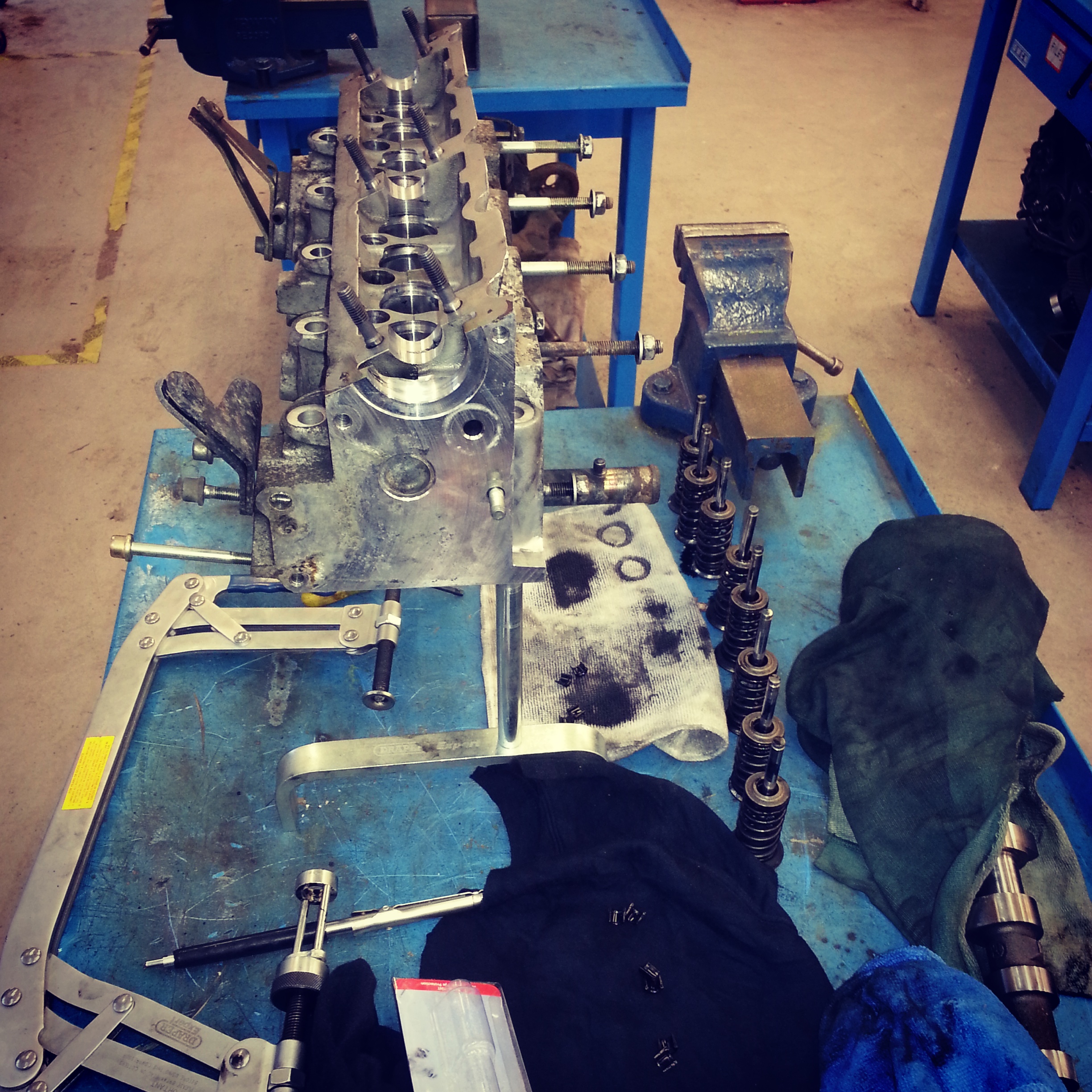

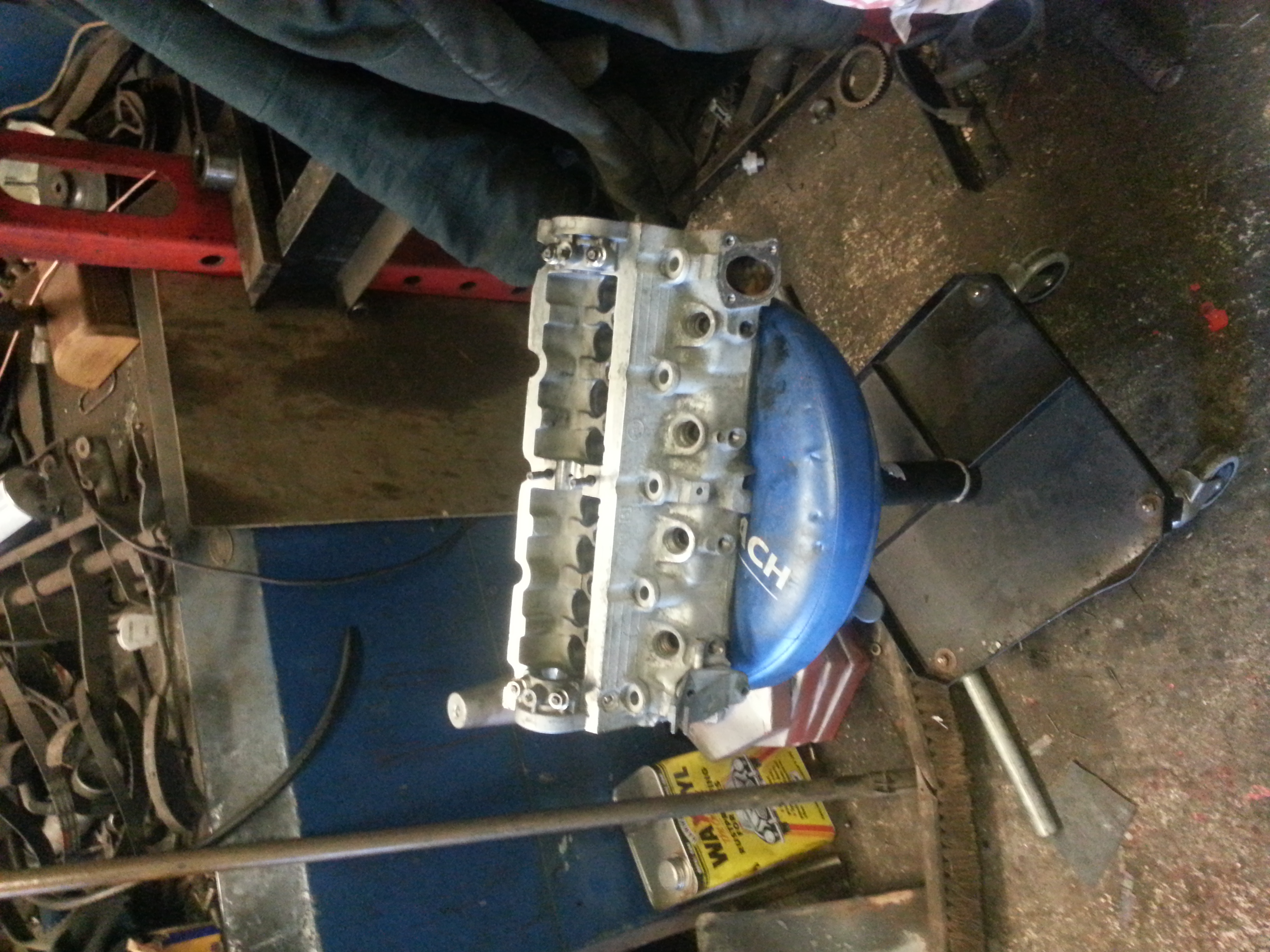

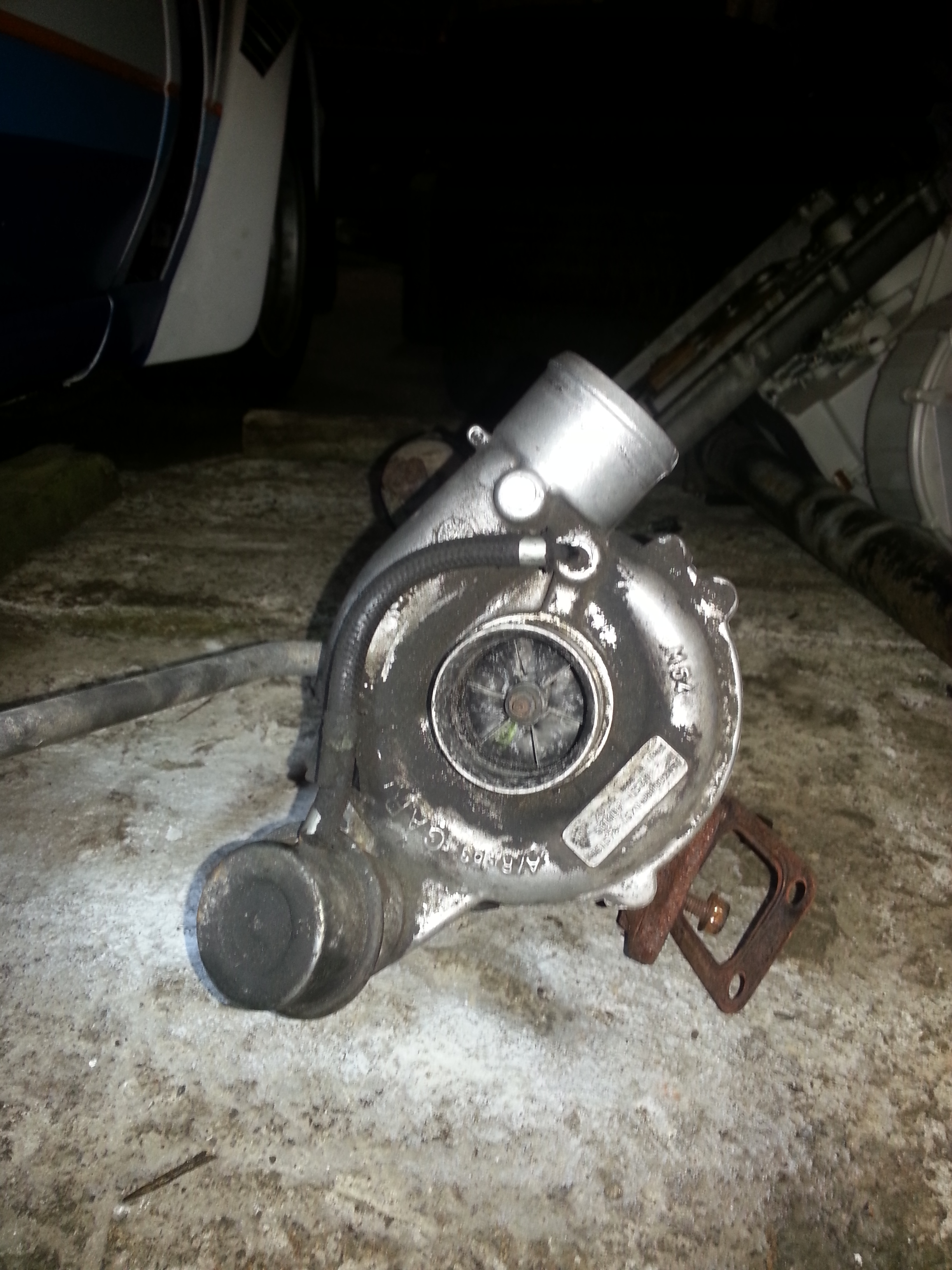

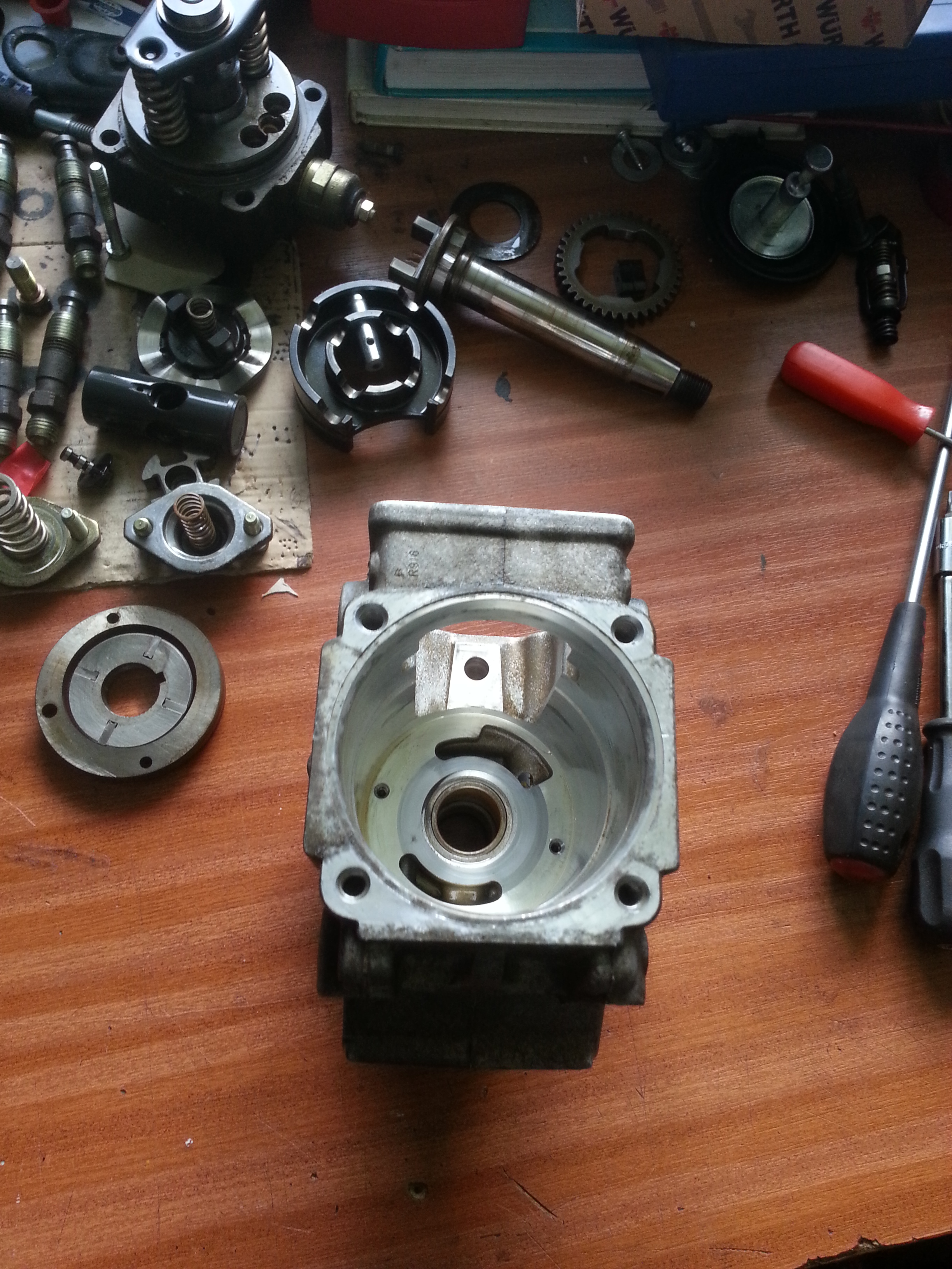

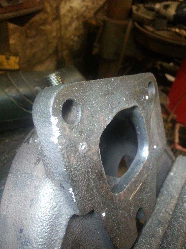

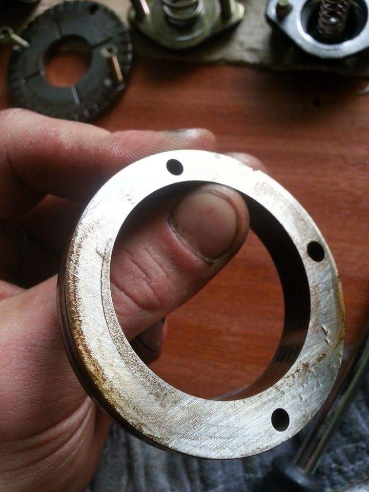

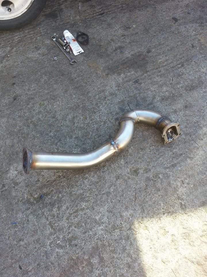

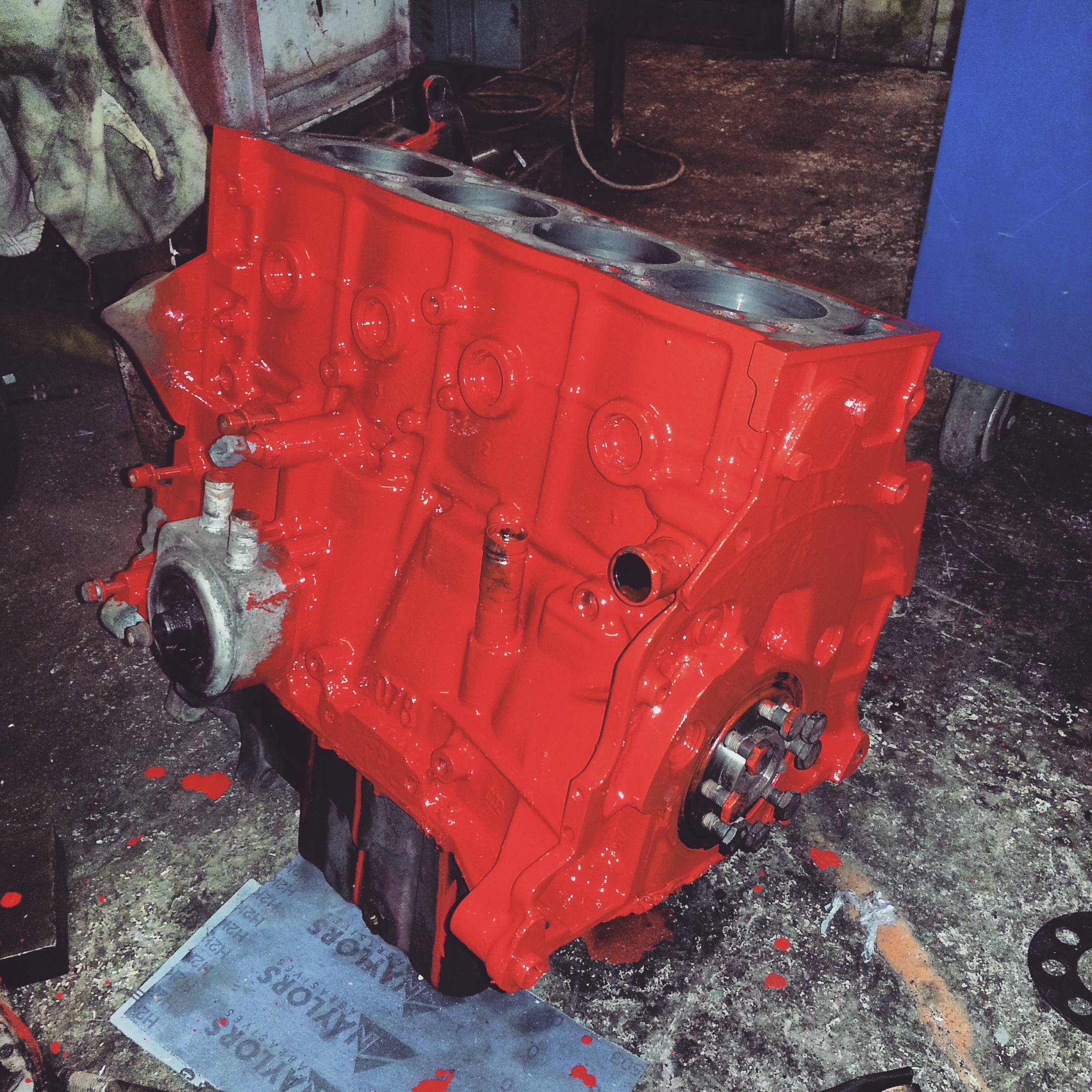

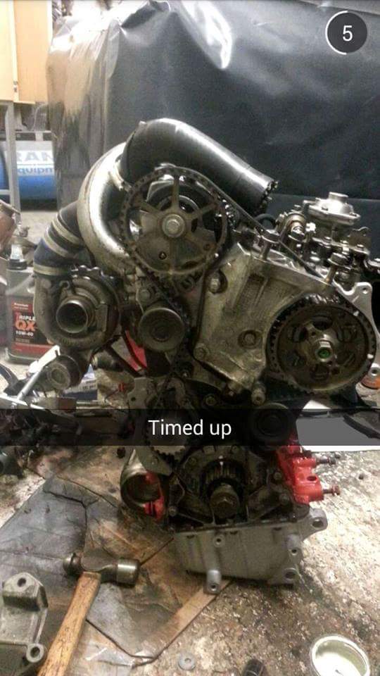

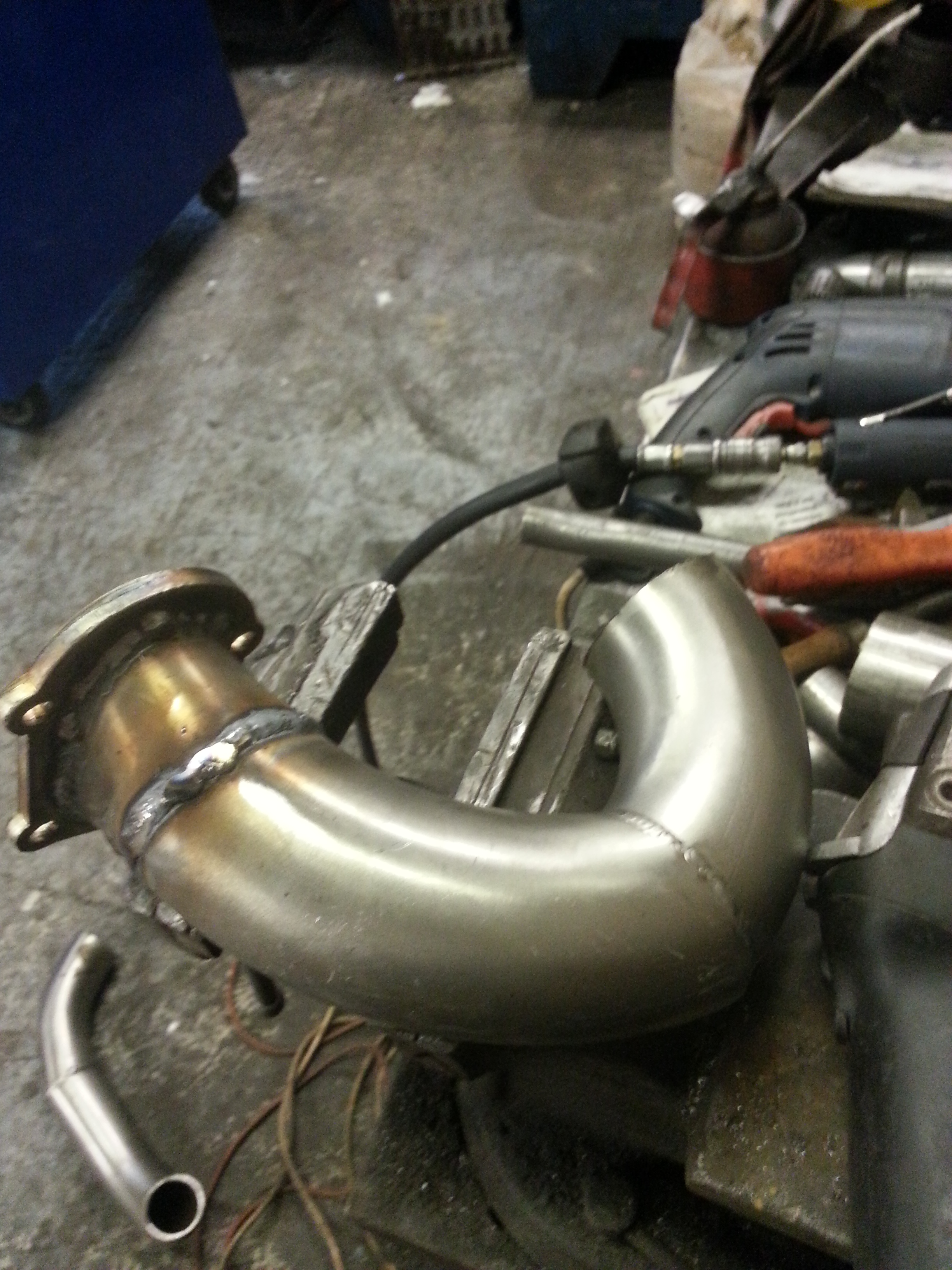

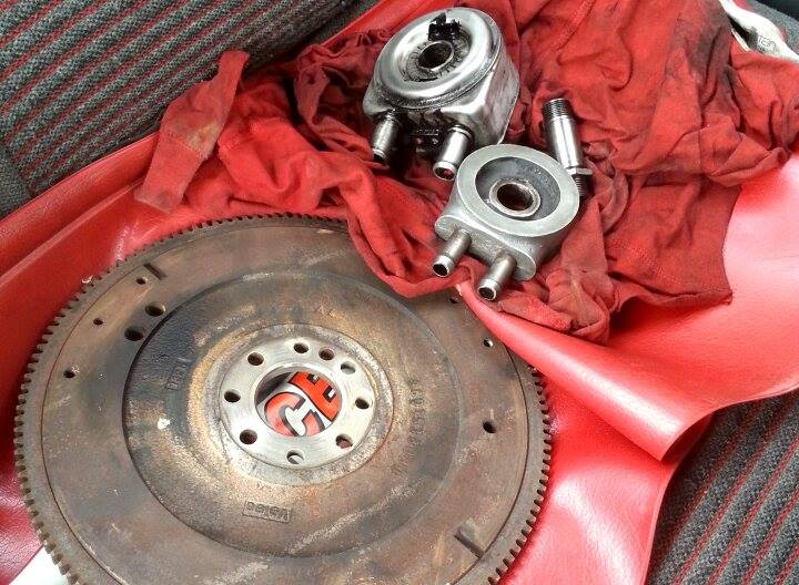

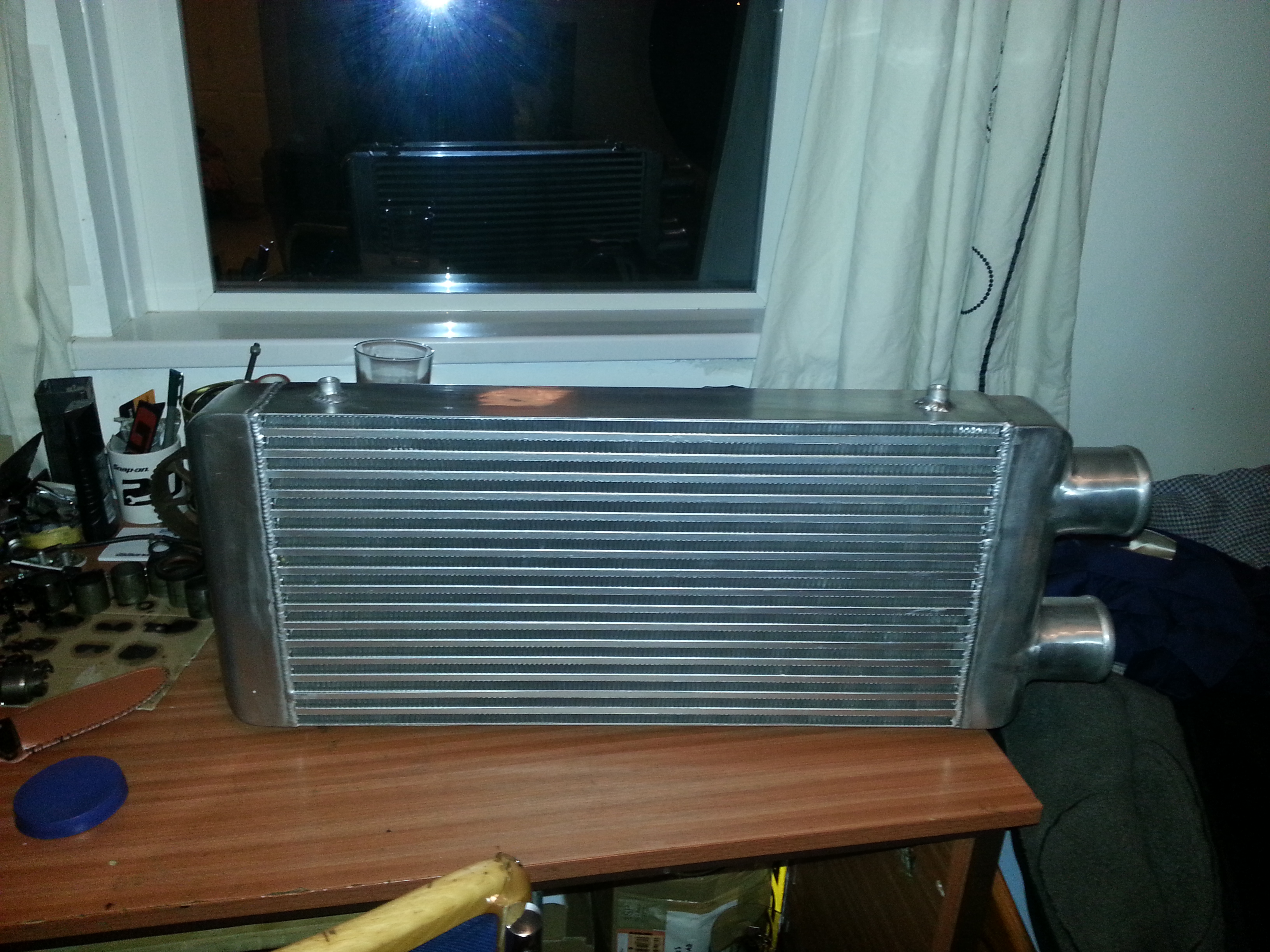

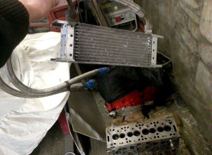

So the basic spec as it stands:
Engine:
-HDI rods polished with new big ends
-Lightened Flywheel
-ARP Headstuds
-Ported and polished head, valves lapped, all resealed
-13 row oil cooler, mounted behind rad, non-thermostatic, stubby oil filter
-9mm Bosch rebuilt and resealed, gov'd and LDA
-GT2056s mounted on non-egr mani, EGT probe fitted, running 19-20psi
-Still running TMIC, non-egr inlet.
-2.5 inch downpipe and straight-through to single straight through backbox
-266mm brakes up front
-Fully rebuilt rear axle, crying out for thicker torsion bars
-OMP lower strut brace, just purchased upper one
-Full gti arch kit and trim
-GTI spoiler
-Boost, volt and water temp gauges all TIM
-OMP deep dish wheel
-Full GTI interior
I have been away in England for the past 3 months, very much missing embarassing other vehicles with a 1980's diesel. I have loved driving this for around 5 months with approx 140-150hp. Maxed the 9mm with ease and burns clean as a whistle. The plan for when I get back is to upgrade to a 10mm pump, fit the huge twin pass front mount I have, up the boost to around 24psi, as well as fit the oil temp and pressure gauges, and aim for around 160-170hp reliably.
(22-11-2015, 10:55 PM)Mattcheese31 Wrote: Love the project not too sure about the gauze on the turbo, gonna be quite restrictive I would have thought
Temporary measure only! Managed the whole swap including full exhaust and downpipe fabrication within a day. I'm glad I at least went with the gauze judging by the things that have been stuck in it
When fitting the front mount I plan to fit a huge K&N I have stowed away. Proper filtration is the answer!

Where are you planning on shoehorning that massive twinpass?
Should go like a rocket with that setup!
Posts: 111
Threads: 6
Joined: May 2014
Reputation:
0
Thanks: 0
Given 0 thank(s) in 0 post(s)
(23-11-2015, 08:06 AM)zx_volcane Wrote: What a great project thread, loads of nice photos.
It sits level with a 155ish hp starlet at the moment. 160-170hp would be optimal to *hopefully* keep the rods inside the block.
Absolutely no idea where the twin pass is going lol, on the roof possibly. I should not be let loose on ebay. Probably should have gone for a smaller one but size matters haha

Given 1 thank(s) in 1 post(s)
Awesome photos & project. Just love the quad spot lights up front. Are you planning on rallying with it? I used to do "12-car road rallies" many years ago, good fun!
