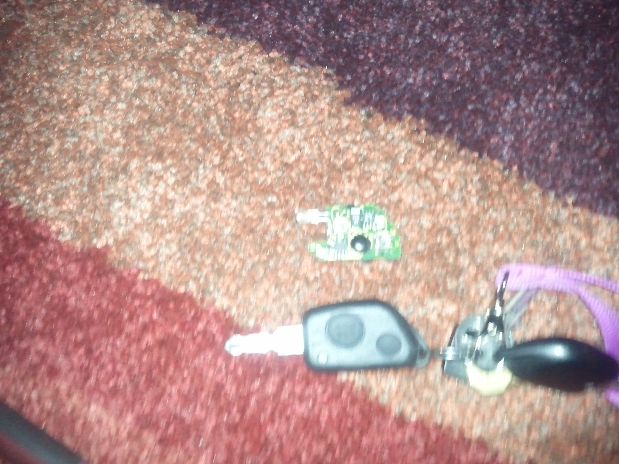

iv just been givven a key fob with buttons on Smile now does any1 know how to pair it with the car and if il have to change ignition to match key only want it to unlock?
first of all is in infra-red or remote?
secondly, you can change the keys easily - on the key there are 3? small screws, just take it apart, change keys over - done..

yea 1 screw lol but i could do it but how would i get it to unlock car iv got it in bits it has a led on it :S

fob n car
does it have an LED at the end??
is it phase 3 and what type of fob is it im rubbish with electrics Sad
yea it does
That is an infared remote, as the radiowave remote doesn't have the red led on top
Ph2 so infra red. Easy to reprogram.

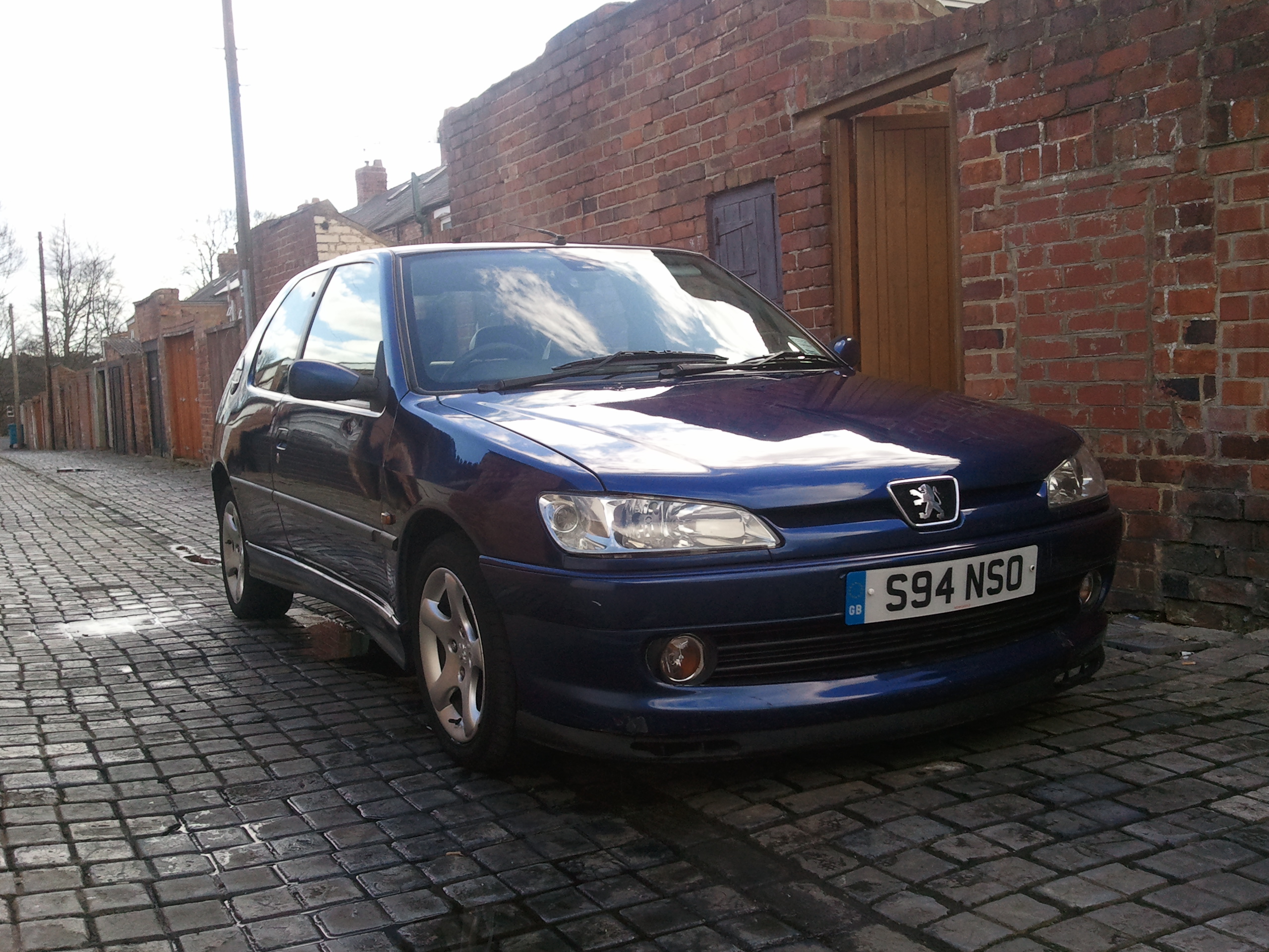

does it match my car?
brettw1 Wrote:does it match my car?
no... you've got a phase 3 car... the IR remotes are easy to install, but you have a phase 3 ( going from your pictures) which run remote fobs.

when did they change from a ph2 to a ph3? was it on the s reg?
kingy Wrote:when did they change from a ph2 to a ph3? was it on the s reg?
could also be a "custom" plate with few digits...
That car up there^^ is a ph2
if its just buttons you're after, either switch them over, AFAIK they'll swap out, and if not, you can get a set of the 'bay for around a fiver or summat
That car up there^^ is a ph2[/quote]
are u sure?
has the phase 2 got fuel cap on both sides?
what engine is it..??
is that a custom S plate / has it had a phase 3 front end applied?
i dont know either lol the front end used to be red might of been bumped :\ it has that rain sensor on the window?
Really a T reg '98 Ph3??...........with ph2 rub strips?! think about it, its just another ph2 pretending to be a ph3 as normal, another simple check, is it HDi? if not its a phase 2 Wink
It would also have the IR receiver infront of the light if its ph2!

i dont know any of its history either Sad
brettw1 Wrote:no d-tub
It also has the orange ph2 side repeaters, I would say that its almost certainly a ph2! you got a pic of the back??
Edit:- Ok seen it in the paint thread, it has the plastic strip along the bottom of the boot lid too so its not even a ph2.5 crossover car, its a ph2 100%
You got one of the interior light unit above the rear view mirror?

look on my 'paint' post iv just put sum up Smile
brettw1 Wrote:look on my 'paint' post iv just put sum up Smile
I know, see my above edit as you were posting lol
