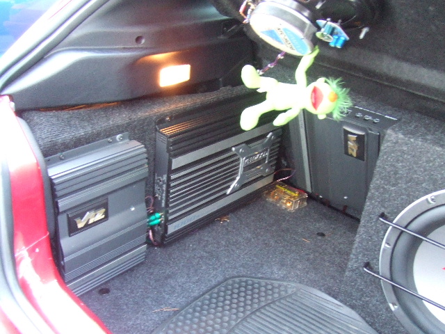

Where are you mounting your amps?
I've got mine on the n/s side of the boot but I'd like to hide them away behind the rear quarters (mines a three door).
An old pic of my install, it's changed slightly now.

(02-02-2013, 06:16 PM)DeeTurbo Wrote: He used 7mm stuff. I'm doing my boot tomorrow. I got the 9mm stuff though.
I used the 9mm stuff on mine, was going to take pictures but my hands were covered in spray adhesive haha!
I am fitting them on the back of the seats and then putting a panel to hide them and will be fitting fans to keep them cool.
