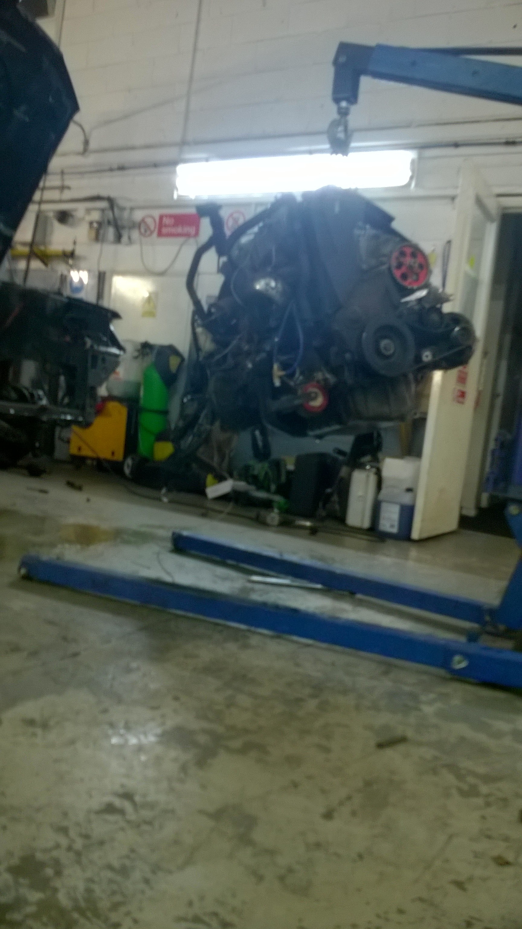

Engines out guys. Wink
New PB i think

Update. Building up a bosch for this and all i have is 11mm heads. FML. I want a 9 for once!!
So im back. Left workshop at 1.47 in the morning. FML ran into issues trying to bodge a bosch pump together for it out of salvaged parts. Fired up and drove home fine though.
Well done again... Smile
You doing engine swaps for fun now then? lol
(24-10-2015, 01:11 AM)bashbarnard Wrote: So im back. Left workshop at 1.47 in the morning. FML ran into issues trying to bodge a bosch pump together for it out of salvaged parts. Fired up and drove home fine though.
Glad to hear the engine is good Smile Hows the clutch?

No piggy this one was not fun. But i wanted to have a weekend off. Well after work till 12 today anyway. Clutch is fine. More than happy with it. Think the crank pickup for the revs needs replacing drops in and out on good known clocks but thats it. Everything else is spot on. So far done 26 miles.

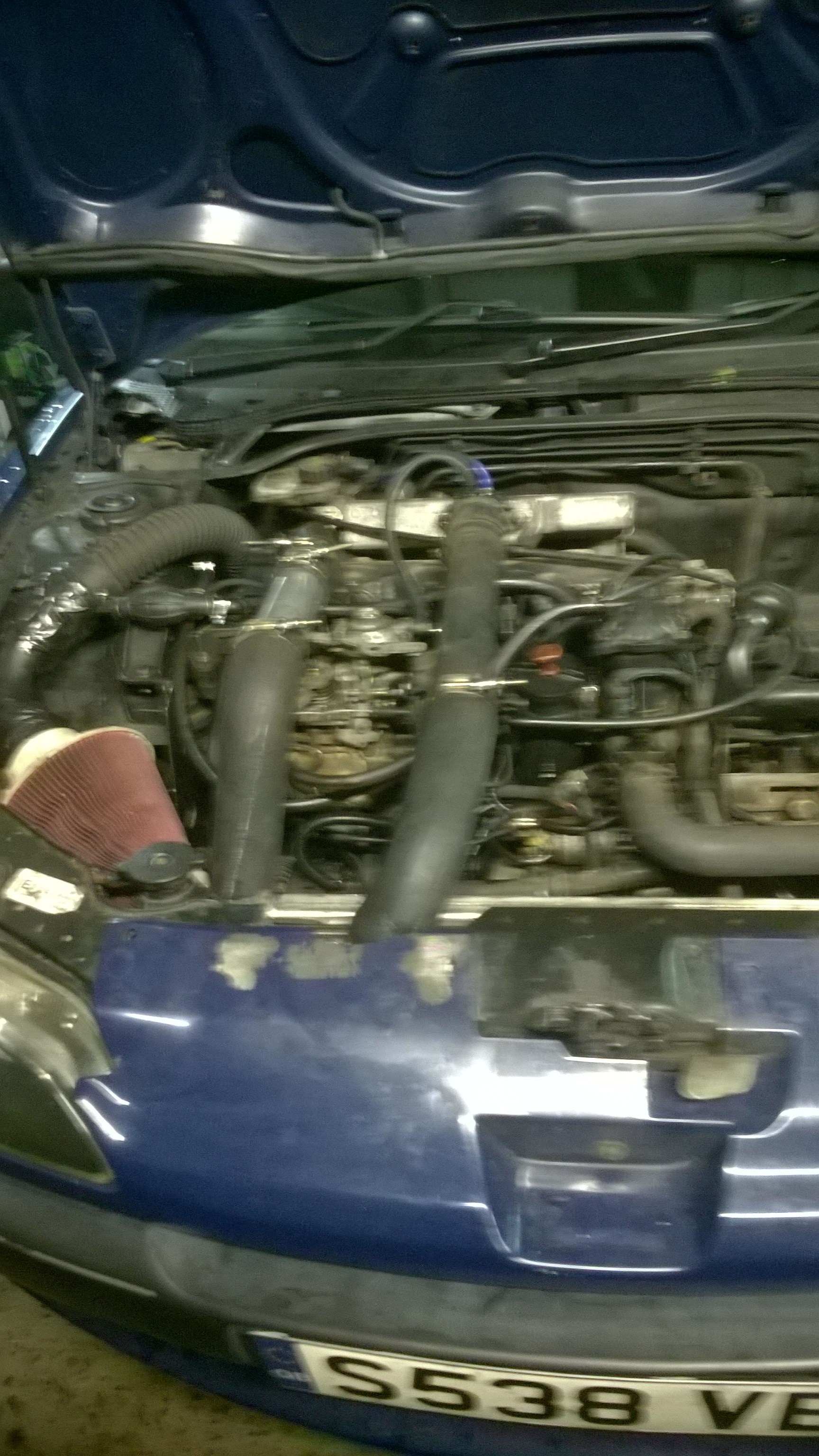

So tonight i got my "winter setup" sorted. 9mm pump back on. Thank god. 11mm was horrid on tiny turbo. Front mount fitted. New cambelt on penny mod on fuel filter for the ol veg oil. Lots of bodges and a huge snagging list i have. Air filter to sort. Catch tank to sort. Interior gauges to sort. Properly tapped in boost take offs. Rocker cover and gasket. Oil and coolant change probably got a few more things. But im happy with the power for now while i have my winter off climbing under the dam thing. You guys are just going to have to wait for the big boost for now.
Attached Files Thumbnail(s)
Nice to see that old engine living on Smile sounds a good winter setup with reasonable power
