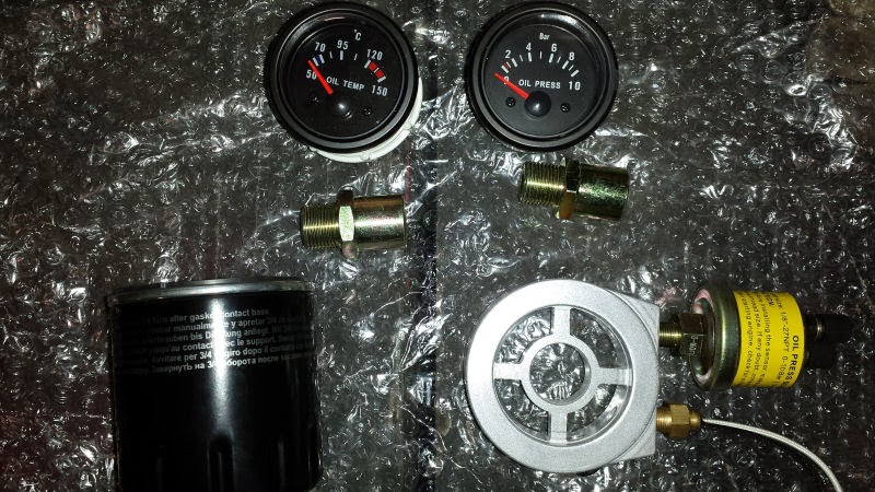

ok thanks. I bought this:
Oil Adapter / Sandwich Plate + Oil Cooler AN10 Connections
description:This adapter plate can be used to install oil temperature and oil pressure gauges, as well as turbo oil lines. Will fit most cars, as we include 2 different installation bolts: M20x15 and 3/4x16 thread.
Color: We send blue or silver, it depends on our current stock.

the solutions used
[Image: 20140131_170541.jpg]
[Image: 20140131_170929.jpg]
[Image: 20140131_171943.jpg]
