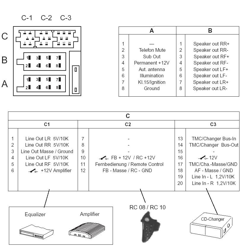

Now, my question is this on the C ISO plug is there an pre amp output? The ISO standard says there should be, if there is I'm thinking of using that for the amp if not I will have to use the high level input on the amp.
Does anyone know of a wiring diagram for the pins on the back of the headunit, I've been looking on google but couldn't find much.
MAYBE!
c1
pin1 out LR
pin2 out RR
pin3 ground
pin4 out LF
pin5 out RF
pin6 +12v amp sw
Yep, that's what I've found. I will have to do some measuring with an oscilloscope.
Haha, 5v pre out! I wish, that would be awesome if that was right.

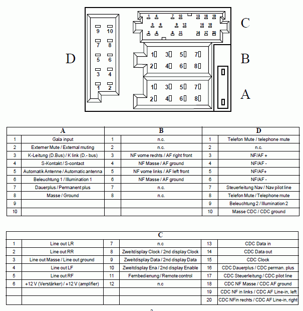

Any idea what size connectors you need to go on to the pins there?

Bugger, not what I was hoping. It looks like there is no pre-out on these headunits. There is 5v on pins 1 and 2, there is also 10v on pin 4 but no signals on any of the pins.
Looks like I'll be using the high level input on the amp.
