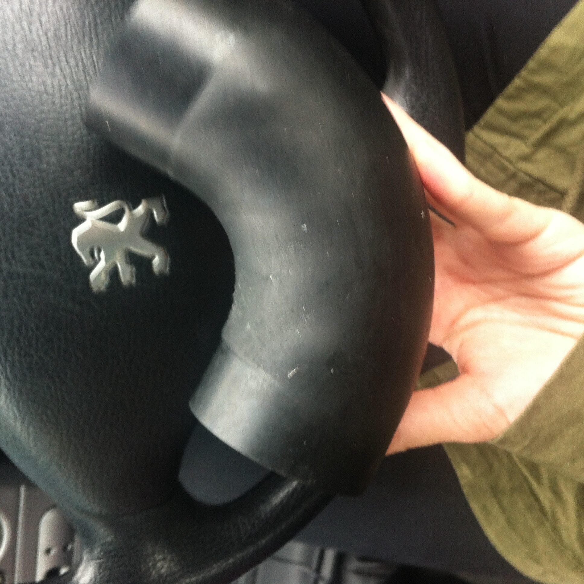

Fuel elbow thing
Wanted: Fuel elbow thing
Exclamation
Those were vaughans words as to what I need.
She failed her mot this morning on a front brake hose and this bloody fuel leak..
For a hdi
Pleaaaaaase help me, I have 10 days. Heart
I got mine from peugeot. Fun times ahead for you!!!
(08-10-2013, 01:16 PM)cpikey316_ Wrote: I got mine from peugeot. Fun times ahead for you!!!
how much was it from peugeot?
Cant remember, im thinking £30
(08-10-2013, 01:29 PM)cpikey316_ Wrote: Cant remember, im thinking £30
oh bloody hell, thats probably my best bet though! but i'm not paying a garage to do it, they quoted me £60+vat for the one brake hose that is a tenner on cp4l. Sad
I had to do this last week.
wheel off
arch line off.
10mm nut holding fuel filler on
then undo the two clips holding the pipe on a twist and pull!
worth making sure its jacked up high to avoid loosing fuel
1- Wheel and arch liner off
2- Pliers are needed to get the awful clips off (those squeezy ones) no need to take the side skirts off
3- Look up in wheel arch, then remove nut that holds funny grey thing (fuel pump housing or something) onto arch
4- Remove black what appears to be breather hose from the white tube (at 3 o clock on the wheel arch, by the side skirt)
5- Pull fuel elbow off, catch fuel in container (lower and raise car with jack to get as much as possible out!)
6- My next bit of advice would be to throw the silly clips away and use jubillee clips to refit the new pipe, and id get a little one for the breather hose we took off in step 4
7- Slacken 2 bolts on passenger side (one near the rear wheel, one near the exhaust) and remove two bolts on drivers side (one in the middle of the car, one near the jacking up point, when you look underneath the car youll see the frame that holds the fuel tank up) Contrary to the haynes manual, i didnt remove the handbrake cable or exhaust to do this
8- smear fairy liquid around inside of both ends of new pipe, then fit to fuel tank, wobble funny grey thing to get it off the bolt, then line it up, so you can fit it onto the new elbow while turning the elbow (this part will be obvious when your doing it!)
9- apply new(or old) clips to pipe and put it all back together!
10- Enjoy car with no fuel leaks(hopefully!)

lol fuel elbow thing lol filler neck?
Replacing it isn't a huge task in fairness, it's just a PITA getting everything to fit again once it's out! ring peugeot amie and get them to quote you for the filler neck; i assume this is what's broked anyway rather than the silicone elbow which joins the tank>
Thanks guysssss! i'm sure vaughan and ginge will love the guides :p
i thought it was the silicone elbow, but i never let the garage check because i had work. might take it to the garage on my road and just be like "uhhh i have a fuel leak, pls tell me where from" and then never pay them to fix it... i mean i've never done that before Itwasntme
(08-10-2013, 05:59 PM)ginge191 Wrote: lol fuel elbow thing lol filler neck?
No Ginge, fuel elbow. They all leak after a while.....smartarse!
Amie, i would sell you my spare one but Piggy nabbed it lol. Want me to get a price off of Service Box?
Edit: Did it anyway. £36.08 from pug Sad

The guy even made a point of saying its definitely the right part it will just be a nightmare to fit Doh
They really arent that bad at all....wheel off, arch liner out, 1x 10mm bolt off that holds the filler neck in place, undo the clamps and remove old one (having BFO bucket underneath to catch precious fuel) then fit new in reverse. Half hour job maximum!
