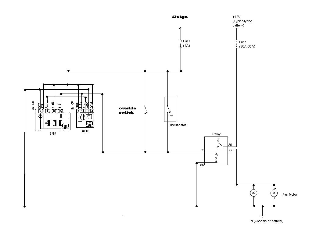

now to confuse you!
this drawing use's the timer relay and button for the demist

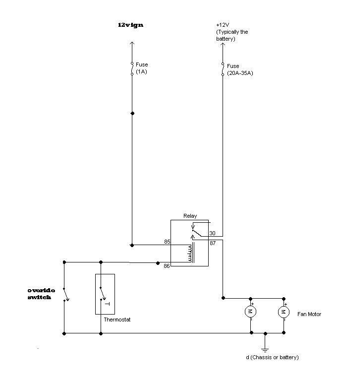

personaly i think its a bit OTT
personaly i would ditch the timmer idea
it would be easyer wiring it like this
Thanks Cully, as you say, the simple switch without timer will be easier. I didn't think one on a timer would add quite that much complexity to it all.
What size relay would be needed? I see it says 25-35a for the fuse so something matching that would be adequate?
you could use the original pug green relay or the brown one
as for the timer you could do it easyer but you would have to source non std pug parts
which would be hard to replace if they went faulty
