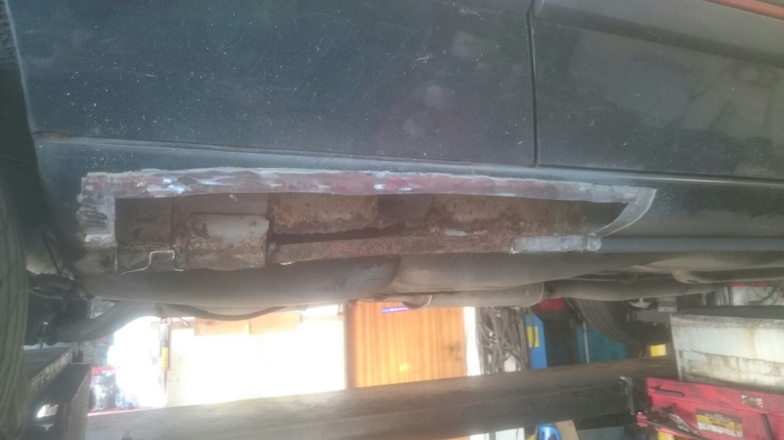

Unfortunately while i was under the car i spotted a couple more issues. The front tyres are down to the wear markers, that's already been sorted with some lovely new ps3s. Of more concern was the rather large bubbly patch on the sill, which i pressed with a finger in the vain hope that it might just be a paint bubble... It wasn't, my finger went straight through the sill with ease and on closer inspection it's pretty severely rotted in that corner - after a thorough poking it seems the sill is almost completely split from the body and floorpan panels for best part of half a metre and is developing a lovely hole up further up the sill. I would ignore it until i take it off the road, but the mot is in three weeks and while my tester may be friendly he's not daft enough to let that go. Rolleyes
Hopefully i'll have some better news for the next update, i'll leave you with a picture of the moment i found the slight hole...
This made it through another MOT successfully on Friday, the only problem was dirty contacts on my number plate lights. Jonny kindly fixed up the slight hole (which was a much, much bigger hole by the time we'd finished poking it) and she was good to go. Put the tracking gauges on yesterday morning for good measure; she's now a real pleasure to drive. Almost... lol
