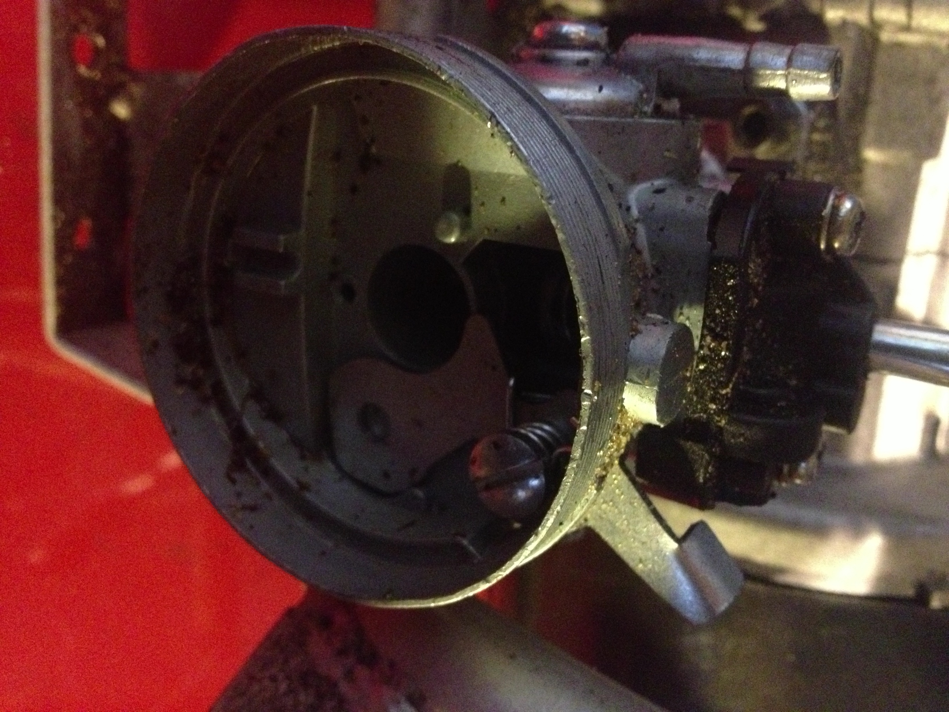

Think it's idling a bit low though as it cuts out after no throttle for a few seconds, if you keep on the throttle it's fine.

As for the idel , there is a little gold slotted spring on the carb with a spring on it, if you turn that in it will bring the idel up so it will keep running ThumbsUp
Nice one jamie will do it tomorrow

Do it wile its running though dec, as if you turn it up to much you will never get it started as it will just flood the carb
Noted! Also can be a bitch to start at times

Been taking little bits apart, cleaning up and refitting, carb was full of dirt!
