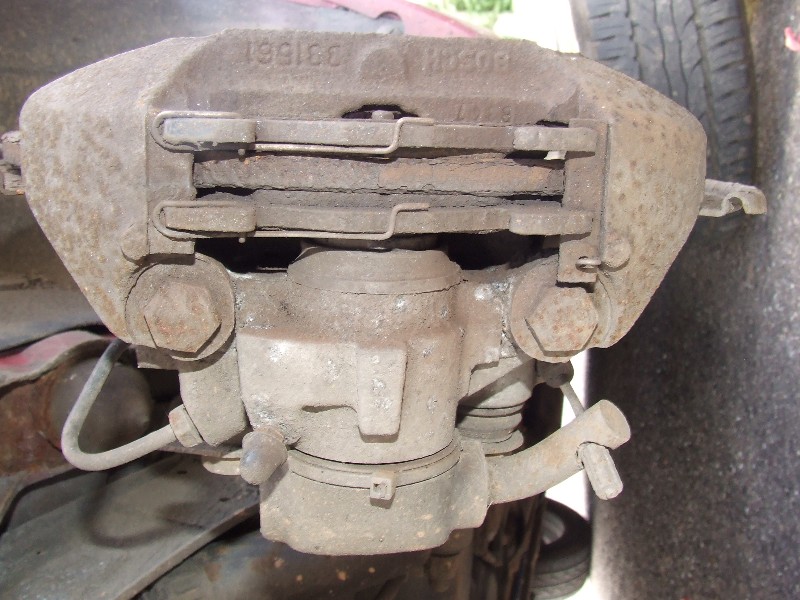

this may help
Again, tremendously helpful... Dodgy
Did you have the split pins in the back of the caliper mate? martyns car did this on the eurotrip as he didnt have them.. The pad was sat at 90* to the calliper
was bodged with some speaker wire lol
Split pins in the back of the caliper...? Pics?
yeah sounds stupid but are you putting the split pin in the pad retainer on the bolt side and not on the other side? Cully has it right in the pic above if you dont quite get what im saying. if its the other way round and the split pin is in the opposite side to the bolt, it can still slide out.

Wouldn't be missing the L shaped thingy that sits between the caliper and both pads at the bottom. Usually have to tap it in?
The pads come out fairly easy without that there

If you put the retainer in the wrong way around it WILL fall out.

Phil, that's part of the pad retaining kit.
Chris, i don't have pockets that work like yours. Wink
Other Phil, it was definitely round the right way lol.
If it was, they shouldn't have fallen out whistle

Oh and a picture of the pads and fixing kit fitted, for all you unbelievers Wink :
