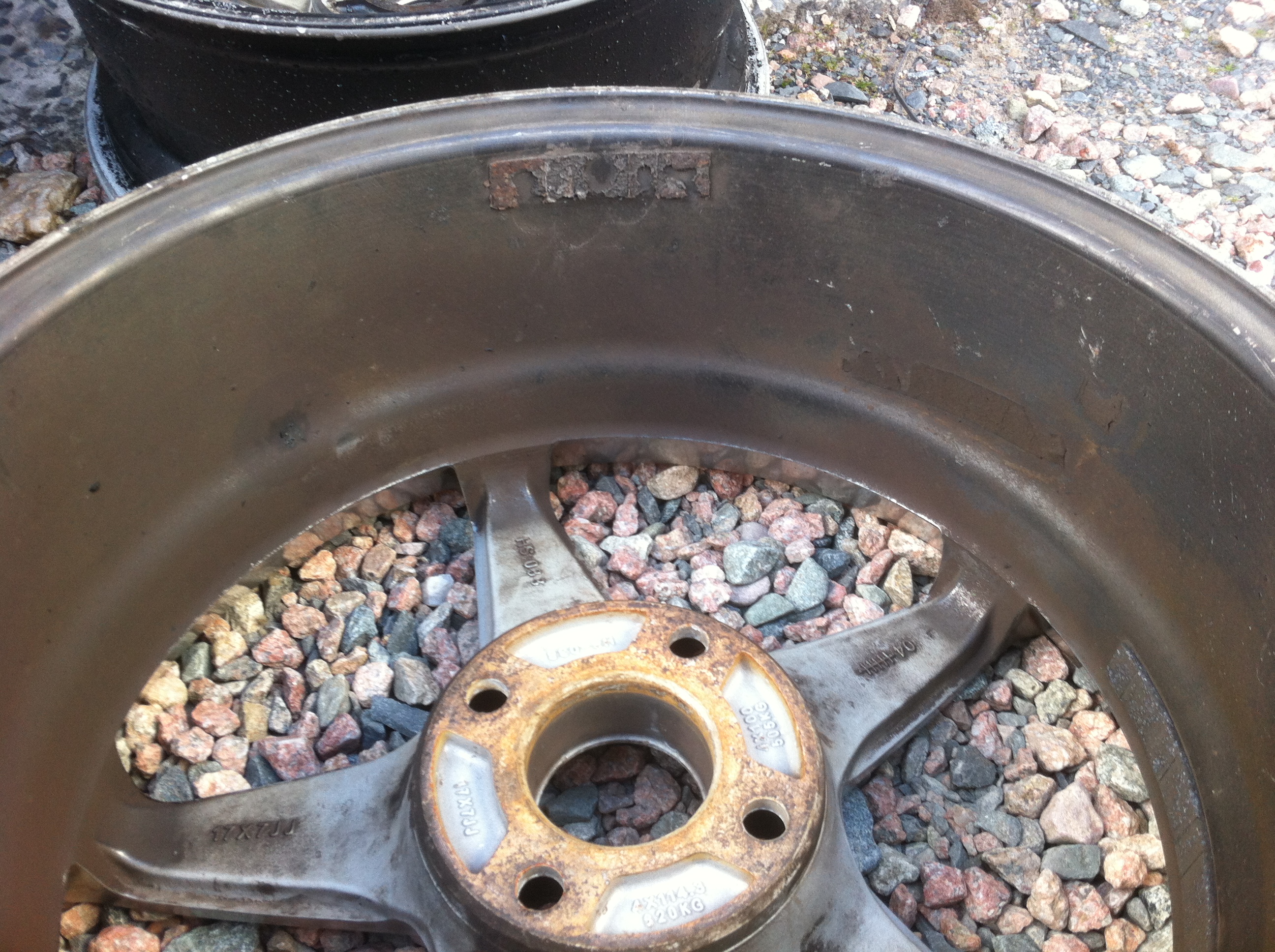

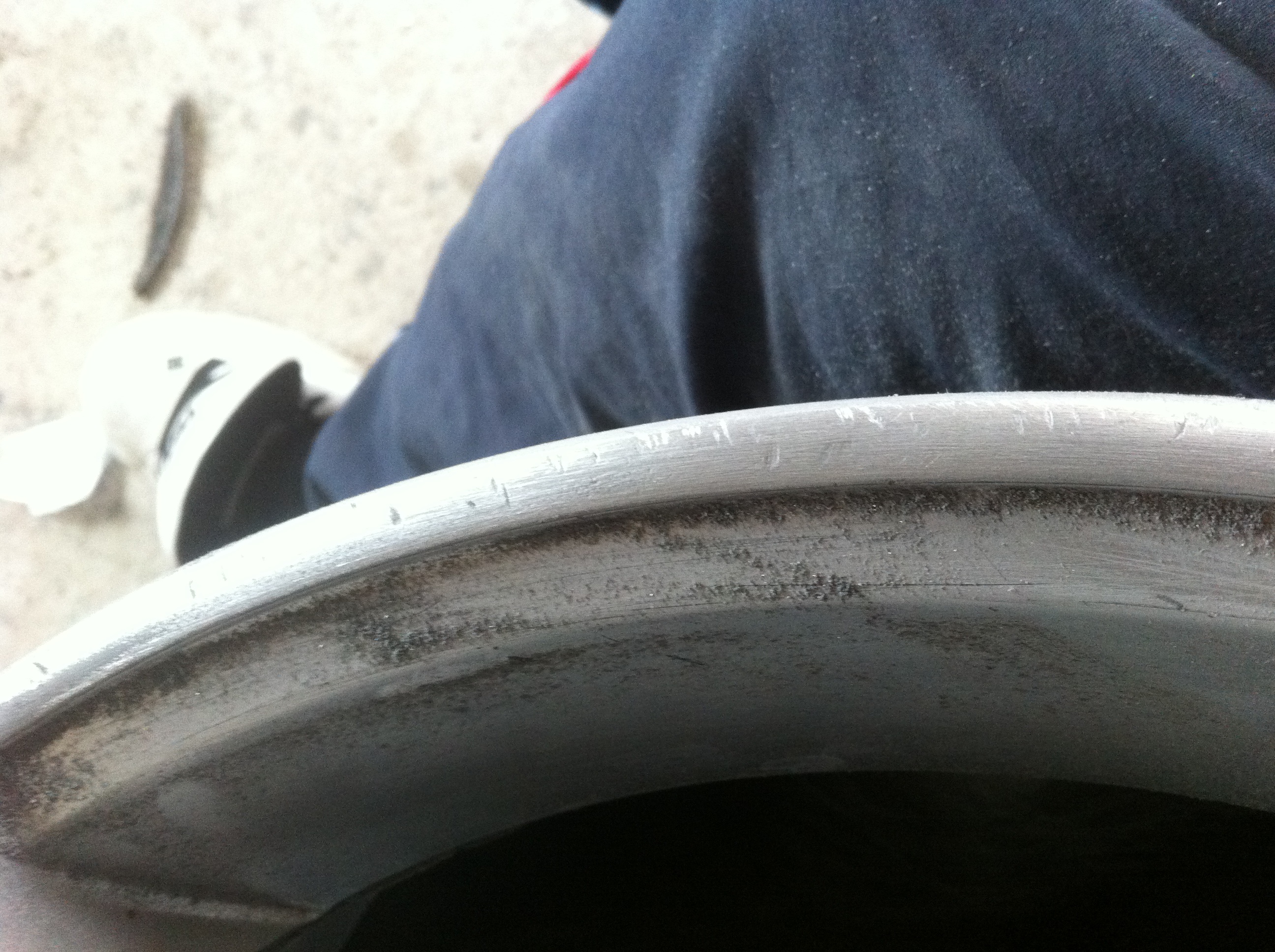

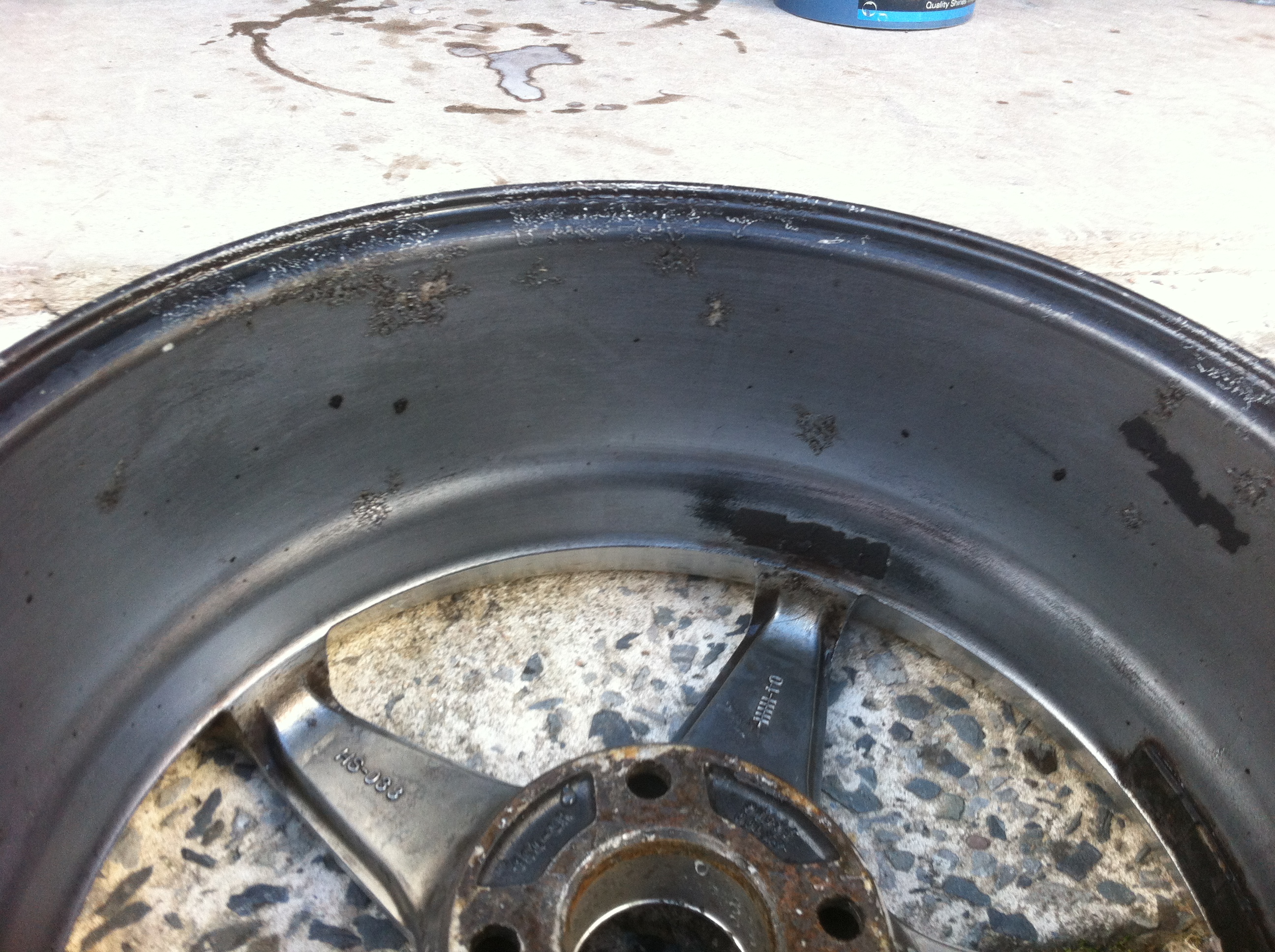

Bought these alloys for £50, no tyres. Need a bit of work though before I'll put the money into putting tyres onto them. Going to sand them back, use isopon on the dinges and scuffs, high build primer, then spray them silver and then clear coat them. Should look sweet when finished.
First picture shows all four of them, then second and third shows the before and after of me cleaning all the brake dust and guff off them.

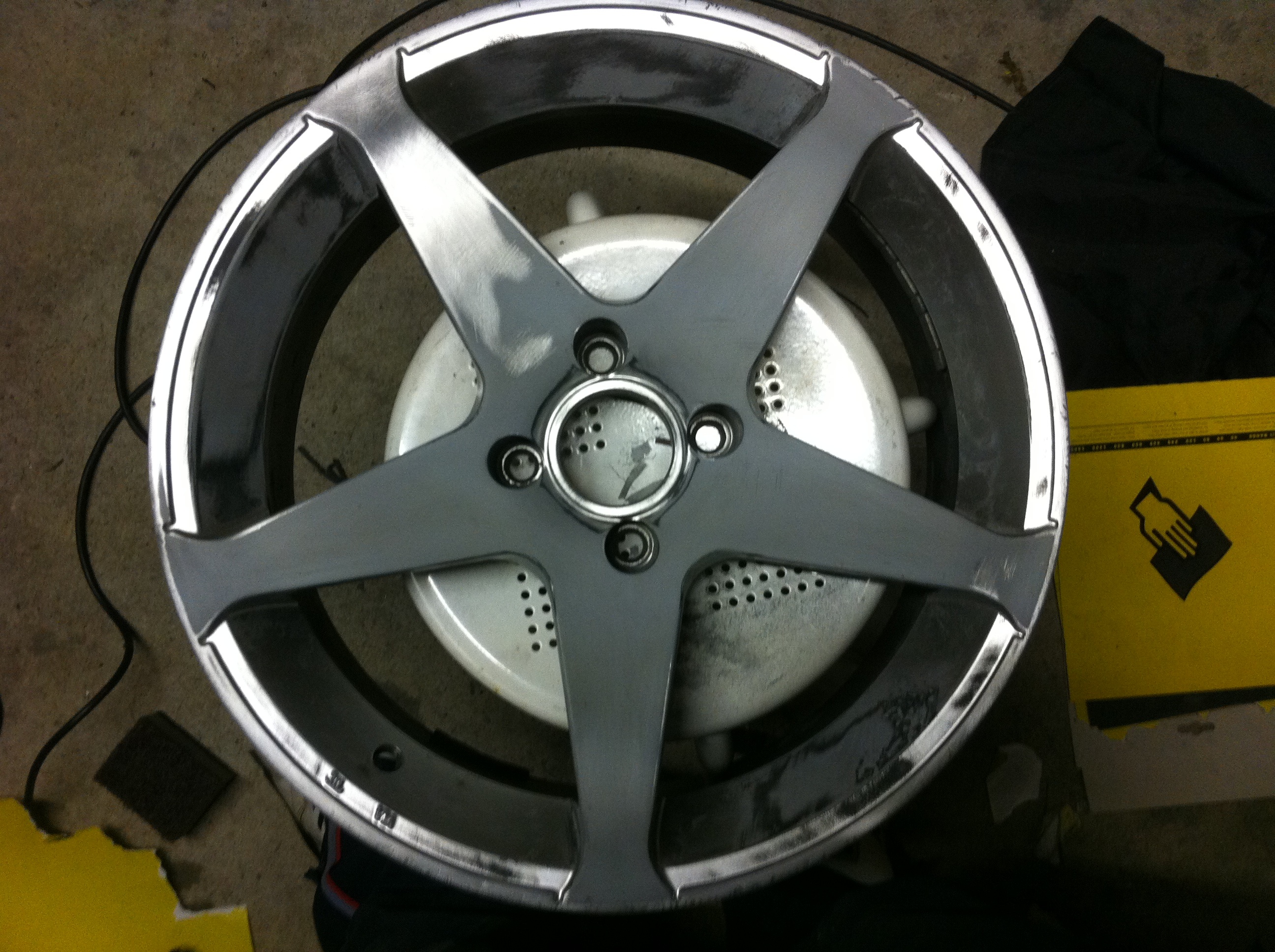

So far I've got one wheel mostly sanded off, don't have time to do them flat out cus of exams coming up, but I'm in no real rush to get them done. I've got a bit more off it than the picture added, just haven't got round to taking a photo of it.
Some shots of the work I did today, whoever owned the alloys before loved kerbs!
Before:
After:
